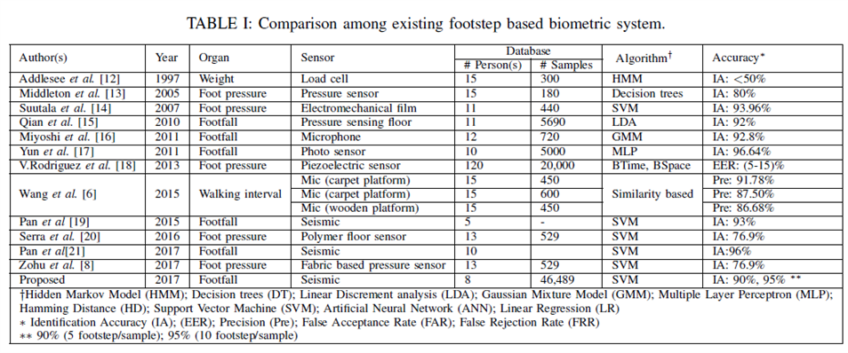

I've been researching the topic and I found an interesting article: Person Identification using Seismic Signals generated from Footfalls .  This is the pre-publication article as I don't have access to the published article.  It has some interesting and hopefully relevant information.  There is a chart comparing performance of different detection systems up to the time of publication (2018).
I think that the response of the vibration sensor will be equivalent to a seismic sensor although I think the seismic sensor (geophone) may have more sensitivity.  The two parameters that I want to extract from the published data are sample size and sampling frequency.  I'll also need to investigate machine learning algorithms/models later.  The algorithm used with the seismic sensors is the Support Vector Machine (SVM).
I'll discuss the data processing in a future post, but the jump up for now is that reasonable accuracy was achieved using a 5-10 footstep sample and an 8 KHz sampling rate.

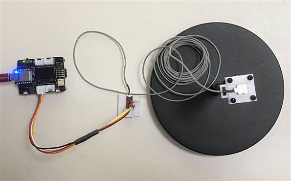

I've recently been using a couple of sensor platforms from Seed Studio that would satisfy the all requirements.
The first is the Xiao Expansion board which is shown below.  It has a SAMD21 MCU and a 128x64 OLED display.  I wrote a blog post about it Seeeduino XIAO Expansion board .

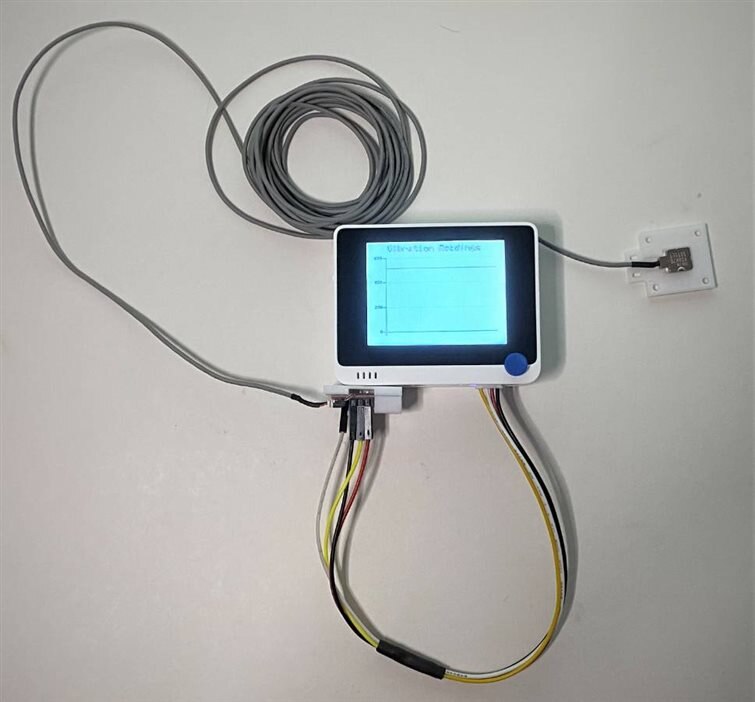

The second platform is the Wio Terminal.  It has a SAMD51 MCU and a 320x240 LCD display.  I used it for my Sensors project Wio Terminal Sensor Fusion - Introduction .  In the end I decided to use the Wio Terminal because in addition to a more capable MCU, it also has WiFi and BLE communications capability.
Wio Terminal
You'll notice that I'm no longer using the microphone stand as that caused too much damping of the signal amplitude.  I'll need to experiment with different techniques of directly attaching the sensor to the floor to get the best sensor response..
