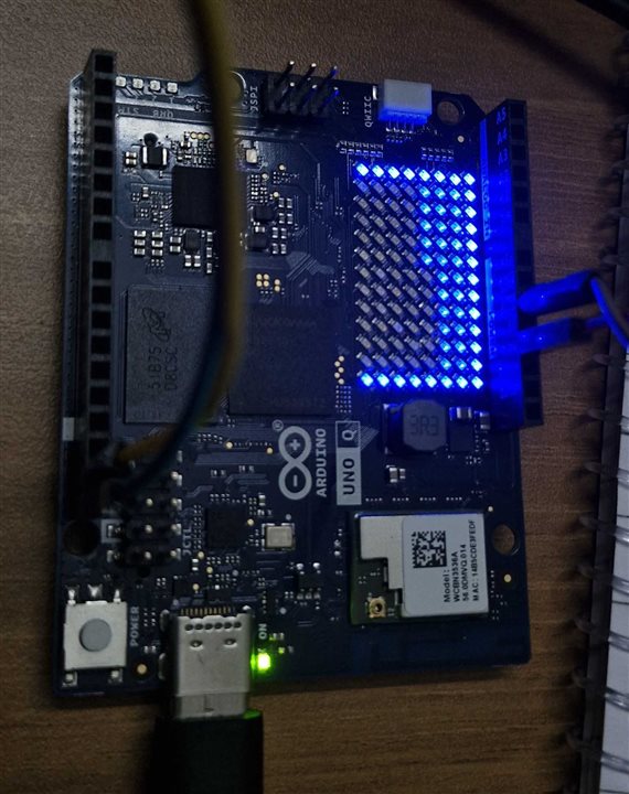

Displaying Vehicle Tilt angle on the LED Matrix
To better demonstrate the real-time capabilities of the MPU6500 IMU, I also developed a simple yet intuitive electronic water level indicator using the Arduino UNO Q's onboard LED matrix.
The animation continuously estimates the board's tilt angle from the IMU data and represents it as a moving water level. As the board is tilted, the "water" naturally flows towards the lower side of the display, closely mimicking the behaviour of a physical spirit level.
Although this feature is not directly related to the incident detection algorithm, it serves as an excellent visual demonstration of the IMU's responsiveness and the Arduino UNO Q's onboard LED matrix capabilities. It also provides an easy way to verify that the sensor orientation and tilt calculations are functioning correctly in real time.
This small demonstration showcases how sensor data can be transformed into an intuitive and interactive visualization, making the system easier to understand and more engaging during live demonstrations.
