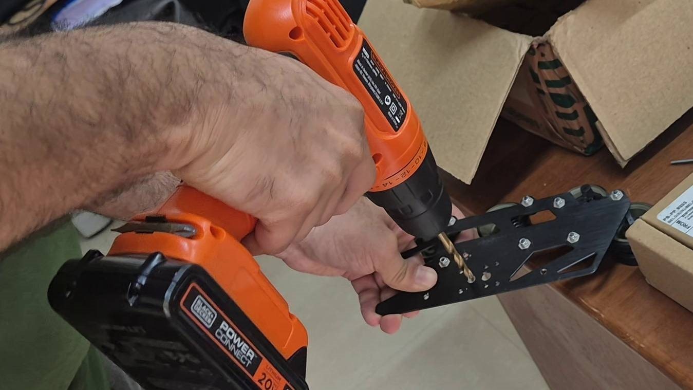

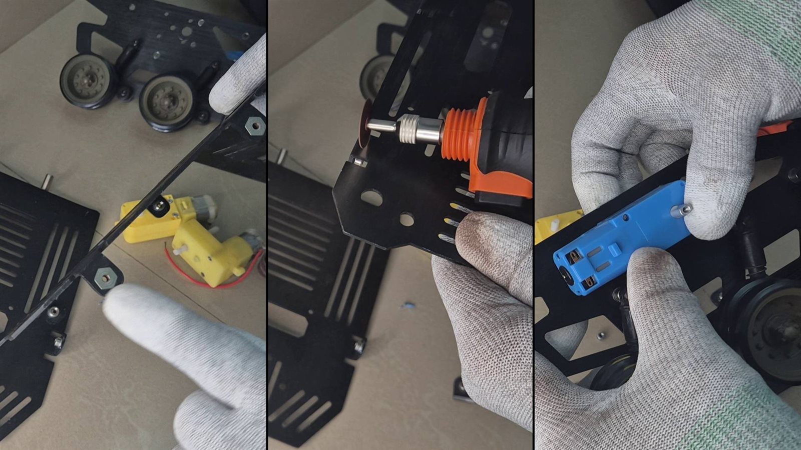

In the last post I mentioned that the Devastator Chassis motors were burnt out and I had ordered a All Gear Motors, I received my motors went ahead and installed the replacement all-metal BO motor and found two problems - one I'd anticipated, one I hadn't. The original Yellow BO motors were L-shaped; the replacement is straight. Before I even ordered it I had checked for collisions and found that a flange with a nut, which connects the roof of the platform to the side, would be in the way. Fix for that is to cut the flange and replace it's functionality with a 3D printed bracket.
Modding the chassis
Below is a  video of me modding the Chassis. Watch it only if you love watching such logs. Its a bore for others.
The second problem was new: a little plastic stub that I think holds one of the gears in place looked mechanically identical to the original but wasn't quite. There was a minor location difference, Had to drill out the location hole to get it to fit.
Drilling locatr hole
Both motors installed, tracks back on, and I confirmed both spin the right way before moving on to electronics.

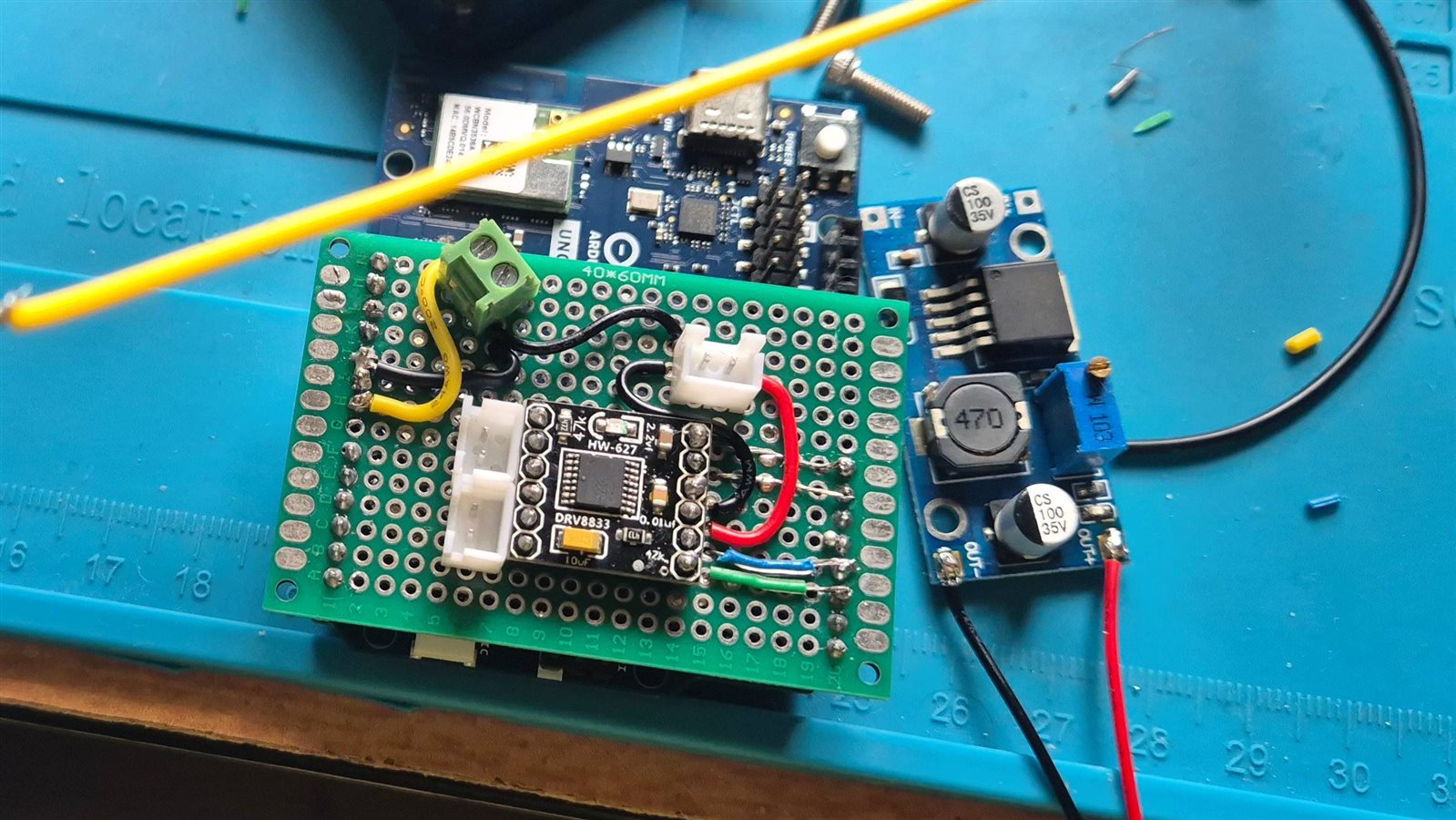

The Arduino UNO Q becomes the brain of the whole platform. The Qualcomm Dragonwing QRB2210 side runs Linux and acts as the overall controller - it'll receive positioning data from the Radxa Q6A about where the robot and the car actually are. The STM32U585 side handles the real time motor control loop through a DRV8833 driver.
As a mechatronics engineer I know that manufacturing differences between motors - different inertia and friction in the gear train, different friction in the track and wheel system - mean the two motors won't turn at exactly the same speed for the same commanded voltage. Sometimes you get lucky and the mismatch is tiny, but I didn't want to bet on luck, so I planned ahead for an encoder on each motor shaft, which is why I bought motors with a shaft on both ends in the first place. I'll be using a TLE5012B as a non-contact magnetic encoder for that - not wired up yet, more on that below. I am using TLE5012B just because I have surplus of it from another project, But there are more easier to procure and easier to interface encoders available.
For power, I'm using a 3500mAh 2S 7.4V Li-ION battery. The Arduino Q gets powered through its VIN pin (official power spec). During testing I found it needs a minimum of 6.7V to run reliably - the official docs say 7V, but that's presumably for full-load conditions. The motors are rated at 6V, so a buck converter in parallel brings that down to 5.9V before it reaches the motors via the DRV8833.

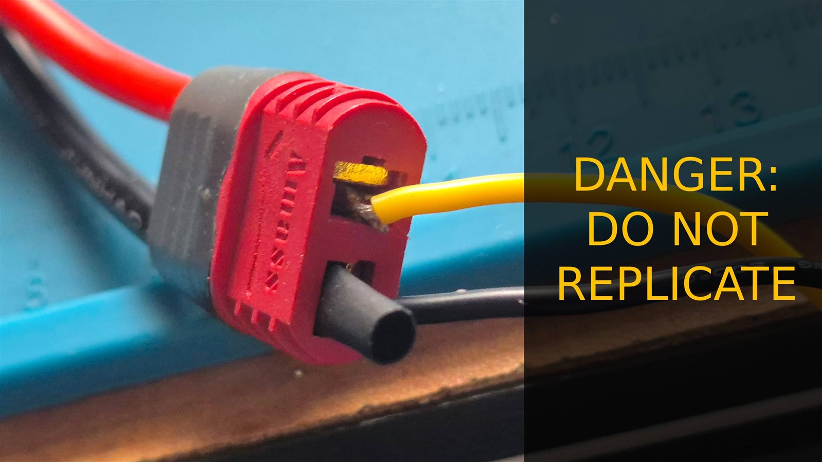

I made a custom perfboard PCB to house the DRV8833, a screw terminal for battery in, the motor leads, and a 2.54mm JST-XH connector carrying the 6V rail into the driver. The one snag: the battery uses a female T-Deans connector, and I didn't have a matching male one on hand. I had to do a makeshift, admittedly dangerous workaround to get power flowing for bench testing. I would not recommend anyone do what I did - that battery has a high discharge rate and is a genuine fire hazard if shorted. I've ordered the correct connector; whether it arrives before the submission deadline is a different question.
Custom Perfboard with the Buck Converter
Perfboard driver PCB - DRV8833, screw terminals, JST-XH power in
