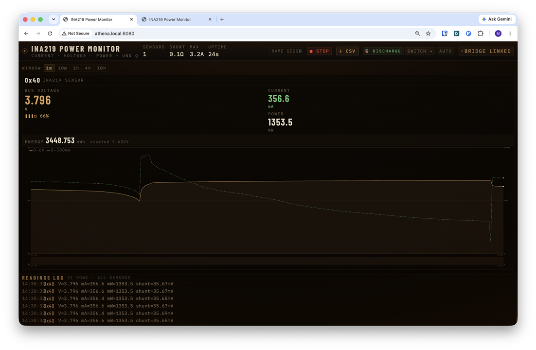

I setup a charging and discharging circuit controlled by the UNO Q, tracking using the INA219 power monitor and added a few relays to control cycling between charging (up to 4.2V and currnet draw down to 150mA) and discharging (down to 3.0V). The setup was far from pretty:
I hooked up a cheap AliExpress 18650 — label reads 2600 mAh 3.7 V 9.62 Wh
and got the following results:
Running a full charge then discharge at ~350 mA (10 Ω resistor):
Metric AliExpress “18650” Genuine 18650 (ref)
Claimed capacity 2,600 mAh (9.62 Wh) 2,000–3,600 mAh
Measured capacity 617 mAh 2,000–3,600 mAh
Claimed vs measured 24% of label ~100%
Discharge time to 3.0 V 107 min ~430 min
Avg discharge current ~347 mA —
Voltage sag (full cycle) 0.85 V over 617 mAh ~0.3 V
IR drop at switch-on 284 mV → ~0.81 Ω < 100 mΩ
Flat discharge plateau none — linear drop 3.5–3.7 V
CC charge current 460 mA —
Charge time (CC + CV to 200 mA) ~154 min —
Charge accepted ~604 mAh —
No flat discharge plateau, ~8× the internal resistance of a real cell, and only 24% of the claimed capacity — consistent with a re-wrapped 18350 cell (or a badly degraded pouch cell) inside an 18650 shell. The label’s 9.62 Wh figure is exactly 2,600 mAh × 3.7 V, confirming the capacity claim; neither figure is anywhere near what the cell actually delivers.

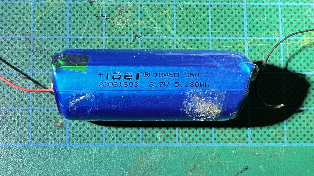

I hooked up a Vape Cell — label reads 18450 S50 3.7 V 5.18 Wh (~1,400 mAh claimed)
Metric Vape Cell (18450 S50) AliExpress “18650”
Claimed capacity ~1,400 mAh (5.18 Wh) 2,600 mAh (9.62 Wh)
Measured capacity ~480 mAh (projected¹) 617 mAh
Claimed vs measured ~35% of label 24% of label
Discharge time to 3.0 V ~92 min (est.) 107 min
Avg discharge current ~320 mA ~347 mA
Starting voltage under load 3.35 V 3.85 V
Voltage sag (full range) 0.35 V over ~480 mAh 0.85 V over 617 mAh
IR drop at switch-on 725 mV → ~2.2 Ω² 284 mV → ~0.81 Ω
Flat discharge plateau none — linear drop none
CC charge current ~460 mA ~460 mA
Charge time (CV to 200 mA) ~71 min (CV only) ~154 min (CC + CV)
CV taper rate k ≈ 0.011 /min k ≈ 0.012 /min
¹ Projected from 7 min of stable discharge data at −3.5 mV/min; actual result expected ~14:00–16:00 UTC. ² Instantaneous IR at load switch-on; CV slope method gives ~0.21 Ω — the large discrepancy reflects polarisation overpotential built up during the 71-min CV charge phase.
The 18450 is a real cell format (18 mm × 45 mm vs 65 mm for 18650) — a genuine 18450 typically delivers 650–1,100 mAh. At 1,400 mAh claimed, the label is optimistic. At ~480 mAh measured it sits at 35% of that claim — a pattern eerily similar to the 18650’s 24%.
