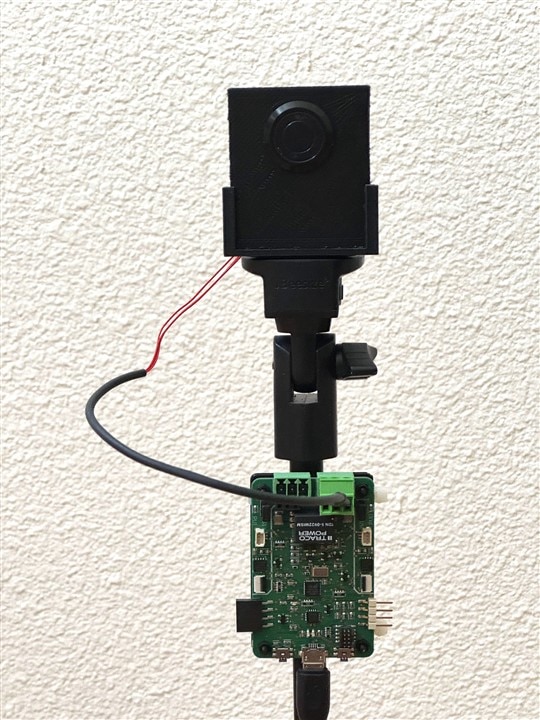

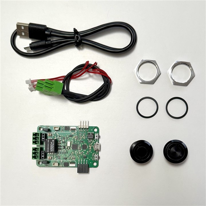

TDK USSM1.0 Plus-FS Demo Kit
The Demo Kit includes the following components:
  • TDK Demo Board
  • USB-A to micro-B cable
  • Two Ultrasonic Sensor Modules
  • Two sensor cables
  • Two gaskets and nuts

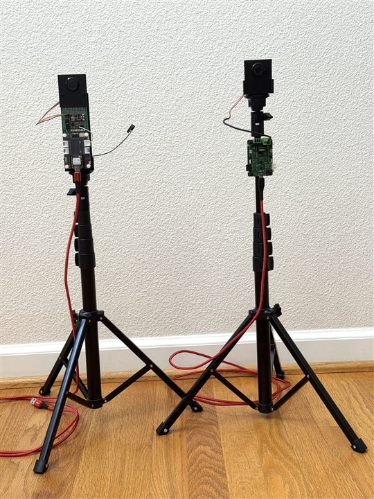

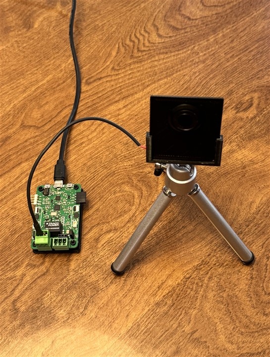

I printed a mounting plate and a tripod mount to use for sensor characterization.

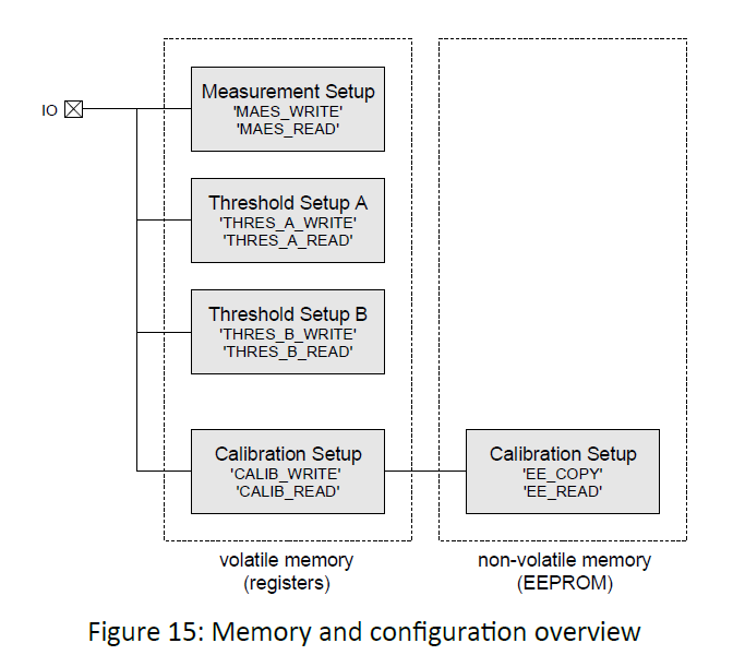

Configuration Registers
The USSM sensor internal registers contain the following information:
  • ID, EEPROM, Wakeup, Standby
  • Sensor calibration
  • Measurement configuration
  • Threshold setting for profiles A and B. C uses one of them
  • Status: measurement context and feedback, near-field flag
  • Temperature
These registers contain 93 values that are stored in volatile memory.
There is also non-volatile EEPROM memory that stores the factory calibration data and default setup values. After power-up the calibration data is copied into the volatile memory, and the default values are written to the Measurement Setup and Threshold Setup A/B registers.
The 4 registers "Measurement Setup", "Threshold Setup A", "Threshold Setup B" and "Calibration Setup" are used to configure the device.  During characterization I needed to determine the correct measurement modes and threshold values.  These values will need to be written to registers after power-up.
The Threshold Setups allow the configuration of 10 Threshold vs Time zones that set the detection sensitivity at different distances.  The default values lower the detection thresholds as distance increases. I only require a single setup, so I used Threshold A which provides the values for the measurement commands (e.g. SEND_A, ENV_SEND_A, etc.).  The default values are shown below:

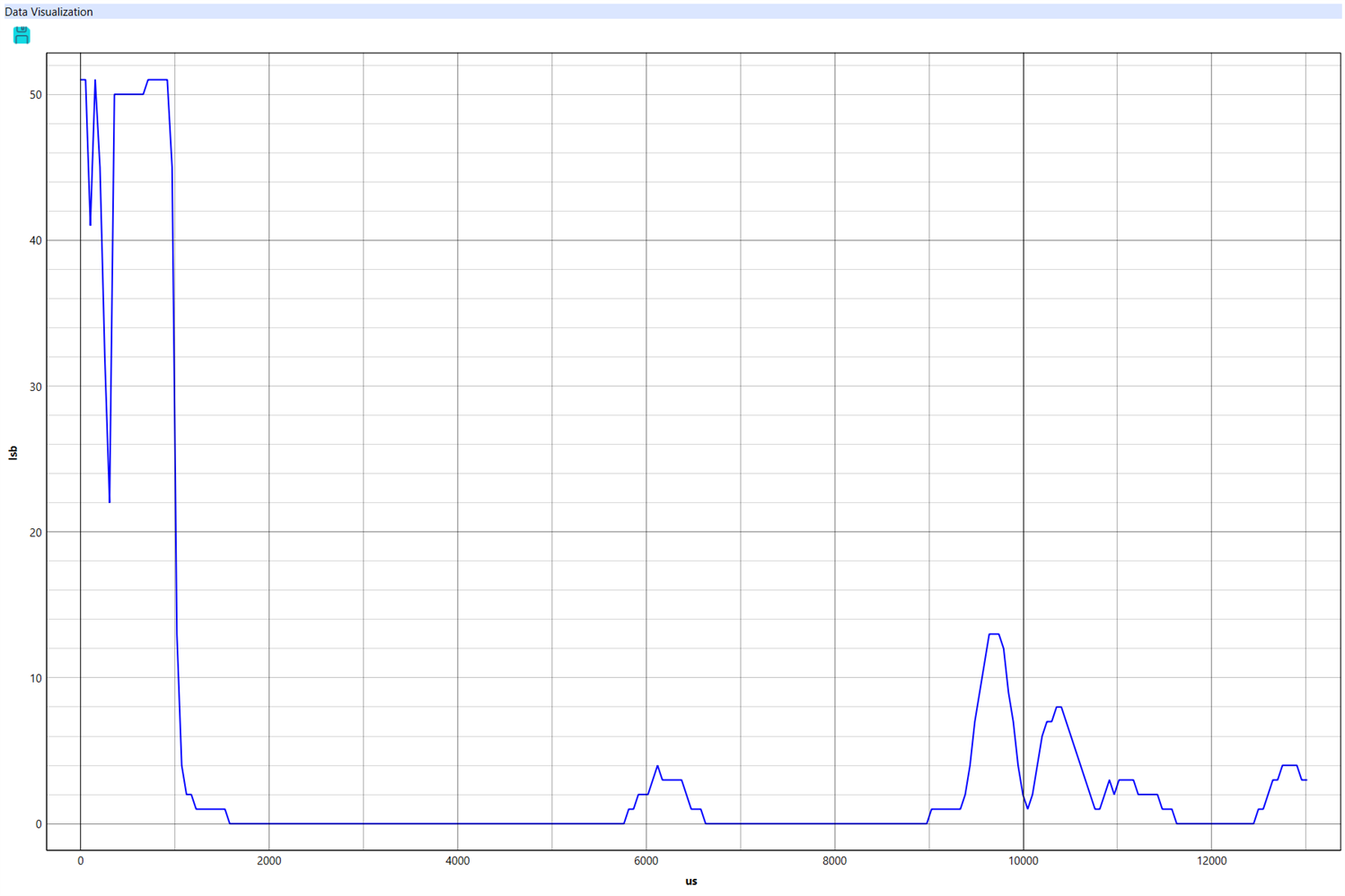

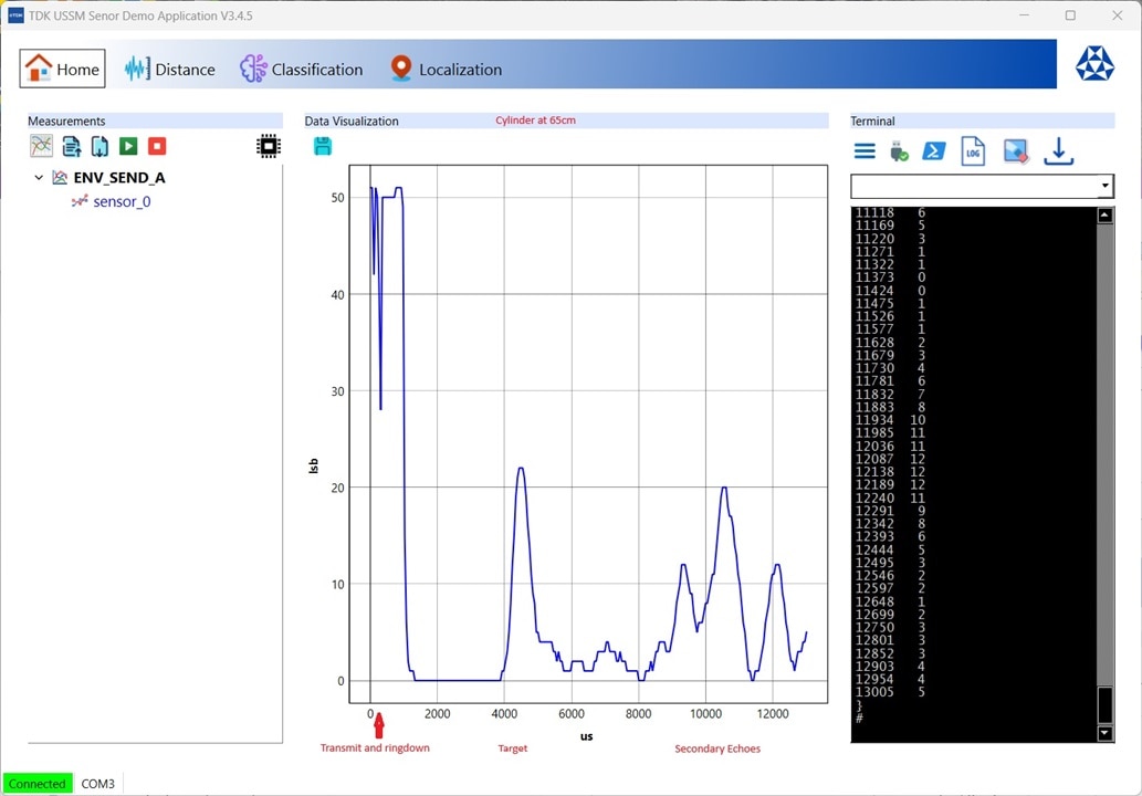

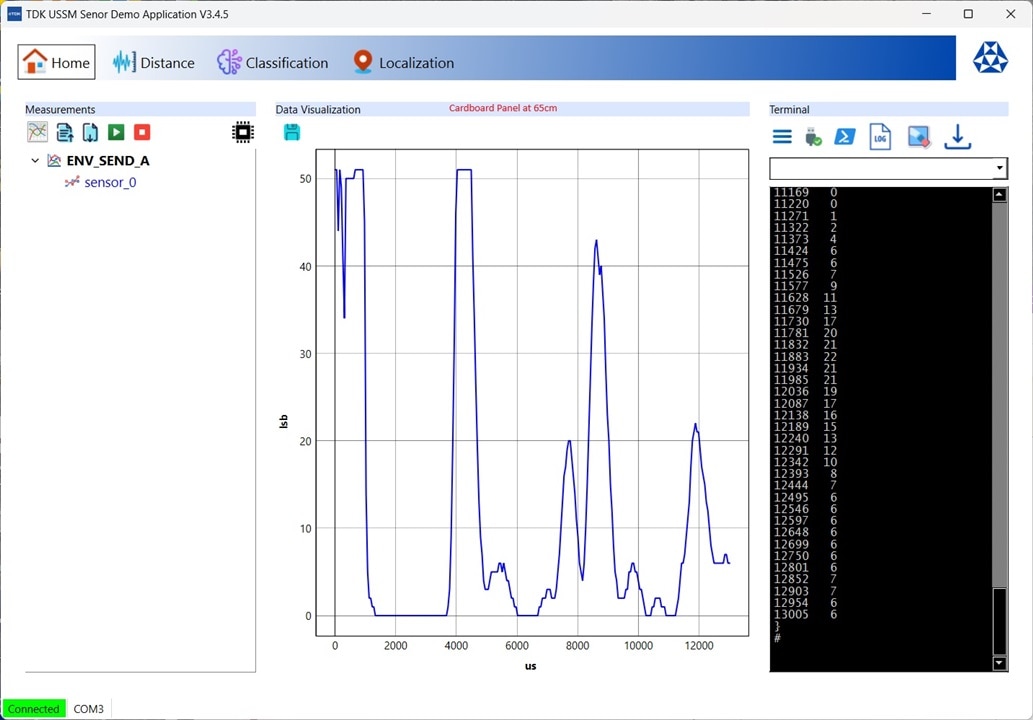

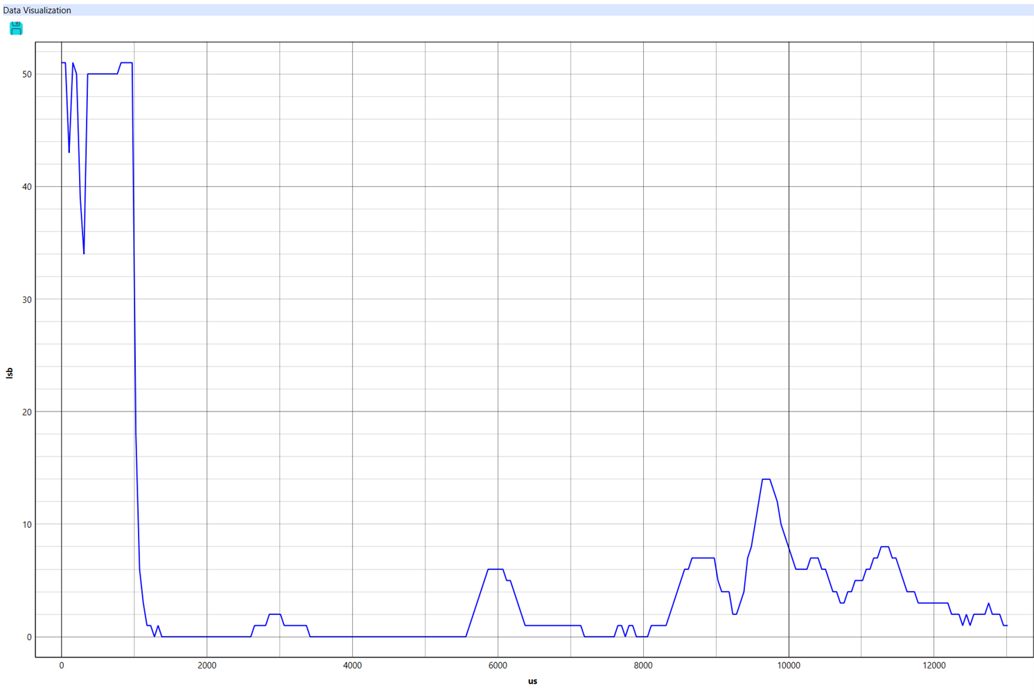

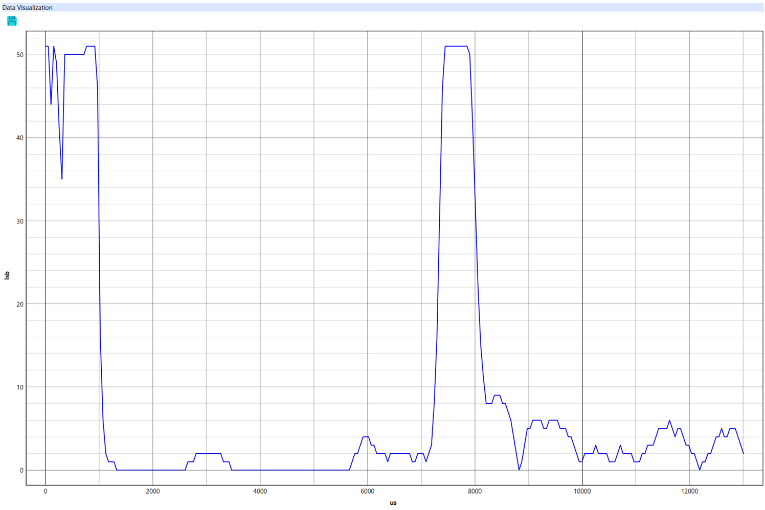

My initial tests with the default parameters showed that I was getting a fair amount of noise.  Here is a sample of a STREAMOUT measurement at a distance of 160cm and the noise is about 10%.
The sensor specification indicates that the reference target is a cylindrical pole, 75mm diameter, 1m height. That should provide a good primary reflection and scattering of any of the sound waves that do not strike perpendicular to the target. That should minimize the amplitude of multipath reflections.

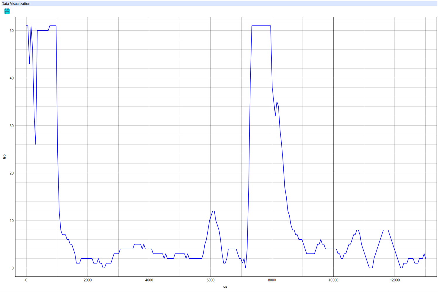

To test this out I used the Envelope measurement which provides an analog measurement of the amplitude and time of received echoes.
Here is a comparison of the Envelope measurement of a cylinder and a cardboard panel at 65cm. In the initial 1000us or so of both plots you see the initial transmission pulse and the ringdown period (time for the piezo element to settle). During this period the receiver is clipping. The target reflection occurs around 4000us and in the case of the cardboard panel the echo is strong enough to drive the receiver to clip while in the case of the cylinder it only has around 40% of that amplitude. The secondary multipath reflections are also significantly larger for the cardboard panel. The secondary reflections are also a lot earlier in time. This demonstrates that if the receiver gain and threshold are set for a faraway target that a near target measurement will suffer from significant multipath noise. Or if there is no near target it could mistake a multipath echo in its field of view (FOV) as the target. The shift in time of the secondary reflections shows the effect of the shape and size of the target surface relative to the location of other reflecting surfaces in the environment.

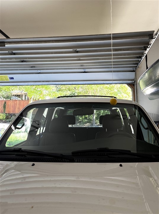

My project target is the front of a vehicle which is not solid or flat, so it is obvious that I needed to do my sensor characterization and parameter tuning in the garage with the vehicle. To that end, I built two tripod mounted measurement setups. The kit has two sensors, and I am doing single sensor measurements, so I have one sensor attached to the Demo Board so that I can leverage the capabilities of the Demo GUI software and I have the other sensor attached to the Xiao ESP32-S3 in my project configuration in order to test my application program.

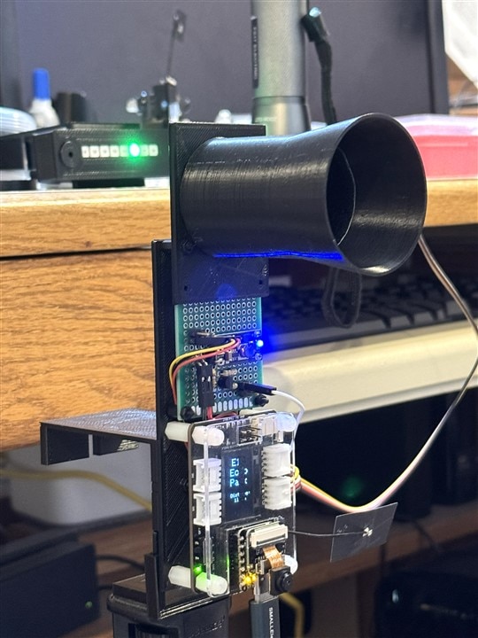

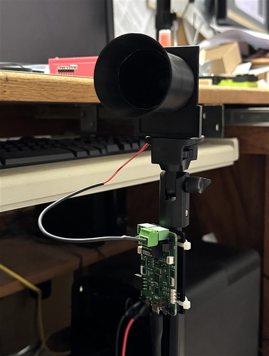

Sound Trumpet
My testing in the garage indicated that I was still getting a fair amount of multi-path noise, so I decided to try a sound tube to create a directional filter for the reflections received by the sensor (reducing the FOV).  Working from a design I saw on Thingiverse for a 40KHz sensor, I ended up trying a 40mm cylinder with a 30mm cone on top as it was quick to design and print.
I then printed a new mounting plate for the sensor and here is the new setup (I call it the sound trumpet in honor of Dave Beacon who originally suggested it):
Here are the results of a series of envelope plots that I ran to test the effect of the trumpet:
No trumpet, no target
No trumpet, square panel target at 120cm
Trumpet added, square panel target at 120cm
I'll admit that looking at the envelope data, I couldn't determine that I'd improved anything. It looks like the amplitudes all increased and shifted in time. The primary echo was wider.
What really surprised me were the Streamout readings. Without the tube it was measuring 90cm and with the tube it was measuring 50cm. I was using default thresholds, so I was probably catching the first secondary echo which had more amplitude with the trumpet added.

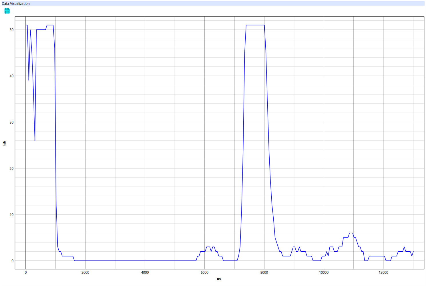

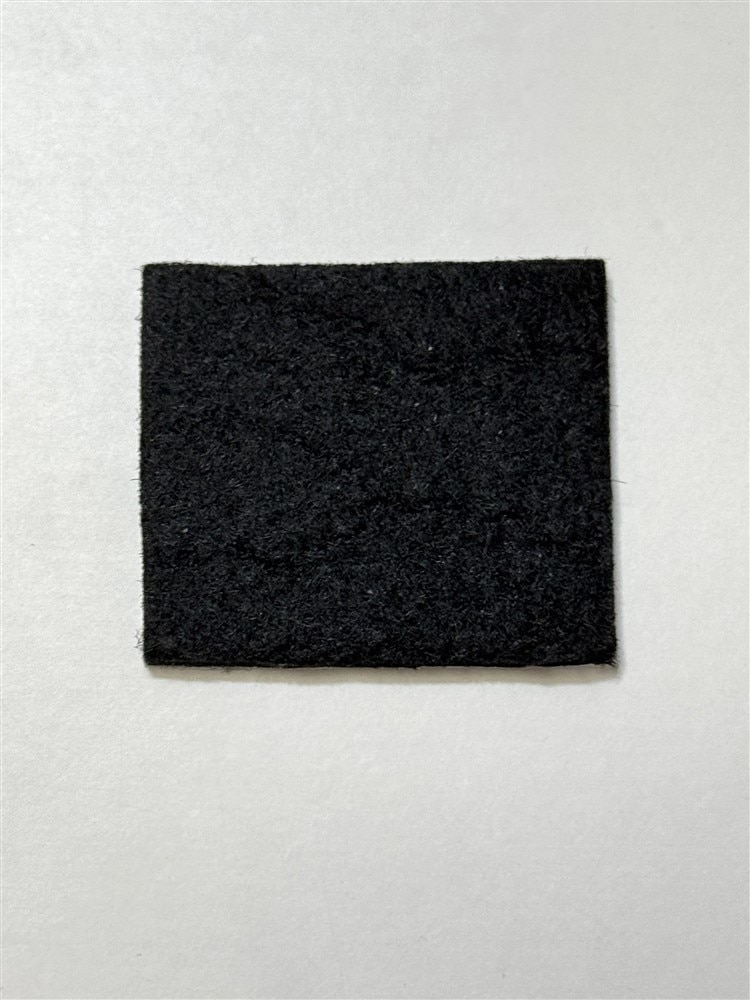

I had read that it might help to line the tube with sound absorbing material to prevent getting reflections from the tube walls caused by the transmit pulse. So, I tried lining the tube with 1/8" felt that is used for furniture pads.
Re-ran the envelope tests.
Trumpet with felt lining, no target
Trumpet with Felt Lining, square panel target at 120cm
I was somewhat surprised at the how well that worked.  The Streamout data now shows 128cm and it is extremely stable (quiet)
I, then modified the thresholds (increased them for near echoes) and Streamout showed 123cm and it was even more stable.
So, I was extremely happy with the results. I modified the project setup to use the trumpet and verified the results with additional tests in the garage.

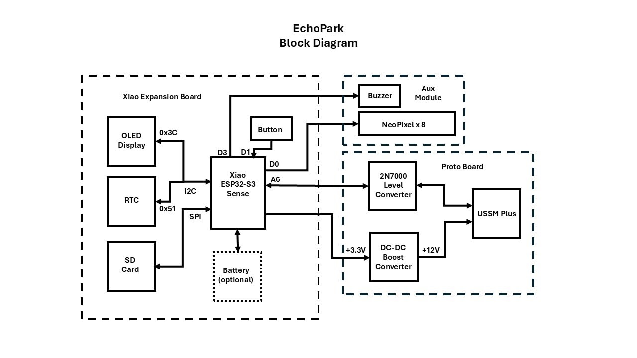

Project Description
The initial operation and characterization of the sensors was done using the USSM Demo board, but the actual project uses the sensor with a standalone MCU and supporting peripherals. The Seeed Xiao ESP32-S3 Sense is the MCU. It will be mounted on a Xiao Expansion board. This configuration provides a camera, OLED display, real-time clock (RTC), Grove interfaces for external IO (RGB LEDs, Buzzer, and USSM Data), and WiFi/BLE communication in the main module which includes the Xiao Expansion Board and the USSM sensor, DC-DC converter, and IO level converter mounted on a Proto Board.  I put the buzzer and NeoPixels in a separate module that is connected to the Xiao Expansion Board with a 50cm Grove cable.  This allows me to have the main module in proper position for the sensor to measure the distance to the front of the vehicle and have the camera with a good view of the license plate.  The buzzer and NeoPixels are mounted above to be visible and audible to the vehicle driver.

Functional Description
  • Parking - NeoPixel Display indicates range from >250cm to >75cm in 25cm steps
  • Park position- NeoPixel Display flashes all pixels red and buzzer beeps when <=75cm
  • Parked - NeoPixel Display and Buzzer turn off after 4 seconds <=75cm
  • License Plate Recognition - after Parked the camera captures the vehicle image and posts request to Gemini for plate data
  • MQTT - Parked Status and LPR data published
  • Node-Red Dashboard - displays camera image, Parked Status and LPR data and Time

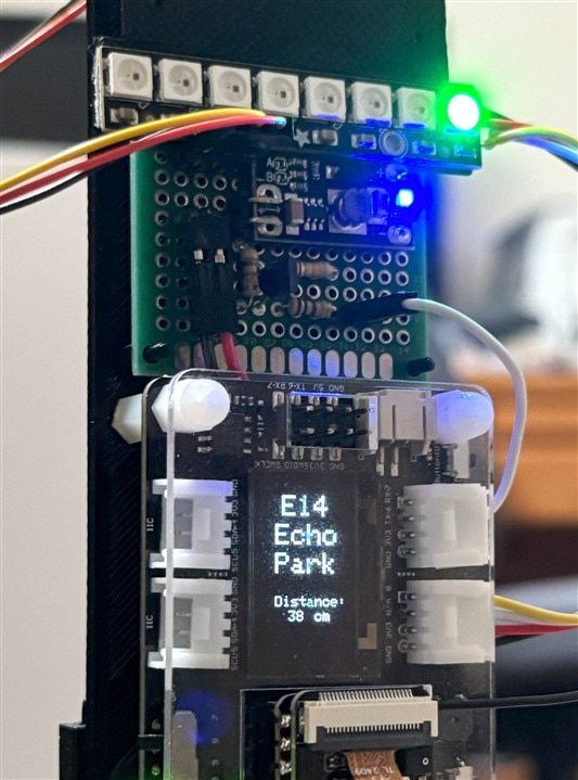

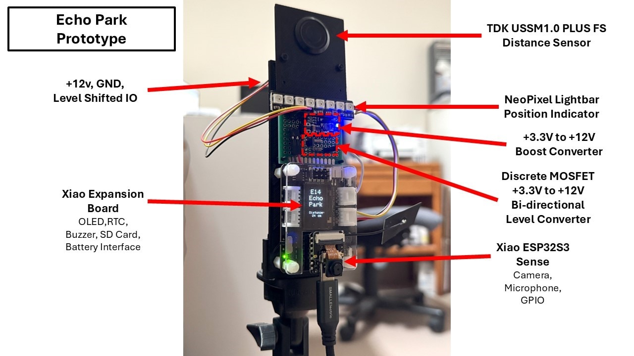

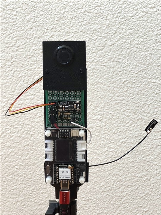

Prototype Hardware
Original Version
The original version of the prototype hardware is shown below.

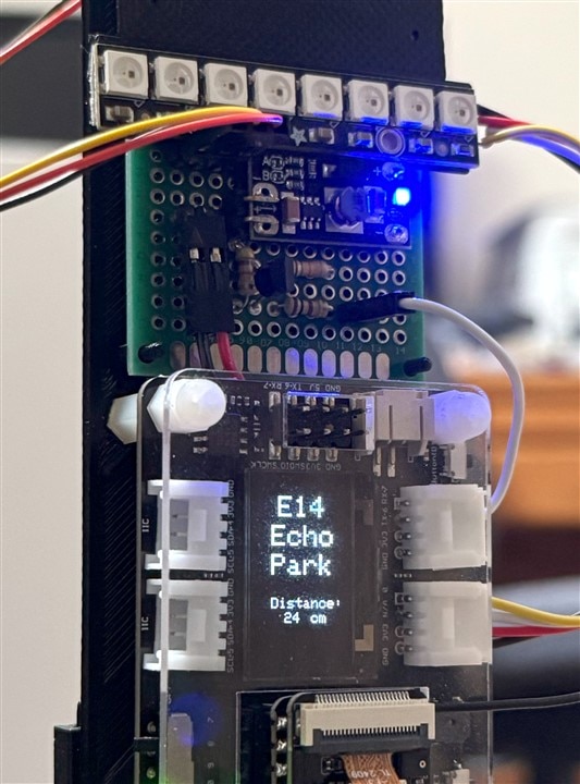

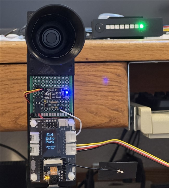

Final Version
And here is the final version with the following changes:
  • The passive buzzer (driven with PWM) on the Expansion board wasn't loud enough to be heard, so I replaced it with an external active buzzer.
  • The buzzer and NeoPixels are now in a separate module.
  • A sound trumpet with felt lining has been added to reduce the multi-path reflections received by the USSM sensor.

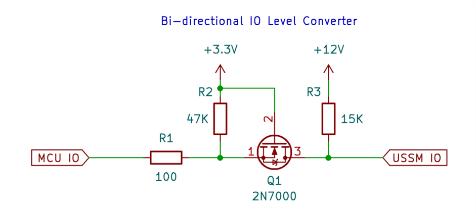

IO Level Converter

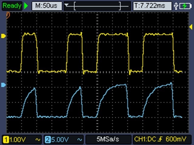

The only custom circuit that was required for the project was the bi-directional level converter to translate the levels between the ESP32S3 (+3.3V) and the USSM Sensor (+12V).  Since this is a single IO pin interface, I chose to build the circuit from discrete components.
The circuit has been functioning reliably, but I learned that the +12V pullup resistor value which I got from the documentation expected an additional 10K resistor in parallel in the sensor cable.  As part of the project cleanup I decided to look at the signals on the scope.
Here is a scope capture of SEND_A transaction with the timebase at 500us/div.  The top trace is the +3.3V side and the bottom trace is the +12V side.

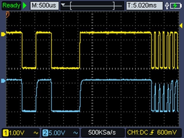

And a more zoomed in view of the data transitions at 50us/div.
It is clear that I should have a stiffer pullup, but I did not want to risk damaging the circuit so close to finishing the operational documentation for the challenge - so I am going to add a parallel 10K pullup later.
The signals are cleanly making switching thresholds, but I'm not sure how timing margin is available with the added rising edge delay.

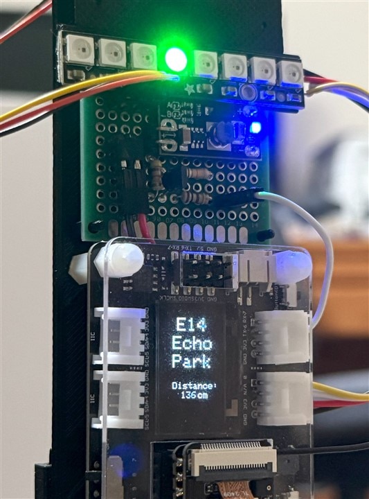

Distance Visual Feedback
I am using an 8 NeoPixel strip for visual distance feedback that covers my parking zone.  Each pixel represents a 25cm bucket that covers a range from 250cm to 75cm.  The leftmost pixel is the furthest range.
Below is my first implementation where my range was 200cm to 25cm.  Less than 25cm and all pixels were out.
My current implementation(final?) blinks all pixels red for about 4 seconds when the distance stays in the correct parked position (<75cm).  It also sounds the buzzer for that period.  I set a parkedFlag that is reset when the distance moves out of range.  I forgot to do that initially and the alarm went off whenever I walked in front of the sensor.  The correct implementation is shown in the final project video.

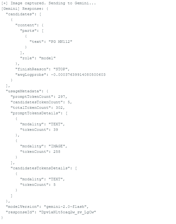

  • Send an HTTP request (with encoded image) to Gemini Vision API to detect and extract the license plate characters
  • Send JSON doc with timestamp and license plate data via MQTT to Node-Red for display
  • Send Status (Parked/Unparked) via MQTT to Node-Red for display

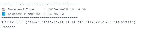

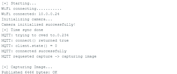

I wrote a standalone program to test the LPR (did not include the USSM Sensor).
Here is the Serial Monitor output showing the program flow:
  • WiFi connect
  • Camera initialization
  • Sync RTC
  • Connect MQTT
  • MQTT request image capture
  • Capture image
  • MQTT Publish Image
  • Send data to Gemini
  • Gemini response
  • Parsed data
  • MQTT Publish Time and PlateNumber

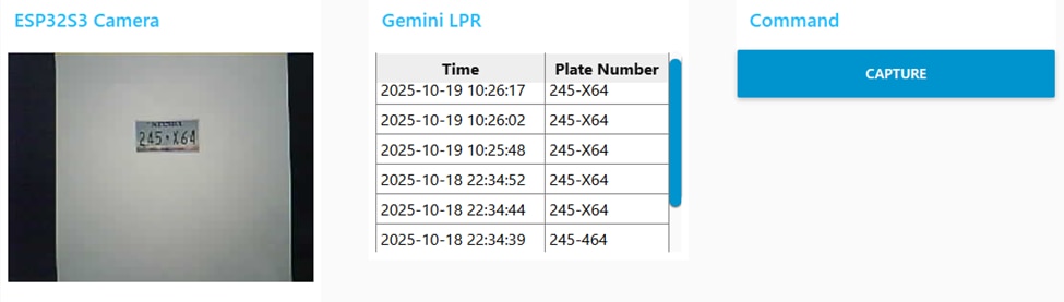

Node-Red Dashboard for LPR
There are 3 groups on the dashboard:
  • ESP32S3 Camera - displays the last captured image
  • Gemini LPR - displays up to the last 10 plate data responses from Gemini, latest is on top
  • Command - Capture button to send capture request

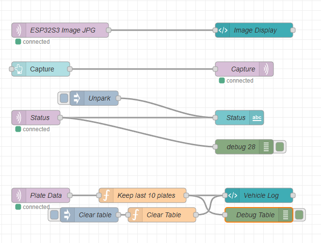

Project Node-Red Dashboard
This is the project dashboard updated to incorporate the parking status indicator.
Node-Red Flow Diagram
  • Receive Image Data and display on dashboard
  • Send Capture request when dashboard button is pushed
  • Receive Parking Status and display on dashboard
  • Receive Time and Plate Number and display on dashboard table
Short video showing the dashboard updating as the vehicle is parking.  When the parkedFlag is set, the Status will change from Unparked to Parked and the image will update.  After the Gemini response time the License Plate table will update.
Unfortunately, it's hard to see when the image updates because the previous image was essentially the same.  Since this is not a live image feed, I leave the last image captured on the dashboard.  It might make sense to update the image when the parkedFlag is reset (vehicle leaves).  I'll update that in the next version.

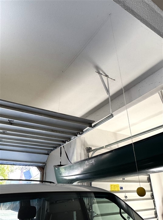

So, here's the almost final project shown working in my garage.  I say almost because I'm sure I'll be tweaking it for a while and I also want to make a sturdier enclosure for the sensor module.
The video shows the green NeoPixel moving to the right as the distance decreases and then all NeoPixels flashing red and the buzzer beeping when the parking position is reached.  The alarm stops after the vehicle is parked for 4-5 seconds.  The process resets when the vehicle pulls out.

    Serial.println("\n[+] Capturing Image...");
    camera_fb_t* fb = esp_camera_fb_get();
    if (!fb) {
        Serial.println("[-] Capture failed");
        return;
    const char* topic = "esp32s3/camera/image";
    // Use PubSubClient's binary publish:
    bool ok = client.publish(topic, fb->buf, fb->len);
    Serial.printf("Published %u bytes: %s\n", fb->len, ok ? "OK" : "FAIL");
    String base64Image = base64_encode(fb->buf, fb->len);
    esp_camera_fb_return(fb);
    Serial.println("[+] Image captured. Sending to Gemini...");
    HTTPClient http;
    String url = "https://generativelanguage.googleapis.com/v1beta/models/gemini-2.0-flash:generateContent?key=" + String(GEMINI_API_KEY);
    http.begin(url);
    http.addHeader("Content-Type", "application/json");
    String payload = "{\"contents\":[{\"parts\":[";
    payload += "{\"inline_data\":{\"mime_type\":\"image/jpeg\",\"data\":\"" + base64Image + "\"}},";
    payload += "{\"text\":\"Detect and extract the vehicle number plate text from this image. If a number plate is present, return only the plate number in plain text. If no plate is found, return 'No Plate'.\"}";
    payload += "]}]}";
    int httpCode = http.POST(payload);
    if (httpCode > 0) {
        String response = http.getString();
        Serial.println("[Gemini] Response: " + response);
        DynamicJsonDocument doc(4096);
        DeserializationError error = deserializeJson(doc, response);
        if (error) {
            Serial.println("[-] JSON Parse Error: " + String(error.c_str()));
            return;
        const char* aiText = doc["candidates"][0]["content"]["parts"][0]["text"];

        Serial.println("\n======= License Plate Detected =======");
        Serial.println("🕒 Date and Time     : " + dateTime);
        Serial.println("🔢 Licence Plate No. : " + plateNumber);
        Serial.println("======================================");

void setNeoPixel(int distance) {
  int pixelIndex = 0; // which pixel to light
  // Example thresholds: 25, 50, 75, 100, 125, 150, 175, 200
  if (distance > 250) pixelIndex = 8;
  else if (distance > 225) pixelIndex = 7;
  else if (distance > 200) pixelIndex = 6;
  else if (distance > 175) pixelIndex = 5;
  else if (distance > 150)  pixelIndex = 4;
  else if (distance > 125)  pixelIndex = 3;
  else if (distance > 100)  pixelIndex = 2;
  else if (distance > 75)  pixelIndex = 1;
  else pixelIndex = 0;
  strip.clear();
  if (pixelIndex != 0) {
    strip.setPixelColor(pixelIndex - 1, strip.Color(0, 255, 0)); // green
    strip.show();
    parkedFlag = false;
    parkedCount = 0;
  else
    // strip.show();
    alarmBeep(200);
    parkedCount++;

    if (parkedCount == 11) {
      Serial.println("Parked");
      bool ok = client.publish("esp32s3/status", "Parked");
      Serial.println(ok ? "Success" : "Failed");
      detectNumberPlate();
