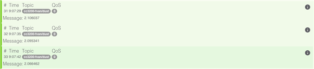

I was expecting this to return the same value (or at least close to it) as during my tests with the Arduino. Somewhere around 0.74V.
Unfortunately, I'm getting values reported around 2.0V! Why ?! image

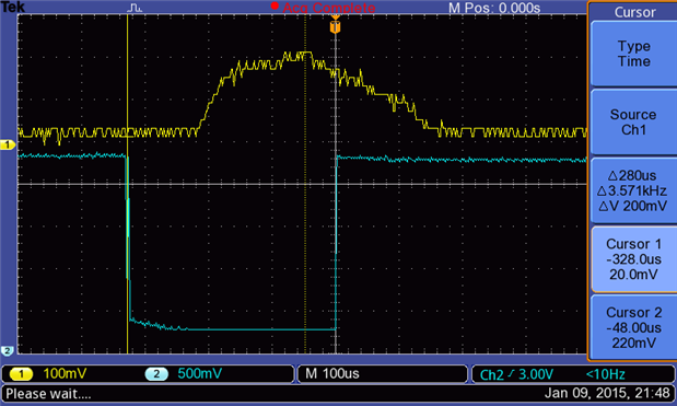

Using the TBS 1052B oscilloscope from the previous challenge, I tried to understand what was going on. With both probes, I tried to visualise the (divided) output of the dust sensor and the trigger of the IR LED.
This was the resulting snapshot:

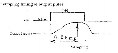

Using the cursors, I measured 0.280ms between the IR LED being turned on (fCursor 1 - falling edge on Ch2) and the dust sensor's (divided) analog output (Cursor 2 - Ch1).
As you can see, the snapshot matches the expected behaviour as documented in the sensor's datasheet rather well:
Cursor 2 on Ch1 reports an amplitude of 220mV, times 3 to compensate for the divider, that results in 660mv. So why is the analogRead() reporting 2.0V ??
