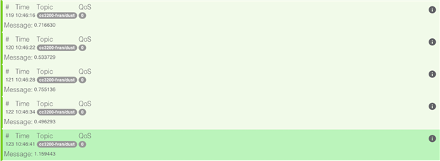

I was expecting this to return the same value (or at least close to it) as during my tests with the Arduino. Somewhere around 0.74V.
Unfortunately, I'm getting values reported around 2.0V! Why ?! image

Cursor 2 on Ch1 reports an amplitude of 220mV, times 3 to compensate for the divider, that results in 660mv. So why is the analogRead() reporting 2.0V ??
With the scope reporting a plausible value, I'm thinking the issue lies in the analogRead() itself. So I started searching for similar issues online.
I came across following issue where multiple analogRead() attempts must be made before a correct value is obtained (what's the deal with that?).
Not having better options at this stage, I decided to give it a try. But adding multiple analogRead() calls would surely affect the sampling timing.
To assess the impact, I report the microseconds using micros() right before and after the four dummy analogRead(), measuring how long it takes to execute.
This delay is then subtracted from the 0.280ms sampling delay.
The four dummy analogRead() introduce a delay of 0.040ms, so that's what I'll subtract from the 0.280ms delay.
The good news is that the readings after those changes are much closer to what I had measured with the Arduino, and are in line with what is measured with the scope.
The bad news is that the results fluctuate a lot more, losing the ability for proper monitoring of dust levels.
Smoke however, is still properly identifiable at 3.6V, as it results in the maximum output value of the sensor.

    I've not used Energia with the CC3200 so I've not checked the ADC code, but I had a look at the CC3200 datasheet and the ADC pins are for signals from 0 to 1.4V, but also expects the source impedance to be 100 ohms or less. This means that for most use-cases an opamp is essential. The dust sensor expects a load of 4.7k, but dividing it with a voltage divider increases the source impedance, so that will have a discrepancy with readings compared with the Arduino's ADC (which has a much higher input impedance, but is only 10-bit). I don't know if you have an opamp lying around, but if you do, it would be worth adding it.

    Hi! Yes the Arduino is a bit of an exception that it has a fairly high input impedance anyway. I think you'll get some really nice results though once the opamp is in place. After I saw your blog post I too ordered the sensor, but I've not had a chance to try it yet.
    A circuit as below would work (I think you'll have figured it out already anyway):
    Basically it makes sure the input is less than 1.4V (the sensor datasheet guarantees a minimum output voltage, but not a maximum, so the resistor ratio is conservative). The opamp could be something like MCP601, which can operate at 3.3V or 5V (i.e. the existing supplies you'll have).
