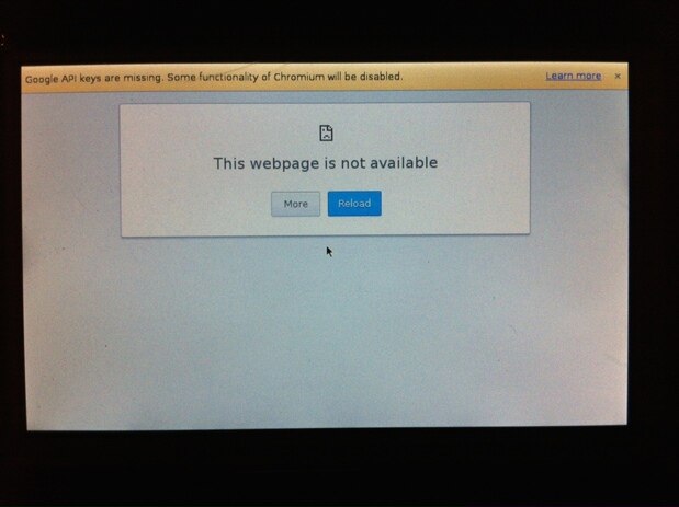

The result after having applied the changes and rebooting the system, is the following:
There are two issues with the above screenshot:
  • Chromium is started and attempting to open the openHAB GUI before openHAB is fully started
  • There is a warning message at the top regarding missing API keys
On the good side: Chromium is started in kiosk mode and trying to open the correct URL, meaning the command works.

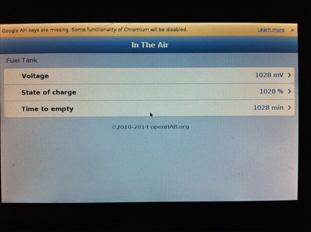

To solve the first issue, I chose the quick and dirty solution of adding a delay. Because other "custom" commands might be needed, I moved the delay and startup of Chromium to a separate script and called that script in the "autostart" instead.
I added a 2 minute sleep before starting Chromium, giving openHAB enough time to start properly.
debian@beaglebone:~$ sudo nano delayed-chromium.sh
#!/usr/bin/sh
sleep 120 && chromium --kiosk "http://localhost:9090/openhab.app?sitemap=intheair"
debian@beaglebone:~$ sudo chmod u+x delayed-chromium.sh
debian@beaglebone:~$ sudo nano /etc/xdg/lxsession/LXDE/autostart
@lxpanel --profile LXDE
@pcmanfm --desktop --profile LXDE
@sh /home/debian/delayed-chromium.sh
After rebooting, Chromium is started 2 minutes later as expected and the openHAB GUI loads properly. Ideally, I should check for openHAB's status until fully started and then launch Chromium.

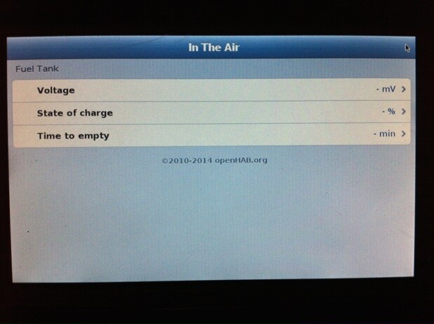

The annoying warning is finally gone:
Conclusion
After powering on the Beaglebone Black, the openHAB GUI will open automatically on the touch screen without user intervention. Hooray!
