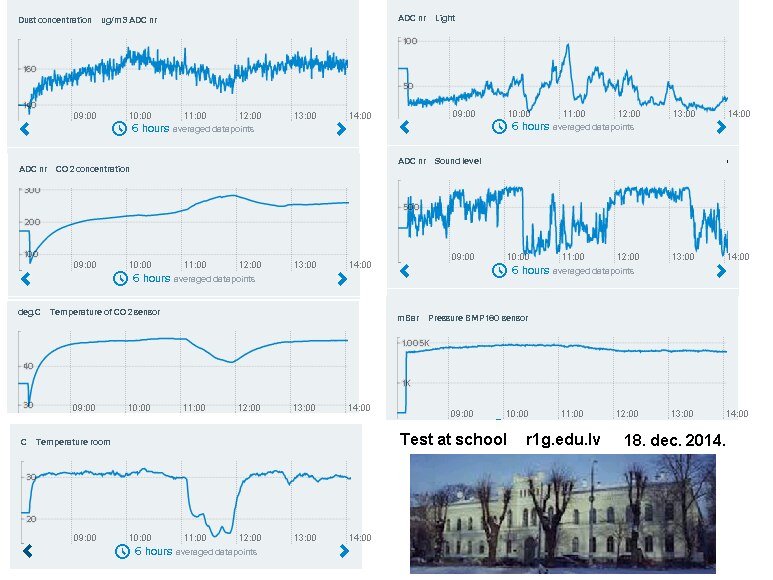

Tests at school class
I gave the sensor box to a student who took it to Riga 1st Gimnasium  to measure air quality in the class. Test at school was tried for 3 days and only the last day was successfull. First day there was no Wi-Fi connectivity. Second day GSM-USB Internet adapter was used to bring notebook to the Internet, but Processing script stopped working as there COM port settings had changed. Below is the picture of the sensor readings at school. Live: https://xively.com/feeds/1192364524
Measurement was started on Dec. 18 at 8 am. CO2 sensor needed 1-hour warm up.
CO2 levels changed dramatically during the middle of the day when window was open. But this change was mainly due to decreased temperature.
Note that plotted is not the CO2 concentration, but voltage in ADC units. This voltage decreases with increasing CO2.
One could see slightly elevated dust level, but not too much.
Box was placed on the window aisle near heaters and room temperature reading was elevated.
After the school day around 2:30 pm the student took the sensor and notebook home. So there are no values for the time when noone was in the class.
After the Christmas and New Year holidays we need to install Wi-Fi or GSM module into the air sensor box. So that it can be left operatig at school 24/7 without a PC. Minimum would be to add a SD/card with RTC.
RESULTS:
1) There were some interesting results analysing the sensor data, for example CO2 increase during every lesson and dust from floor sweeping after the classes.
2) A webcam would greatly simplify the analysis showing the number of people in the class and state of the windows,  but webcam is not legal to use without permission from authorities.
3) Wi-Fi at school was problematic to arrange as one needed to register MAC address by the webadmin. GSM module would be best to use.
4) At school students were not allowed to leave electronics running during the night. So background data could not be collected.
5) Electrochemical CO2 module needs too much warm-up time. NDIR CO2 sensor described in the following blogposts is more accurate and has only few minutes of warm up time.
