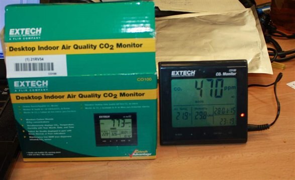

EXTECH INSTRUMENTS  CO100  METER, CO2, 9999PPM, 99.9%
197,71 €
http://de.farnell.com/extech-instruments/co100/meter-co2-9999ppm-99-9/dp/2081081?ost=co100&categoryId=700000005821
I will use this near-infrared non-dispersive type CO2 sensor to compare with electrochemical CO2 sensor module. NDIR sensor is callibrated against NIST traceable device, accuracy 75ppm or +-5%.
Good <800 ppm
Normal 800...1200 ppm
Bad >1200 ppm
First tests in the sleeping room at home showed that air was OK bad during the night 700...800ppm. In a confined space like a toilet CO2  content rised to 2000 ppm within 5 minutes. I will test the device during the lecture with ca 20 people this week.
This model has an empty battery compartment and USB hole is not populated. I will try to see if there is some place inside where analog voltage could be accessed with MSP430 or CC3200 and sent to IoT over Wi-Fi.
