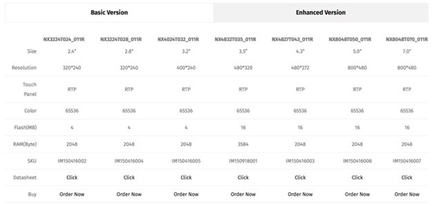

They are available in all sizes and capabilities image See the available option below image
I got the display from banggood.com HERE and it took about 20 Days to get delivered.
Key Benefits & Disadvantages
  • Offloads the entire Display programming, Image Conversion, Image Array storage, etc .. .. to the Nextion Display.
  • Easy to design GUI
  • Easy interface with UART, instead of I2C or SPI.
  • Inbuilt Graphics memory
  • Inbuilt 4-Wire Resistive touch and interface
  • Event based Programming
  • Inbuilt RTC & EPROM
  • 8 GPIO’s can offload Button Navigation Interface
  • And Many More.. .. ..
  • Power Hungry (Giving power to one more micro controller)
  • Only way to upload new GUI design is either Serial (Slow) or Via SD Card (repetitive)
  • Each time there is a rev in the GUI, The on board flash of the MCU has to be reprogrammed
  • Nextion Editor IDE Works only on Windows
That being said, lets look at the available options below ( Source : Click Here )

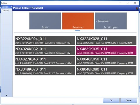

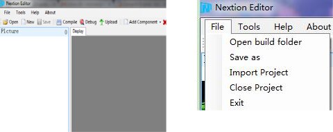

1.     Well first Lets get a Nextion Display (check the link below)
2.      Lets get the Nextion Editor (again Check the link below)
3.     Select your Display
4.     Make your design using GUI editor, Compile and copy the *.tft file from nextion built folder
5.     Copy the *.tft into SD card, insert the SD card into the Display and power it on. Let it uploads the sketch onto the display’s memory and remove the SD card. Re-Power the display and Enjoy.

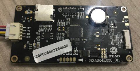

Project implementation
Here is a video of my implementation, any reviews and comments would be appreciated.
Way forward
AS of now interface with the MCU is a huge ISSUE !!
Updates:-
30 Sep 17 UART Interrupt not working
01 Oct 17 Button Interrupt works
08 Oct 17 All Interrupts somehow stopped Working. image :’(
08 Oct 17 Since.. I HATE MBED
As the Rx Interrupt is not working and now even the TX button Interrupt is not working it is useless working with mbed platform .
Trying to download STM32 Openware to try my luck there . image
