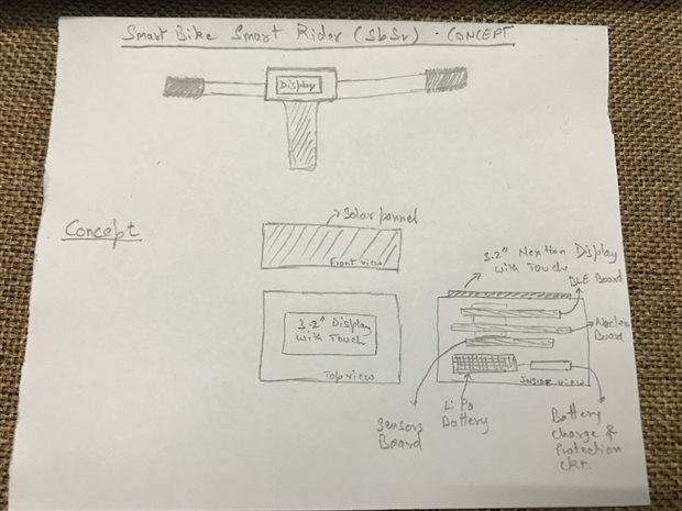

Please refer to the image below for concept of the device.

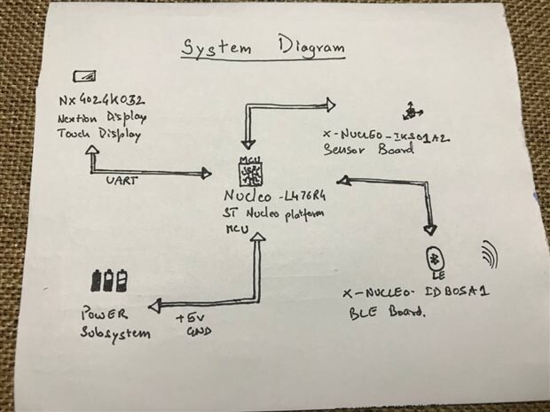

Please refer to the image below for Overall System diagram.
