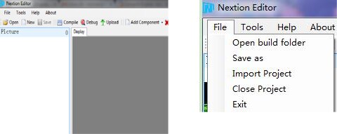

Getting Started
OK, So getting started with the display is as simple as  1, 2, 3, 4.. 5
and
Wooooo oo ooooo, Yaaaayyyyyyyy.   !!! !!! !!! !!!!
1.     Well first Lets get a Nextion Display (check the link below)
2.      Lets get the Nextion Editor (again Check the link below)
3.     Select your Display
4.     Make your design using GUI editor, Compile and copy the *.tft file from nextion built folder
5.     Copy the *.tft into SD card, insert the SD card into the Display and power it on. Let it uploads the sketch onto the display’s memory and remove the SD card. Re-Power the display and Enjoy.
