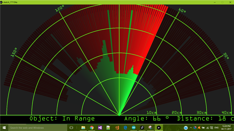

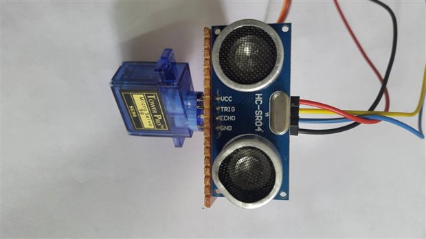

Ultrasonic sensor to measure the speed
     An ultrasonic sensor is used here to determine the distance of the moving/ static traffic objects from the vehicle. Using change in distance and time, the speed alteration required in order to avoid a collision can be calculated. The formula to do this would be,
     The setup has Ultrasonic sensor [Range: 0 to ~75cm] mounted on a Servo motor which will move from 0 to 180 degrees. This will capture a semicircle RADAR like output as shown below [Processing IDE has been used to display output as graph]. Using this the speed with which the driver/ rider should proceed will be calculated.
                   Processing IDE showing RADAR like output with input from Ultrasonic sensor
                              Ultrasonic sensor mounted on Servomotor
