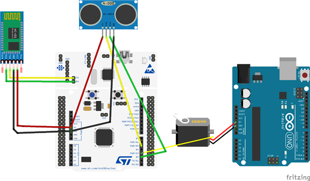

Circuit Diagram
     Below is the circuit diagram of the entire hardware in my trafficpredictor project[designed using Fritzing I have also mentioned the pin in the different modules adjacent to their connection in Nucleo-L476RG board in the table below the circuit diagram
Part NamePart PinNucleo L476RG board Pin
Bluetooth moduleVcc5V
GndGnd
TXCN3 TX
RXCN3 RX
Servo MotorPulseD3 (PWM)
Vcc5V - Arduino Uno
GndGnd - Arduino Uno
Ultrasonic SensorVcc5V
GndGnd
TRIGD5
ECHOD2

Hurdle
I faced trouble making the Bluetooth module communicate serially by obtaining data from D0 and D1 Serial pins in the Nucleo-L476RG board Luckily I found these articles https://os.mbed.com/teams/ST/wiki/Use-of-D0D1-Arduino-pins and known limitations - https://os.mbed.com/platforms/ST-Nucleo-L476RG/ which explained why D0 and D1 have been disabled for serial communication and gave the alternative which was CN3 TX and RX.
