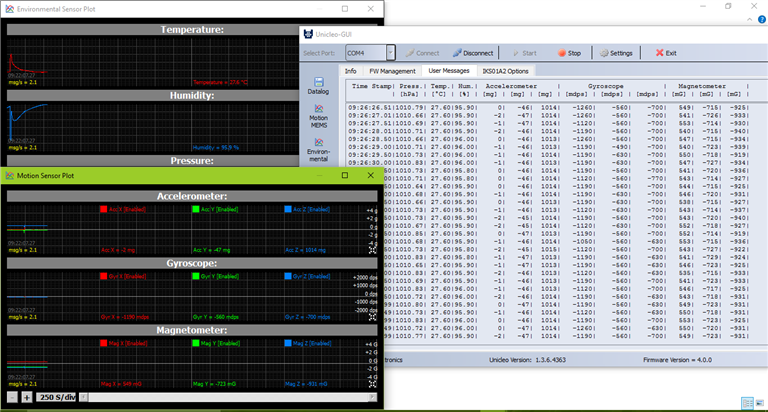

     Thank you all for your love and support. I once again would like to thank Element14 community, ST Microelectronics and Duratool for providing me a wonderful platform and Nucleo-L476 RG board along with the other expansion boards to learn about Mbed OS and programming the Nucleo boards. I had absolute fun playing with Nucleo board along with the expansion boards. My favorite I would say is the MEMS expansion board IKS01A2 [User Manual] and the below tool Unicleo-GUI for testing it.
