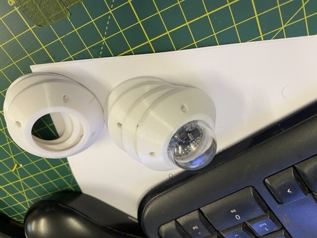

FInally, what you canonot see in the picture is a bonus in enclosure sensor for ambient light. With the case closed I get a read of 515 abritary light units and this stays constant, any change to this will give me an alert via the dashboard (whcih we will get onto)
The makings of a radiation shield, complete with ... ambient light level meter of I am going to smash all the bits on your I2C interface, good luck that with sensor.
All assembled, mid way, one weather proofed BME280 for temp, pressure and humidity and then the ambient light sensor at the very top. The radiation shield, also known as a Stevenson screen <--link for the curious (i learnt)
Test equipment holder! 40mm pipe, with insulation foam inner to which the sensor is either secured (As above) or sits in the middle of, as with the pH probe. Each holder is topped off with a 3d printed snug fitting lid and wire router.
Each test equipment holder allows for the up/down adjustment of the sensor relative to the water level ... (important for floaty mc test face) as how she will sit in the pond was an unknown ...

In Station Positioning
When sat on my desk during the build and test phase, I had approx 5m between the sender and receiver for the two MKR1300s, unsuprisingly I had a great RSSI for the duration.
Having now moved the outstation to the bottom of the garden, approximately 90m from my current position, RSSI without moving the instation end dropped almost of the chart and into the -100 / -103dBm range of, thats not great and right at the end of drops out expected. With some rain at 1020 this morning and a watchful eye on data coming in ... first missed packets were seen, as rain intensity increased albeit for a short duration, data RX dropped off.
Moved the instation reciever at 1248, during conference call :D, not a massive improvement, but better.
Line of sight distance about 90m, out of a window, through a greenhouse, out of another window and then straight to the bottom of the garden.
image image

    Nice build. It will be interesting to see how it performs over time.

    It looks good. Your RSSI is not so bad, LoRa can go much lower than -100 db and still receive data. Because you have obstructions, achieving a typical -100 db is rather good. LoRa is much better with…
  • christophesky
    christophesky over 4 years ago in reply to mp2100
    I had not previously measured the height diffeence between the back of my house and the bottom of the garden, this comes in at just over 1100mm. I may experiment with inclination of the dipole antenna on the instation end to see if this helps move things along any further. I have also treated myself to a second MKR1300 and a GPS module so I can go for a walk about and see quite how far I can still recieve data.
    I did find despite trying out other (alleged) 868 tuned antennas, none were as good as the Arduino recommended.

    I assume the blogs for the design challenge will remain open, assuming that they do I plan to report in on how it is all holding up. The pH probe is probably my single biggest question on how long will it last. As a lab grade rather than process grade test equipment when used for occassional measurement cited to run for about a year before you need to replace the electrode, mine is sampling every 30 seconds Slight smile
    Everything inside the enclosure I have no concern about, it was really put through its paces, see earlier posts on testing. I do need to finish up my build details including where I have 6mm cable runs through the 16mm glands - this was sealed up with self annealing tape.
