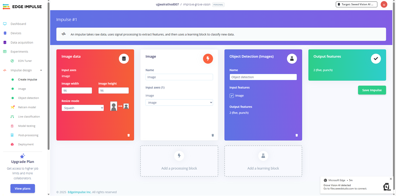

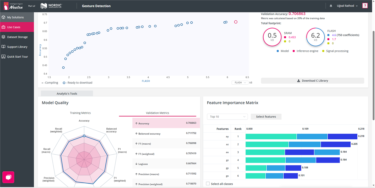

  • Machine Learning models

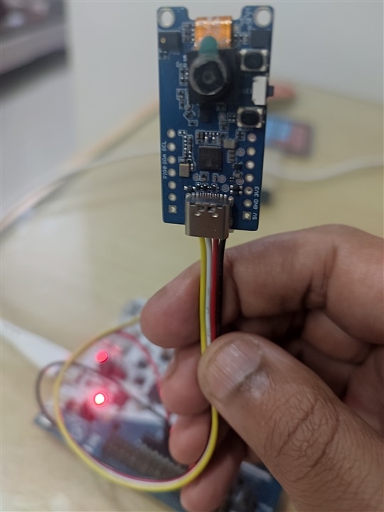

    • Vision based models
      • Using Seeed Grove Vision AI module

    • IMU based gesture detection

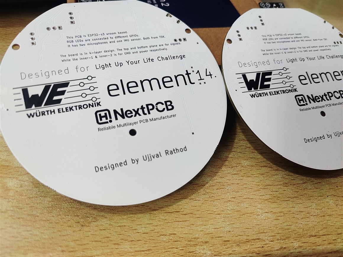

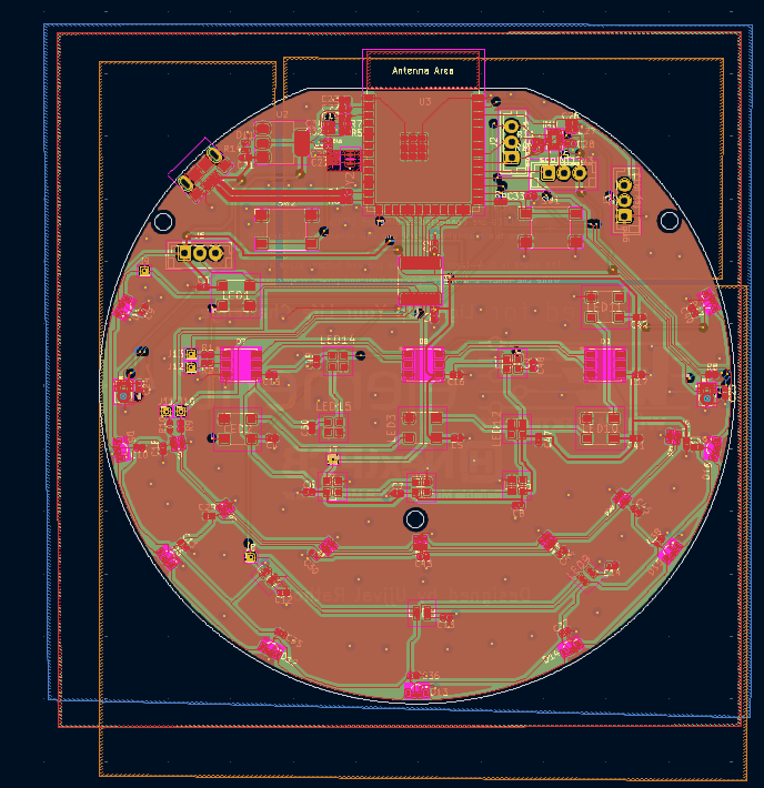

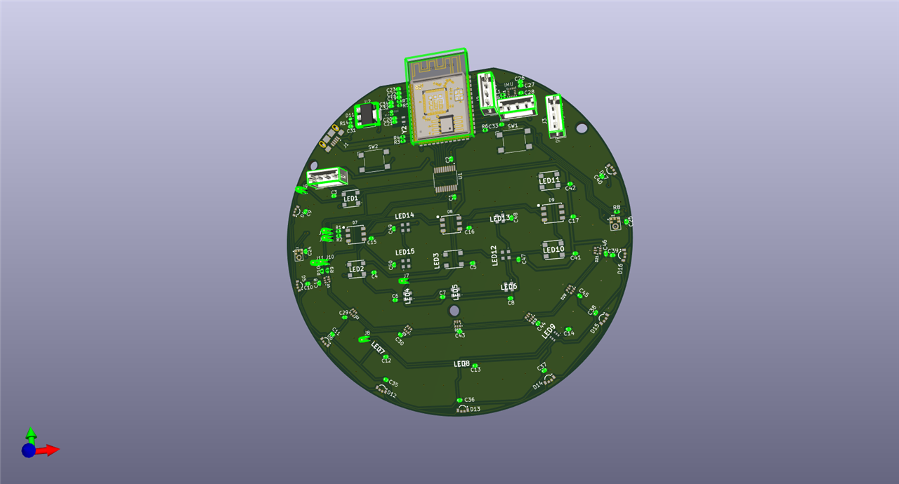

PCB design

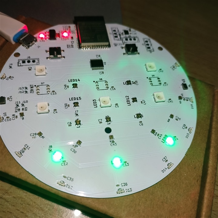

For the PCB design I have used KiCAD. I have used ESP32-S3 Wroom based design. This design has ESP32s3 chip with 16-MB flash memory. The module has inbuilt antenna and support for Bluetooth and WiFi communication. For details of schematic and detailed design you can look at Blog 1 for more in-depth information.

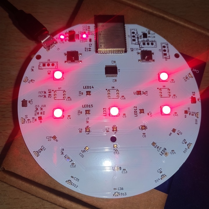

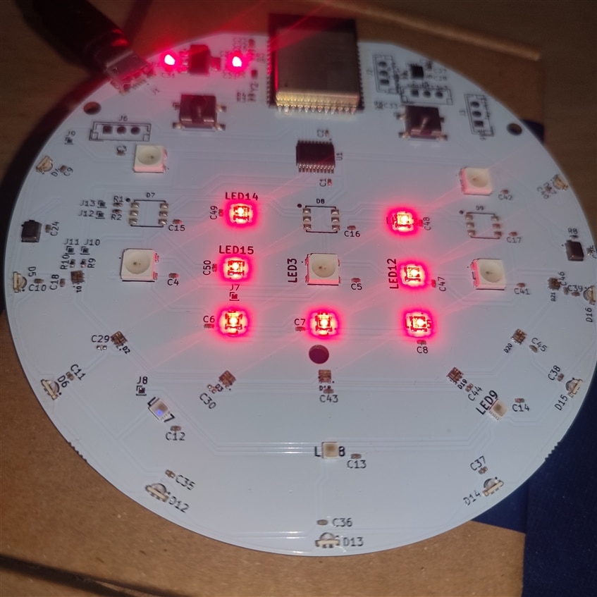

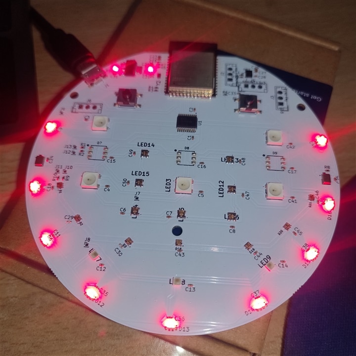

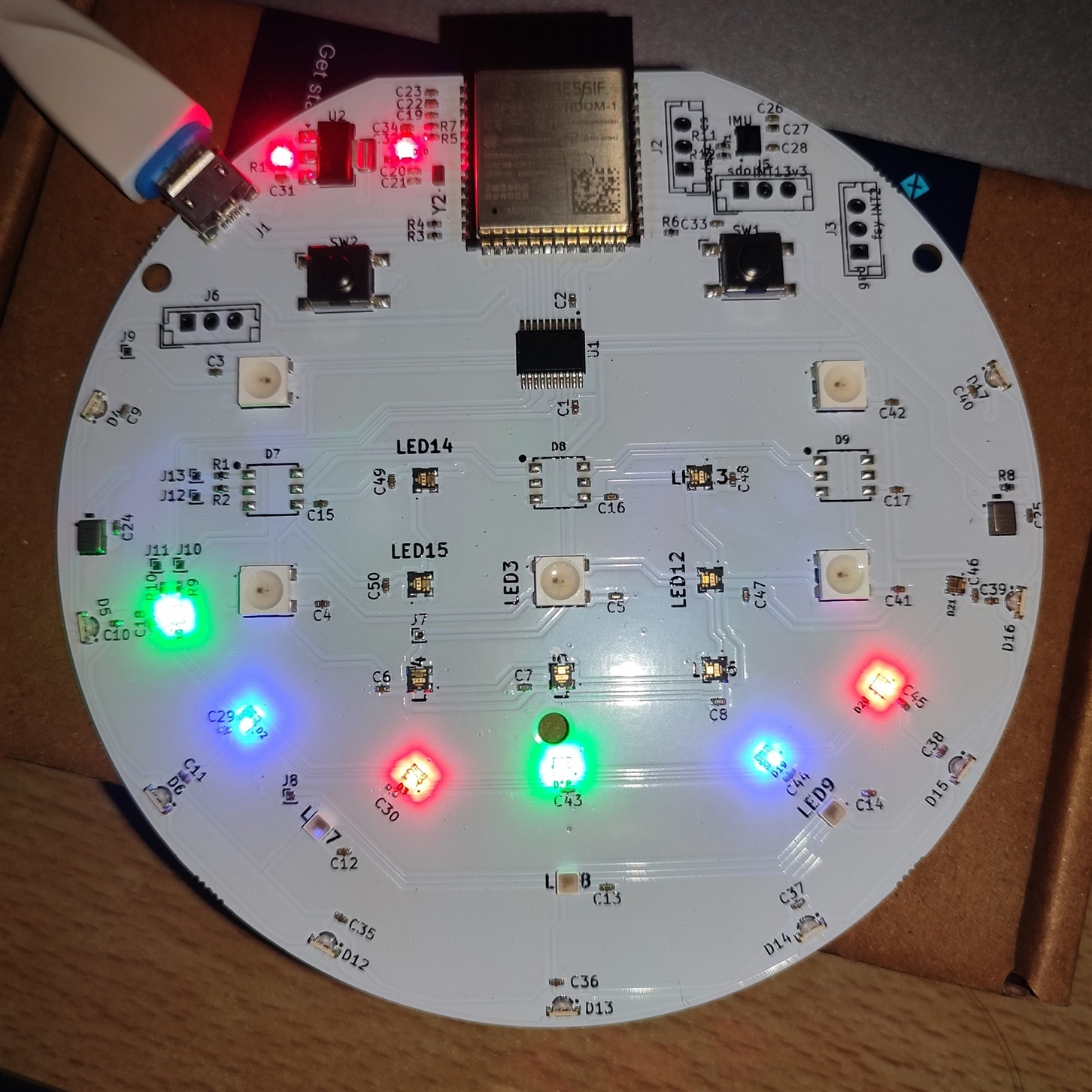

LEDs
I have use five different kinds of LEDs. These were suggested by the sponsored kit. In addition to that I have used Texas instruments level converter (TXS0108EPWR) for voltage conversion from 3.3V to 5V that nicely fits into the design.
  • 1313210530000 (9-leds on the corner) (19.5mA each)
  • 1312121320437 (3-leds) (23x3 = 69mA each) (SPI Interface)
  • 1311610030140 (7-leds) (17.5 mA each) (SPI interface)
  • 1315050930002 (5-leds) (14.5x3 = 43.5mA each)
  • 1312020030000 (7-leds) (6.5x3 = 20.5mA each)

For training and creating the model, I also have some options here. I can use Edge Impulse Studio, Roboflow, Ultralytics YOLO, Sensiml, etc to do the model training. I can then download and run the model on the Edge device.
Seeed Studio Grove vision AI module can run Edge Impulse models. It is also officially supported by the Edge Impulse. The trained model than can be downloaded to the device over USB and can run in real time. I will explain the steps that are needed to create and run this model on to the device.
The first step is to collect the require data for training of the model. To collect the data, it is advisable to use the same device that we are going to run the inference on. Grove vision AI can be used to collect the image data required for gesture detection. The Edge Impulse docs have the required firmware to be downloaded on to the device. Once downloaded the device will be connected to the Edge Impulse studio and image data can be uploaded over USB using Web browser.
Once the model training is finished as shown in the above video, one can upload the following sketch to the device and see the detection results. For this connect the Grove module to the I2C port of the device. For that, I am using ESP32s2 based device. I am also using ESP-NOW to send the detection result to the device with LED lights. In combination this device will act as gesture based remote control to change LED brightness.

# 7C:DF:A1:07:BE:A6
# Receiving the espnow packate and changing the LED colors to RED | GREEN | BLUE
# depending on the Gesture detection Punch || Five

Once the code is running, I will get the following output on the serial terminal with object detection results.
You can see the demo output. There are mainly two objects Punch and Five.
Data from IMU sensors such as Accelerometer and Gyroscope could be used to train the ML model. For this I thought of trying something different. I decide to train a model using neuton.ai platform to create a lightweight model that can be easily integrated into ESP32s3 device. This model can detect various hand movements and control the LED lights.
For collecting the data in .csv (suggested by the neuton.ai docs) format I am using the following Micropython code. The data collected then can be used to train the model on neuton.ai platform. I have collecting approx 10 samples for each movement. Each movement is one and half seconds long.
Here are the movement types that I am collecting the data for.
  • Round circle
  • up-down movement
  • Wave movement

I have already trained the model successfully and got approx. 70% accuracy. After training is completed, I got a file containing the trained model for deployment to the device. I can use this model to integrate into my code and control the LEDs based on that
(At the moment I am still working on this)

Effects are ways to make LEDs look more interactive and decorative. There are different effects that are possible with colorful LEDs. I have tried to create some.
  • Rainbow Effect
Rainbow effect is one of the very basic LED effects. This effect generates color similar to a Rainbow and changes this color between number of LEDs in the strip.
  • Fading Effect
Fading effect is like making a strip to full brightness and then again making brightness to zero. This effect looks catchy in some decorative light's scenarios.
  • Cycling Effect
Cycling is way to cycle through the strip and make each LED brighter than the others one by one in a sequence.
The following is video illustration of Effects using LEDs and Micropython code.
import neopixel
import machine

eff  = LIGHT_EFFECTS()
while True:
#     eff.chassing()
     eff.fadding(20,20,20)
#     eff.rainbow_cycle(0.0000001, 9, 12)
#     eff.rainbow_cycle(0.00001, 7, 47)
#     eff.rainbow_cycle(0.000001, 5, 45)
#     eff.rainbow_cycle_spi(0.01, 5, 45)
    #eff.rainbow_cycle_spi2(0.001, 3)
