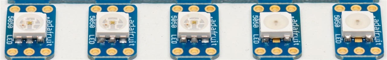

A Closer Look at the Results

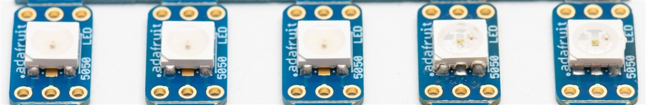

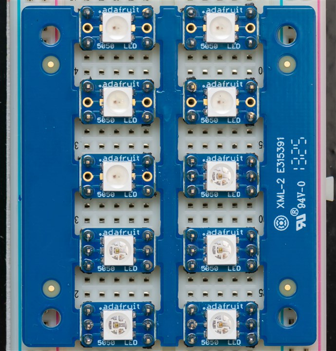

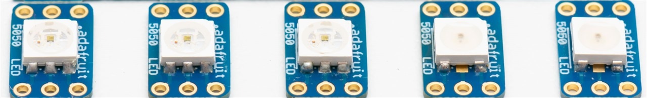

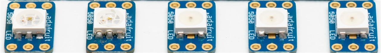

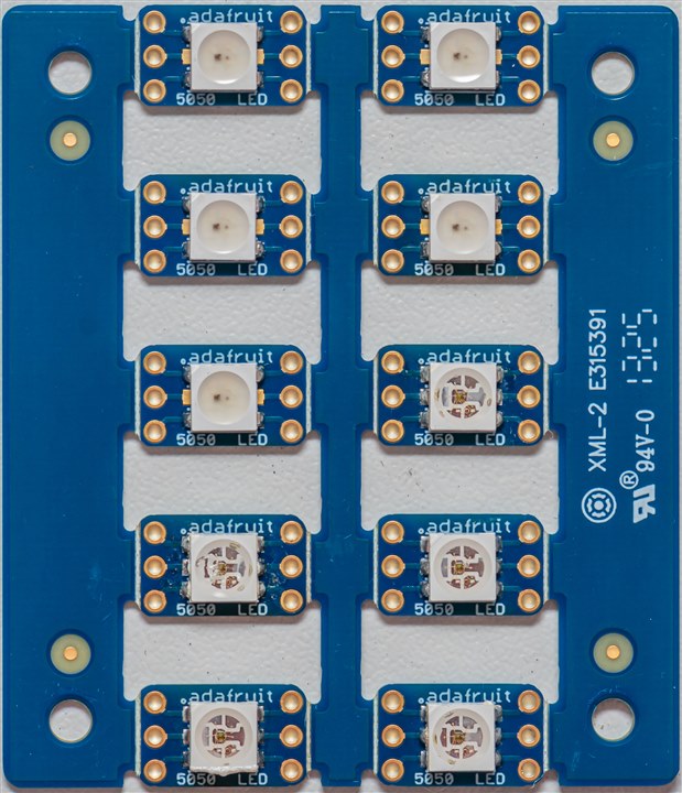

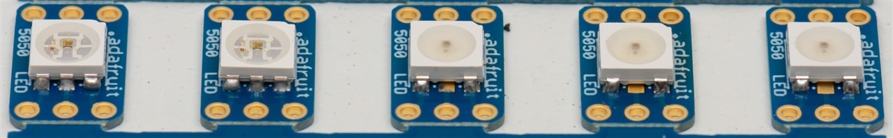

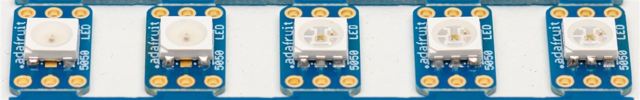

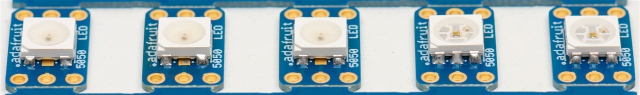

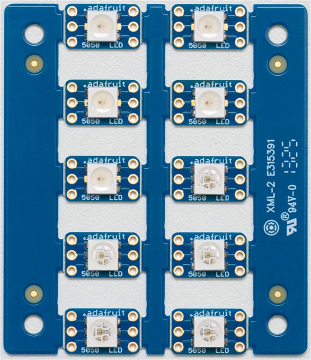

After washing, the toll became clear. If we number the LEDs going across from left to right (1,2) then down by rows (3,4) until we get to the bottom (9,10), we can identify a few issues.
The four-pad LEDs [1,5] are all done using leaded solder and hot-air gun method. They’re actually all looking very good – except for some non-planarity because of too much solder on some pads causing them to angle very slightly, they’re about as good as I’d expect.
The LED [6] is the one hand-done with SN100C lead-free and it’s showing some signs of heat stress. It’s very subtle though – looking at the angled “cup”, we can see three spots where the lens seems to have bubbled away from the plastic base corresponding to three of the leads. That’s a clear case of heat damage, but not likely to be a major consequence.
On the other hand, LED [7] was soldered with SAC305 lead-free and that was very challenging. Not only did I cook the legs causing the plastic base to mushroom, post-wash, it’s clear that the optical resin used to pot the LED has become damaged too. Perhaps this LED might take a life-expectancy-hit and a bit of a modified optical performance, but it should still work. It’s not a good result. There's also what seems to be no-clean flux residue as well.
The hot-air-gun LED [8] is doing just fine … while LED [9] has the charred bottom lip and a slight bubbling on that area too. Finally LED [10] also shows bubbling around the three left leads, but not all that significant. I’d say this is strongly in favour of the hot-air-gun method but perhaps I need to turn down my soldering iron tip temperature too …

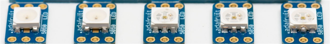

From the edge, we can see the various levels of “toastiness” that the leads got to, thanks to my soldering iron technique.

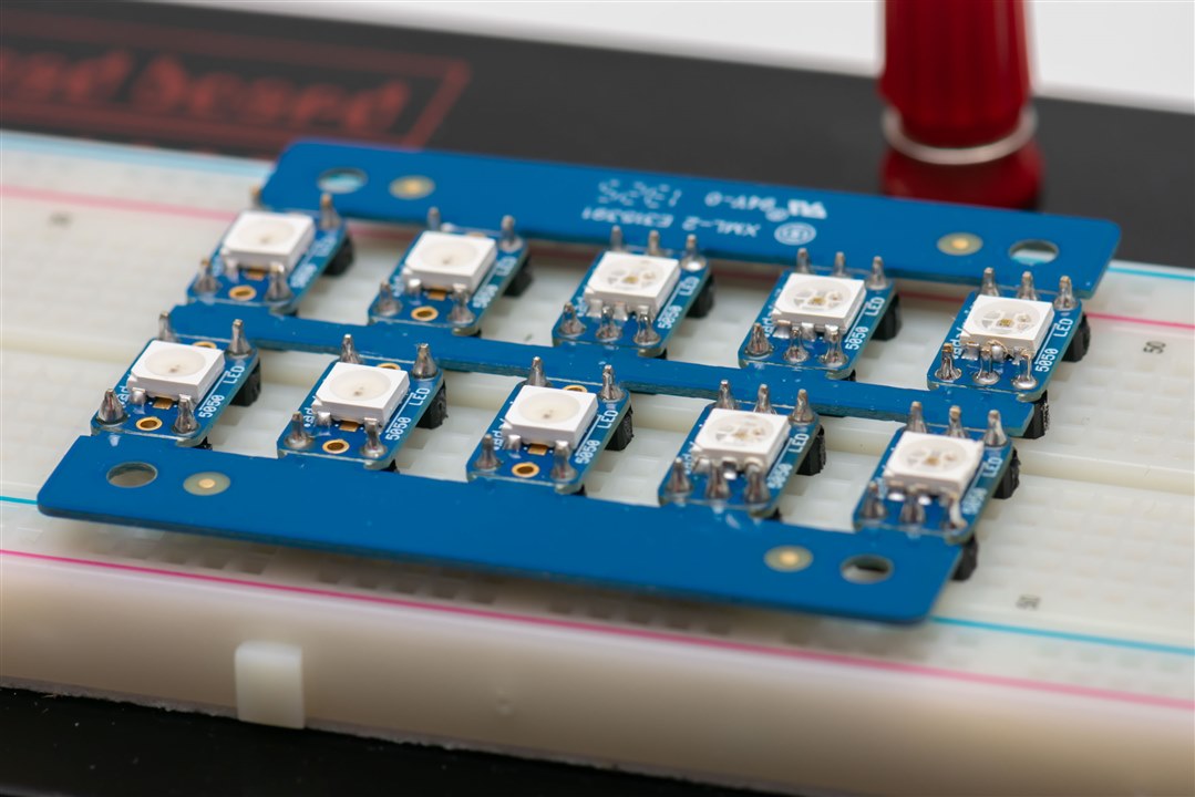

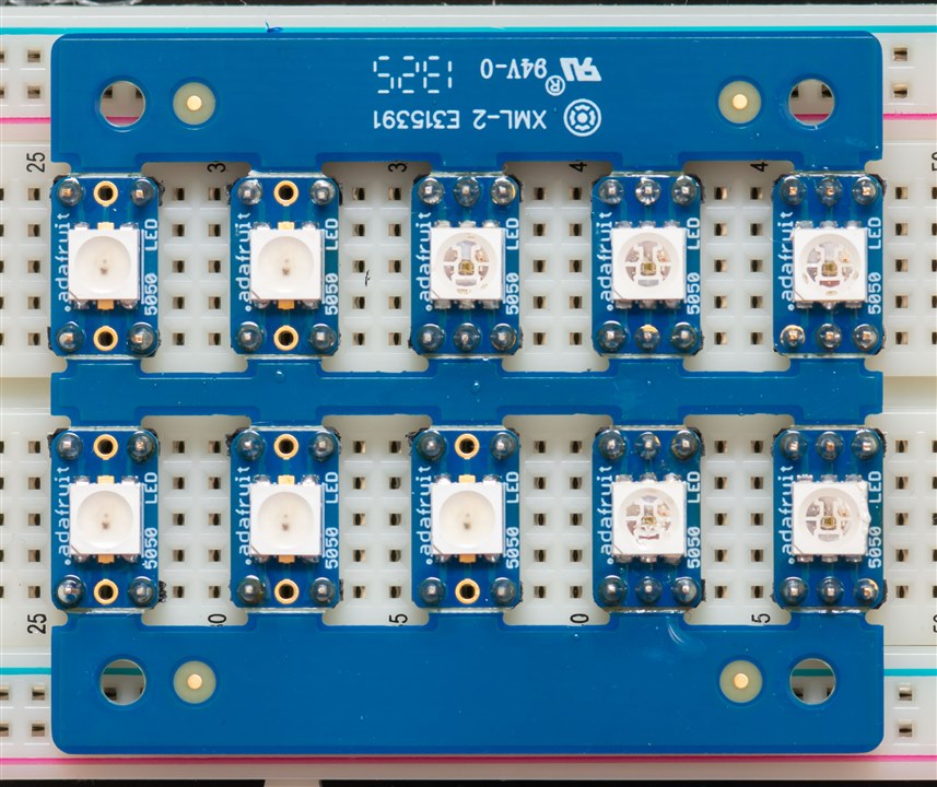

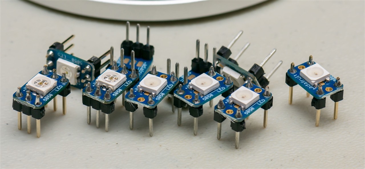

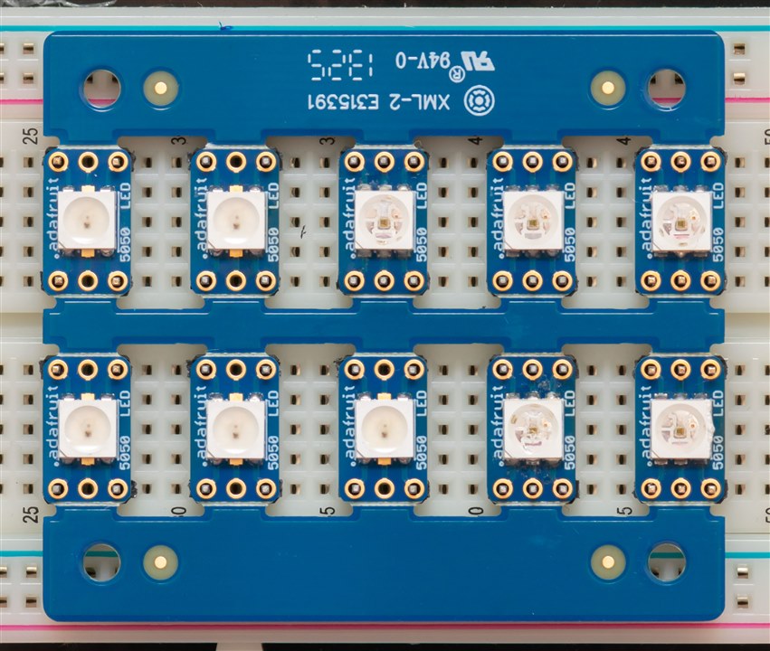

I will say that the Adafruit break-out is genius though. It’s designed such that the holes line-up perfectly on a 2.54mm grid, so that you can easily use a breadboard to help you get the header pins lined up. Unfortunately, I realised I was running low on header pins (something you never really expect to run out of) so I had to ration just four pins for those LEDs with four connections.
Since heat is much less of a danger here, I went with the SN100C lead-free (my favourite lead-free alloy at this point) so as to break my habit of just using leaded solder.
Then, carefully, the board can be snapped apart along the V-scores to produce individual plug-in units. Very nice!
Five of each was nice, but I decided that ten would be better. It’s hard to demonstrate anything particularly handy with just five, so this time, I went hot air gun on all of them. I saw two minor bubbles in the clear epoxy on LED [6] but that was no drama. I’m wondering if this is also because these LEDs were not properly packaged in terms of moisture control and I certainly didn’t pre-bake them prior to use.
Much nicer looking from the edges this time, but not all joints are quite as nice looking as they could be, in part due to slightly excessive solder.
Header pins go in – this time, I had to break open some unused break-outs just to steal their included header pins. I’m facing a header-pin crisis here! Thankfully, I do have a batch of ~20,000 header pins on their way … it will just take some time.
With that, I should have enough to get started breadboarding up the WL-ICLEDs for testing to see if they will work as intended.
