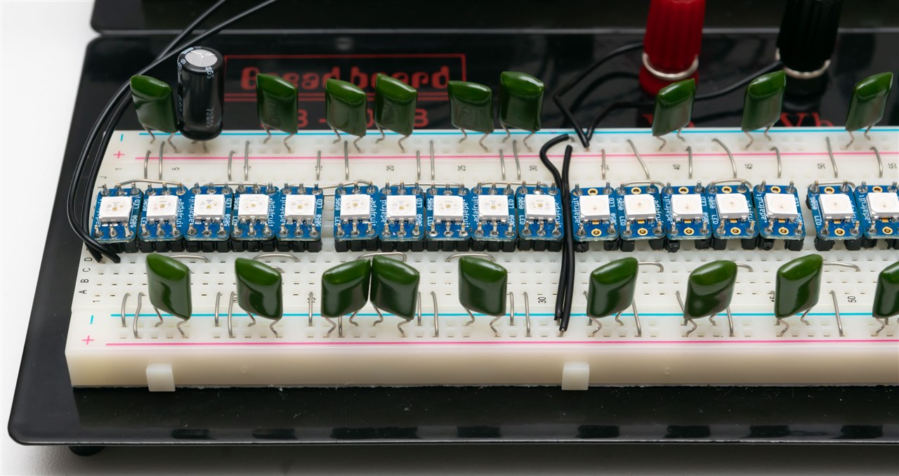

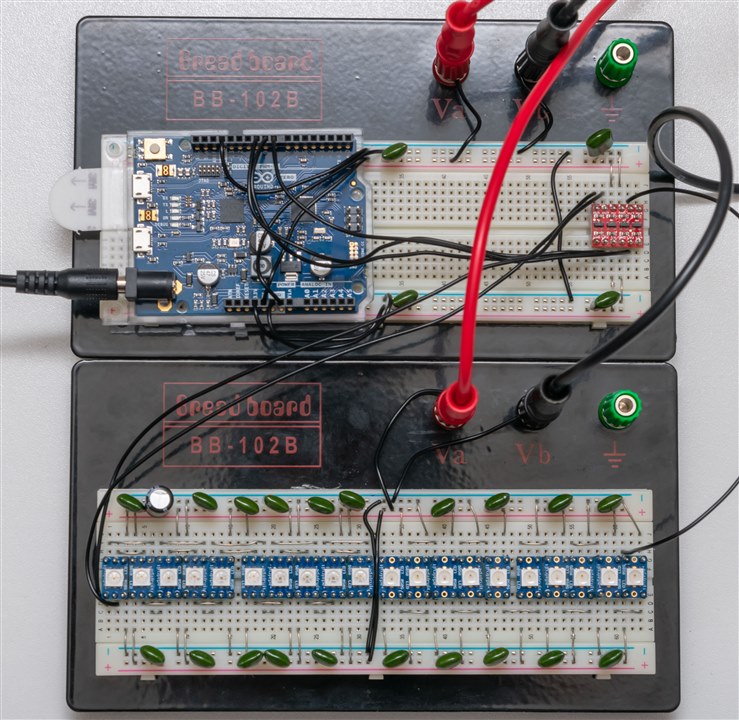

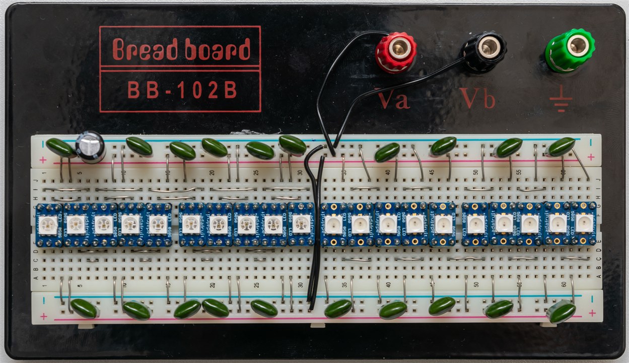

To achieve first light, I first had to spend an hour or two breadboarding up my 20 LEDs for power and daisy chaining data and/or clock connections. This was a therapeutic exercise, although one I decided to do with “bare” tinned copper (i.e. stripped solid core wire) as I felt that might look a bit better. I don’t usually stock much colour variety when it comes to wire – so if it wasn’t bare, all my wires would be black.
Persistence pays off, but also being conscientious. I didn’t want any accidents.
I’ve sprinkled a lot of 100nF greencap capacitors (as I had them lying around) onto the power distribution rails, since the PWM of the LEDs can modulate the supply and create quite a bit of noise. As the LEDs themselves contain an IC, ensuring somewhat stable power is important to avoid malfunctions. I’ve also added a bigger electrolytic to the board since it’s going to be getting power from somewhere else … along some unavoidable length of wire.
But as you would have noticed, there’s now no space for anything else, so thanks to element14 for having the foresight to supply a second breadboard.

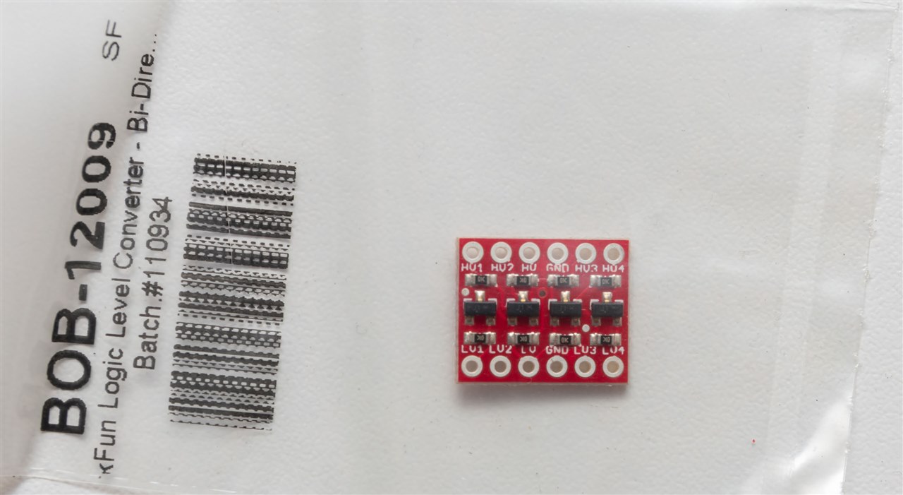

The next issue was the level shifter. The supplied IC had no breakout, which meant I couldn’t use it directly on the breadboard. After digging through my bin of unused bits, I managed to find a Sparkfun BOB-12009, a level shifter based on BSS138 MOSFETs and pull-up resistances – it’s crude but it certainly works at I2C rates. Perhaps clocking down a little on the synchronous-bus type would help ensure it works.
To test the LEDs, there will need to be a demonstration of sorts, so I opted to run the most traditional FastLED demonstration of all – one called demoreel100.ino. To make this work, I modified it to define two different LED strips with the controller parameters I’ve mentioned earlier, and duplicated each led array modification call with another one for the second LED array (led2). It’s not pretty, but it should work.

The assembly was completed with some double-sided tape to hold the Arduino Zero to the other breadboard, getting headers onto the level shifter and wiring it all together. It’s time to give it a try …

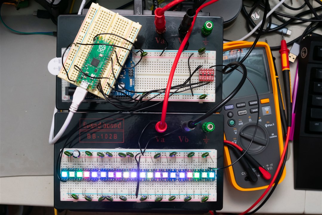

Two different types of LED displaying the same content, nice and smoothly. I’d call this a success! It better have been, since it was a lot of breadboard work to get here. It’d be a shame if it didn’t …
Testing Another Platform
I wasn’t completely happy with this, because the Arduino Zero isn’t quite ideal in terms of its form factor. I wanted to use something cheap, something with wireless capability, but oddly enough, not an ESP32 (I’m a bit tired of having external USB-UART adapters for them). I could have opted for an ESP32-S3 but some dabbling left me a little underwhelmed, so instead, I’ve got a soft-spot for the Raspberry Pi Pico W now, so I wanted to be sure that it could run on the RP2040 platform.
At this point, I was a bit uncertain, as this FastLED GitHub page actually doesn’t mention the RP2040 as a supported platform at all. But then, in 2022, there was a request to add RP2040 support, connected to a pull request in November that same year. Would it even work?

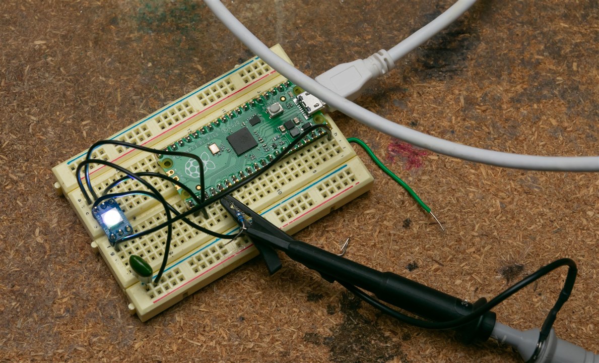

The easiest way, I thought, was simply to try it. So grabbing a tiny breadboard and a RP2040 based non-wireless Pico that I had lying around, I wired it in, modified the code to match the right pins and …
Surprise, surprise. It worked just fine and this was with the Earl E. Philhower III core as opposed to the official Arduino mBED core. Well, I should have seen this coming, because after some digging, it seems FastLED’s documentation is a bit all-over-the-place, as they have a different docs page which lists many more platforms on which it works – RP2040 included. I only discovered it after doing the tests though … as one usually does.

For this experiment, I decided to use the small breadboard and the Raspberry Pi Pico as the main driver, as I really only need to measure one LED, so I didn’t need the rest of the array getting in my way.
So I wired it up … but notice something is missing? Yes. There’s no level shifter. Gasp! As it turns out, I had mindlessly omitted it … but it still worked which was surprising.
