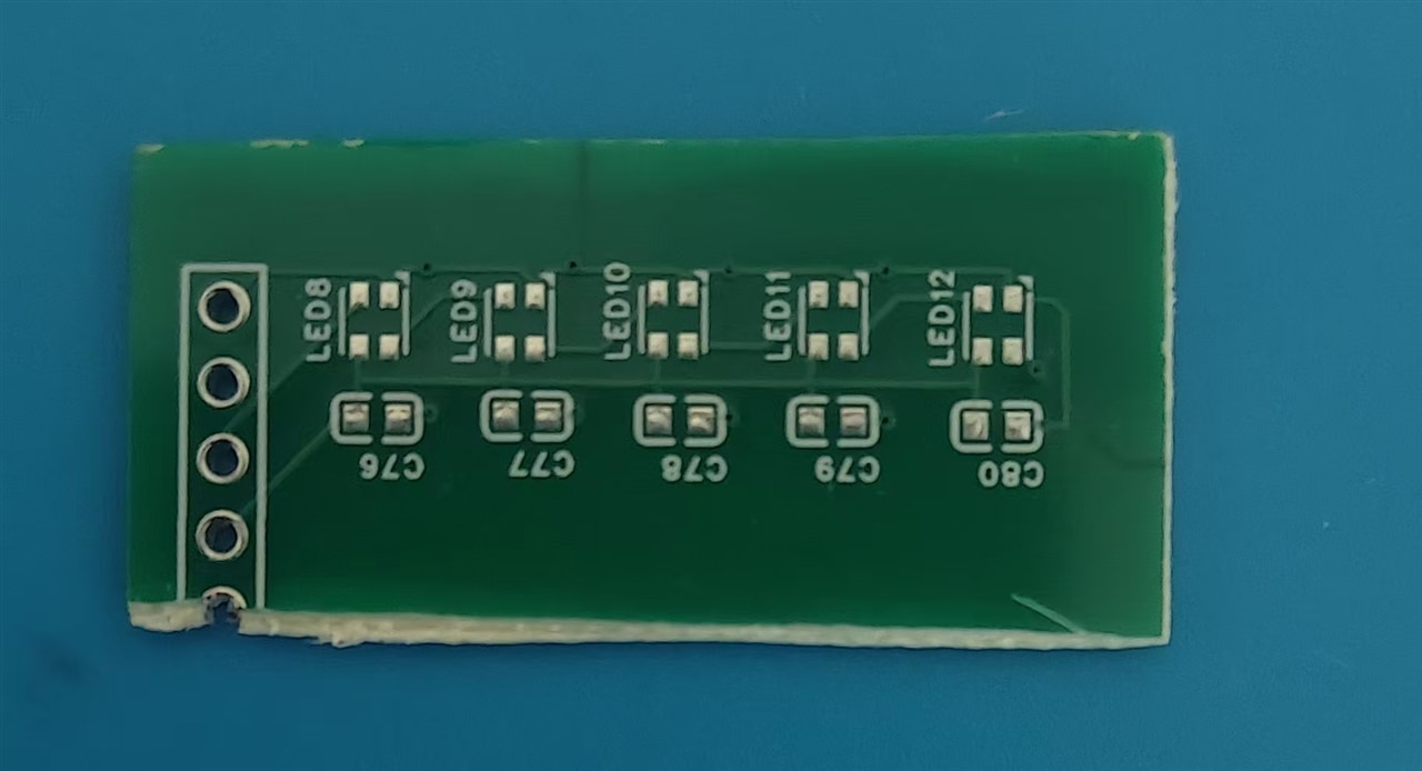

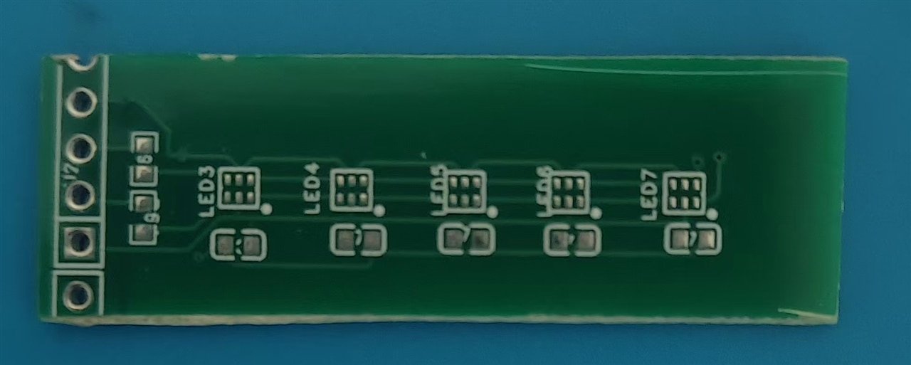

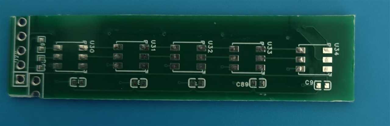

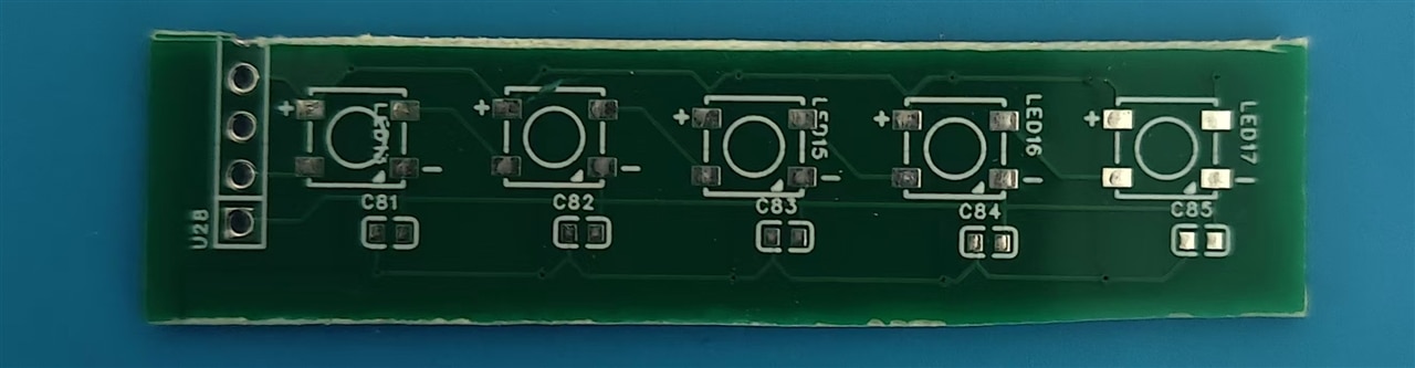

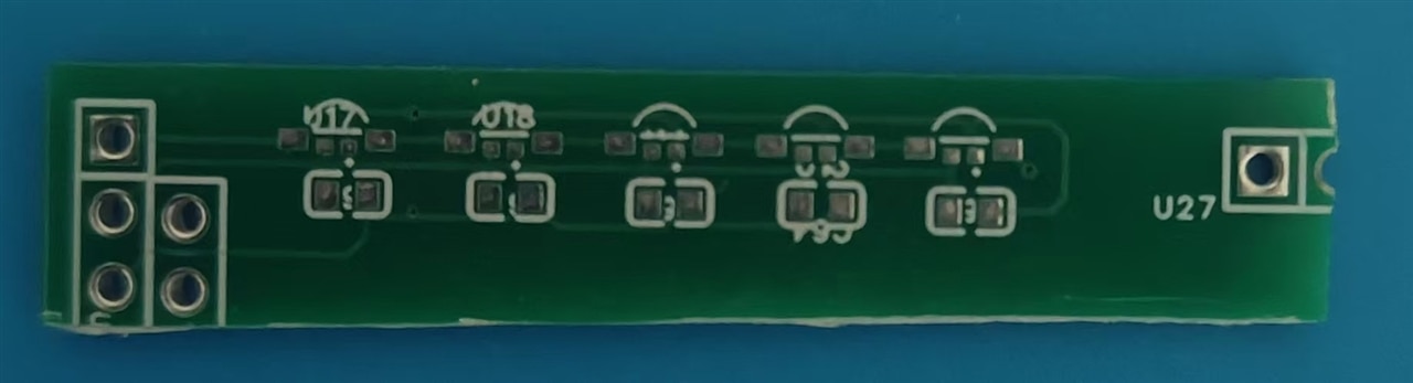

1 Arrival of PCBs
With easyEDA, PCB for  six PCB for SIX WL-ICLED Integrated Controller LED are designed and just arrived recently as Smart car chamber #3 Comparisons of WL-ICLED Integrated Controllers and schematic designs - element14 Communit
There are various type in desgin and basically  fit for different Control Communication Protocols.

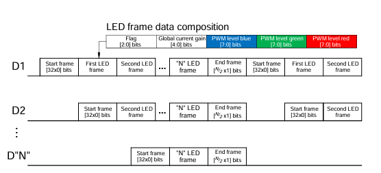

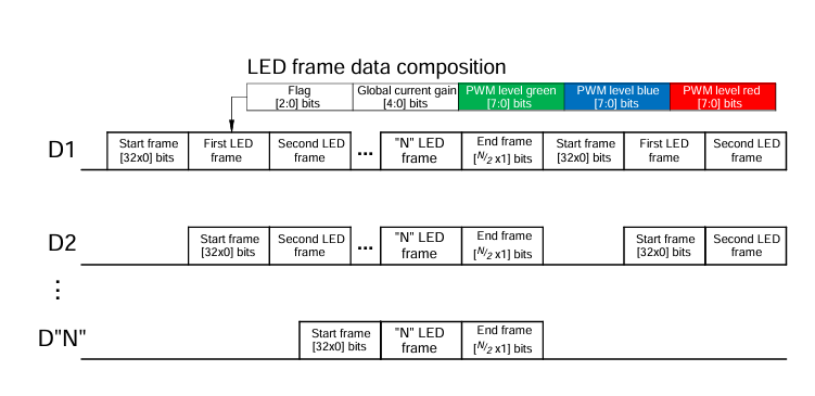

The data frame serves as the core carrier of the protocol. The frame structures of the six products can be categorized into three types: "32-bit start frame + LED frame", "24-bit simplified frame", and "48-bit high-precision frame".
Protocol Type Corresponding Order Number Frame Structure Details Core Features
32-bit Start Frame + LED Frame 1311610030140, 1315050930246 1. Overall frame sequence: 32-bit start frame (fixed as 32 "0"s) + "N" LED frames (N = number of LEDs) + [N/2 "1"s] end frame
2. Single LED frame content:
- 1311610030140: 3 flag bits + 5 global current gain bits + 8 green PWM bits + 8 blue PWM bits + 8 red PWM bits
- 1315050930246: 3 flag bits + 5 global current gain bits + 8 blue PWM bits + 8 green PWM bits + 8 red PWM bits (only PWM color order adjusted)
Complex frame structure with a complete "start-data-end" sequence; supports unified adjustment of global current.

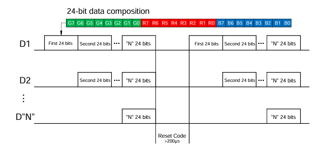

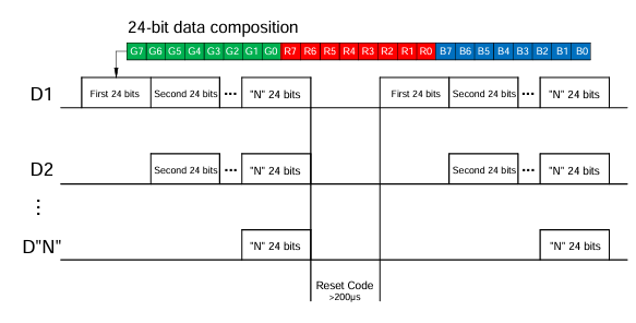

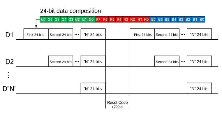

24-bit Simplified Frame 1312020030000, 1313210530000, 1315050930002 1. No start/end frames; only a single 24-bit data frame
2. Frame content: 8 green PWM bits (G7-G0) + 8 red PWM bits (R7-R0) + 8 blue PWM bits (B7-B0)
Extremely simple structure; no additional control bits; focuses solely on RGB PWM dimming.

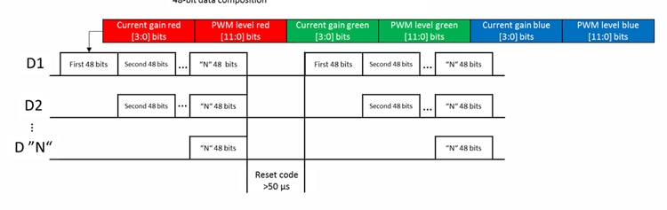

48-bit High-Precision Frame 1312121320437 1. No start/end frames; only a single 48-bit data frame
2. Frame content: 4 red current gain bits + 12 red PWM bits + 4 green current gain bits + 12 green PWM bits + 4 blue current gain bits + 12 blue PWM bits
Longest bit width; supports "independent current gain + high-precision PWM"; highest dimming precision.

Frame Sequence Synchronization 1311610030140, 1315050930246 1. No additional reset pulses required; synchronization is achieved via a fixed data stream sequence ("32-bit start frame (32x0) + LED frames + end frame (N/2x1)")
2. In multi-LED cascading, the controller automatically identifies start/end frames to distinguish data for different LEDs
Flexible cascading quantity; no additional synchronization signals needed; suitable for complex LED arrays.
Reset Pulse Synchronization 1312020030000, 1312121320437, 1313210530000, 1315050930002 1. No fixed frame sequence; synchronization relies entirely on external reset pulses:
- 1312020030000, 1313210530000, 1315050930002: Reset pulse duration > 200μs
- 1312121320437: Reset pulse duration ≥ 50μs
2. In multi-LED cascading, a reset pulse must be sent before each data transmission round to avoid data misalignment
Synchronization depends on external pulses; suitable for simple cascading (e.g., ≤ 10 LEDs).

High Precision 1312121320437 1. PWM bit width: 12 bits (4096 dimming levels per color)
2. Current control: 4-bit independent current gain (16 adjustment levels); red, green, and blue colors are adjusted independently
Extremely high number of brightness adjustment levels (4096 levels); supports independent current fine-tuning for single colors; suitable for professional scenarios (e.g., stage lighting, display devices).

data transmission diagram 1311610030140
data transmission diagram 1312020030000
data transmission diagram 1312121320437
data transmission diagram 1313210530000
data transmission diagram 1315050930002
data transmission diagram 1315050930246

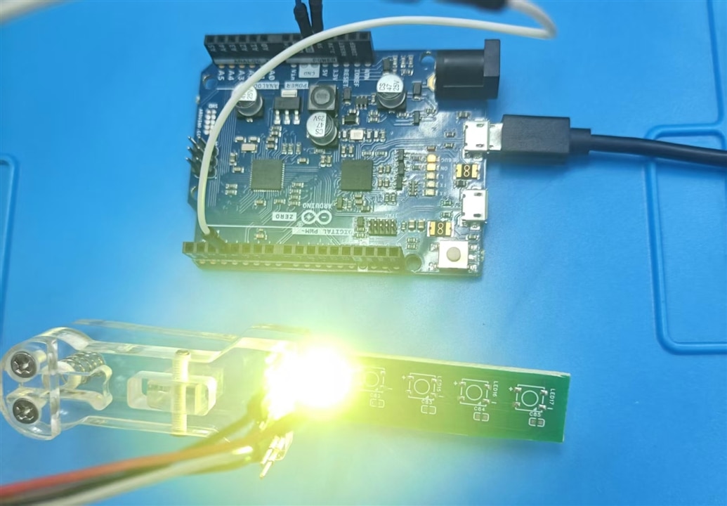

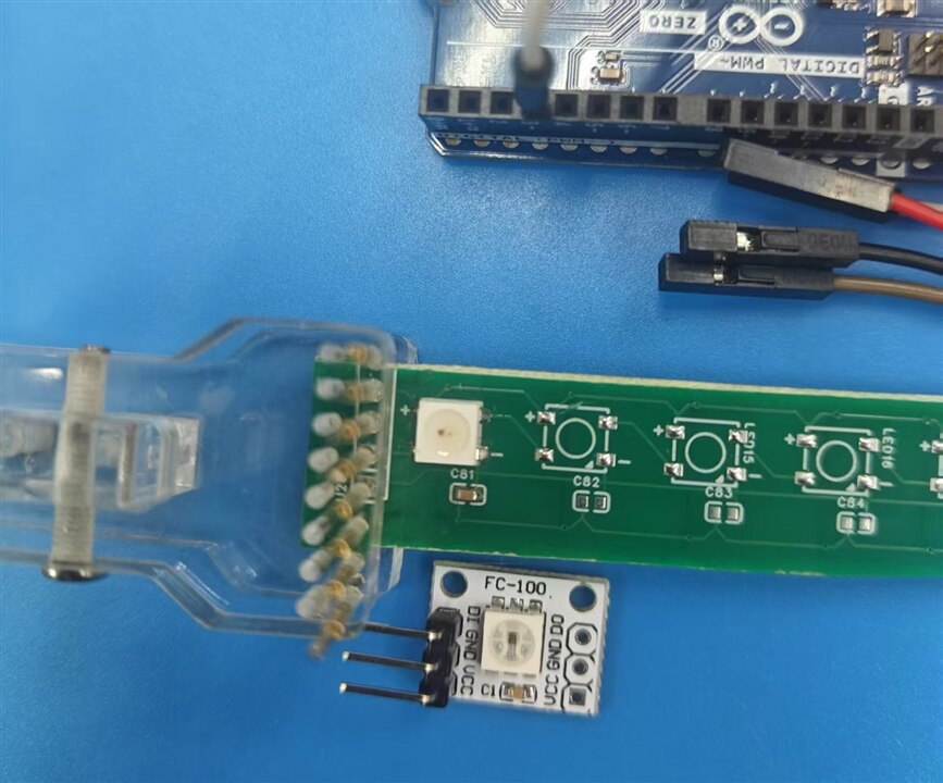

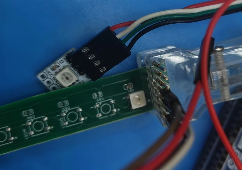

4 Blink the LED with Arduino FastLED library
The have been example for Arduino FastLED library. The simpliest application is same as that of WS2816
For start-up, start from 1312020030000, the 4-pins LED size of 50x50 , with only one welding on board, wiring with test clips
Other types of WL-ICLED shall be tested after welding on boards.
5 The control pin matters a lot
At first, the WL-ICLED is welded with this simple welding plate, good for LED removal, But some pin is not fixed in good position, the WL-ICLED light up without blinking.
Then I hand weld again, it works fine.
The data in pin is important, it outputs command for LED illumination control. If it is removed, the state of led is not changed again, it stale in on state of off state only.

    I am glad your PCBs arrived great photos and videos!
