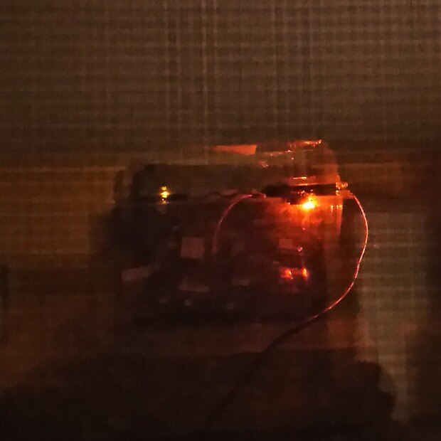

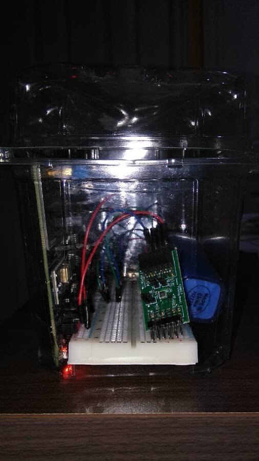

I've looked up the current temperature and humidity and set them in the code as ZMOD4510 AQI v2 library needs them as input to calculations.

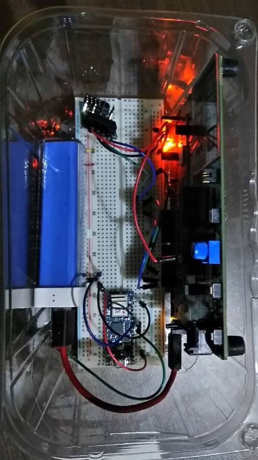

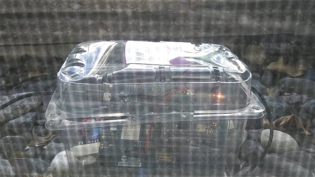

I've packaged breadboard, cables, power bank, CY8CKIT-062S2-43012, and ZMOD4510 into a box. And put them outside next to my window. I've connected to the monitor from the app. The LED on the board has switched on to indicate that it is connected to the board. I was lucky with the weather as it was not windy, no rain or snow, So my testing box was safe from outdoor elements.
{gallery} Air Quality Monitor
The sensor: view from the top
The sensor: view from the side
The sensor: The sensor in the night
The sensor: The sensor in the deylight

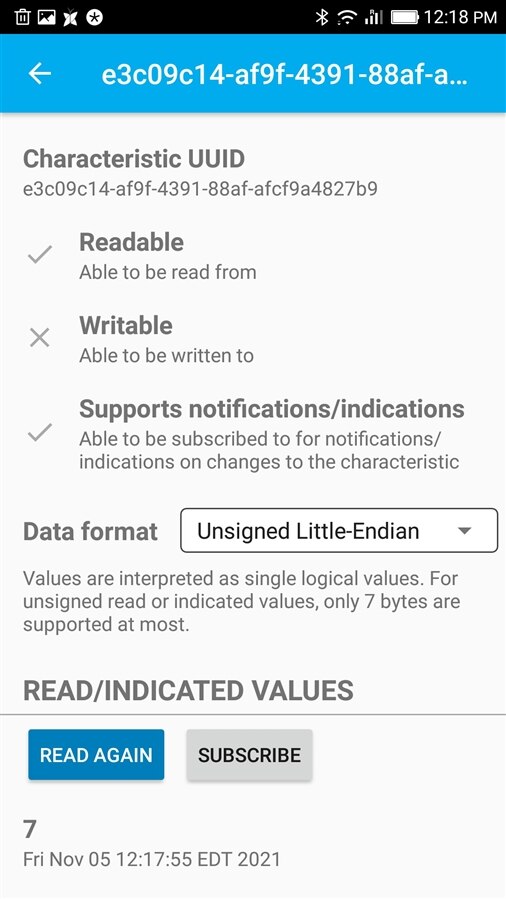

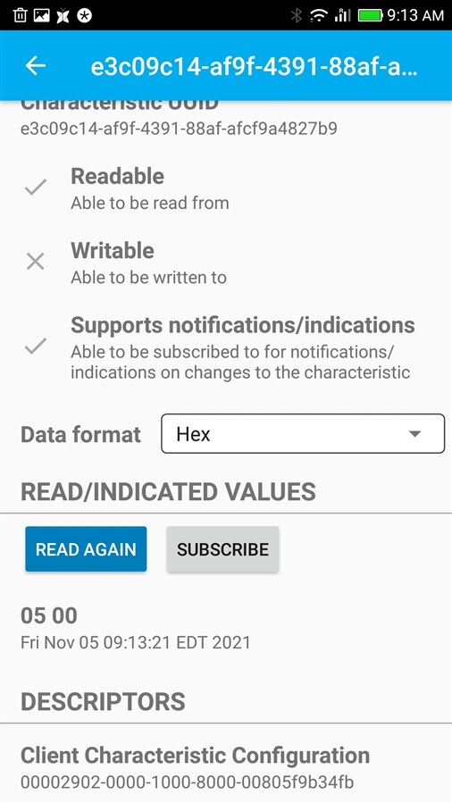

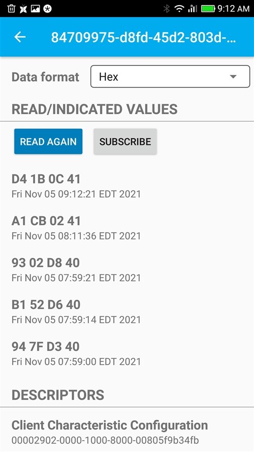

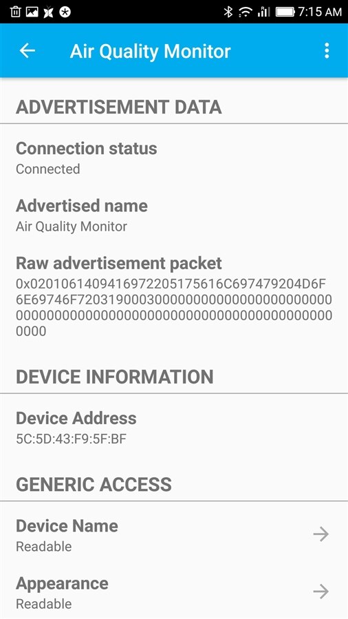

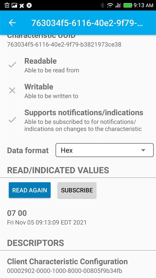

After waiting for 30 minutes for the sensor to become stable I read the sensor output. I've used an Android LightBlue app to connect to the Air Quality Monitor.
{gallery} The sensor readings from the app
Air Quality Monitor: BLE Connection established
Air Quality Monitor: O3 ppb readings as float32 in HEX
Air Quality Monitor: Fast AQI in HEX
Air Quality Monitor: EPA AQI in HEX
Air Quality Monitor: EPA AQI in Unsigned Little-Endian

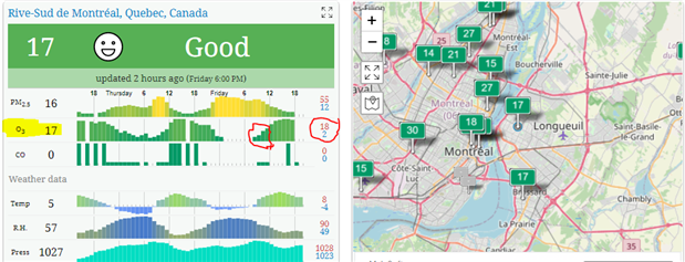

1. The sensor is working well in an outdoor environment and generates a valid output. It seems comparable to the output provided by the nearby station https://aqicn.org/city/canada/quebec/rive-sud-de-montreal  , which reported O3 AQI in the range between 2 and 18 and it was 10 during my measurements.
TODO: I need to build an app that can easily show all data on one screen and in a human-readable format.

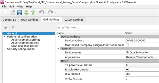

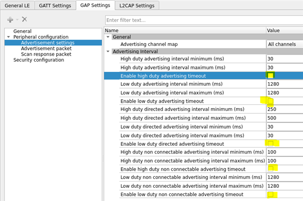

2. The Bluetooth connection from the Air Quality Monitor disappears after some time if the app is not connected to the device.
TODO: I need to investigate additional GAP parameters, which I left as is in the Bluetooth Configurator.
3. The breadboard is not the best option for outdoor testing as cables can easily be disconnected.
TODO: Need to package the monitor without the breadboard to make it more resilient.

6. BLE notifications were configured, but are not working.
TODO: I need to investigate and resolve the issue.

The connectivity issue was resolved by disabling advertising timeouts in the Bluetooth Configurator GAP Settings.
Update #2
The issue with BLE notifications fixed by modifying function app_set_gatt_attr_value in app_bt_gatt_handler.c with settings for humidity, AQI, and ozone.
