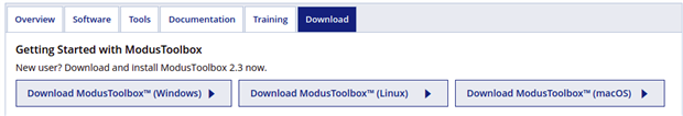

Download ModusToolbox (Linux)
As of writing, it is ModusToolbox version 2.3

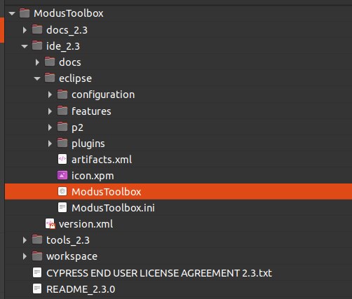

It is a tar.gz file. I extracted it into a folder ModusToolbox into my home folder ~/

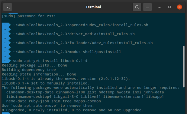

According to the readme file, I need to run the following installation commands as follows:
~/ModusToolbox/tools_2.3/openocd/udev_rules/install_rules.sh
~/ModusToolbox/tools_2.3/driver_media/install_rules.sh
~/ModusToolbox/tools_2.3/fw-loader/udev_rules/install_rules.sh
~/ModusToolbox/tools_2.3/modus-shell/postinstall
sudo apt-get install libusb-0.1-4

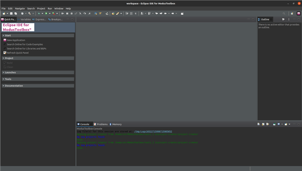

Go into the directory and start ModusToolbox by double clicking on this file
  • ~/ModusToolbox/ide_2.3/eclipse/ModusToolbox

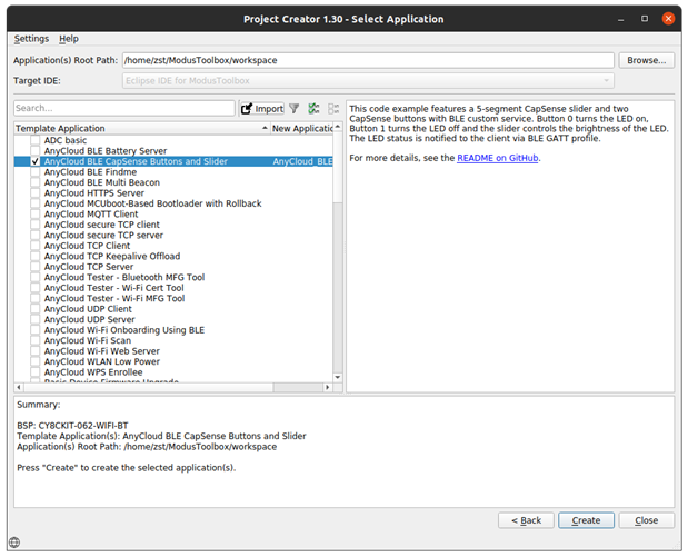

The app will launch and I am greeted by this screen. From Quick Panel, choose New Application.

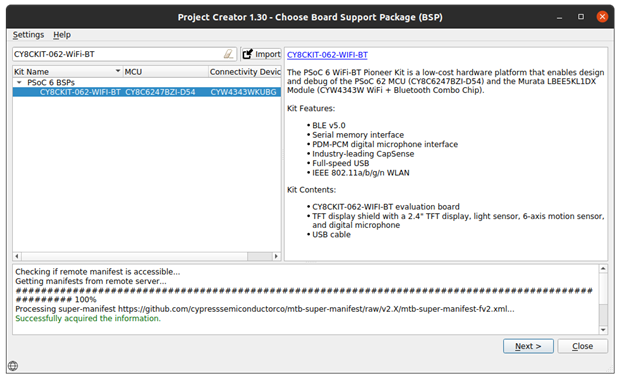

I got the PSoCRegistered 6 WiFi-BT Pioneer Kit so I chose CY8CKIT-062-WiFi-BT.
Cypress PSoC 6 WiFi-BT Pioneer Kit Specs and Moreimage
Based on my proposal, I decided to choose the AnyCloud BLE CapSense Buttons and Slider template as it covers the main code of what I need (BLE and CapSense). I will add on relevant libraries along the way.

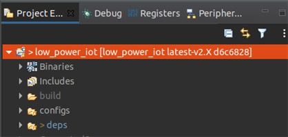

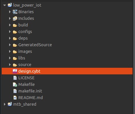

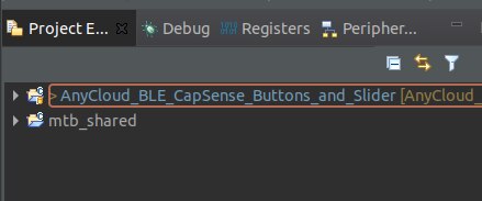

After creating the project, you will see it in the Project Explorer. Right click it to rename it to our own name

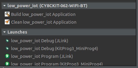

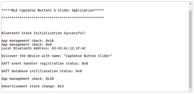

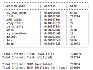

Program the board. At the bottom left, you will see options in the Quick Panel. Choose Build and then Debug using KitProg3.
If the programming is successful, you will see build details in the console
After programming the template, launch your favorite UART serial console and details will be printed on it. It indicates the board and the bluetooth events are functional

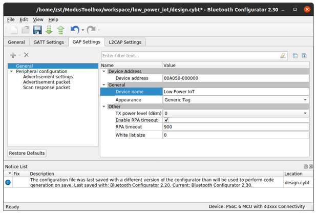

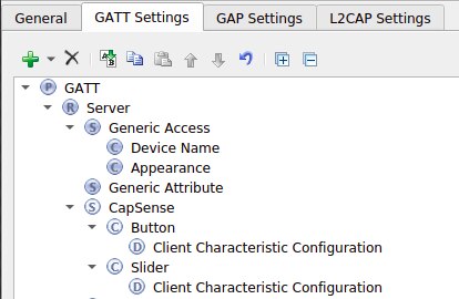

Double click on design.cybt. This will open up the BLE configuration.

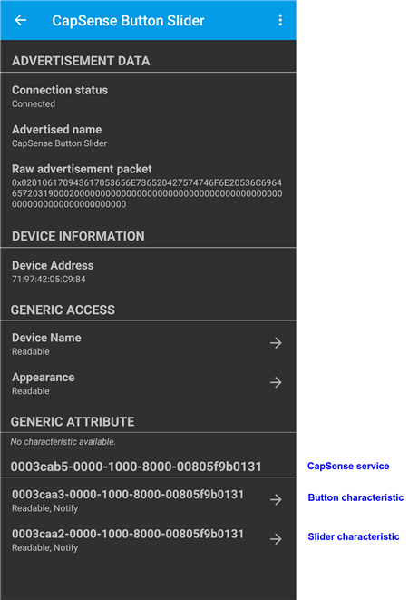

If you go to GATT settings, you will see a service called CapSense and it has Button and Slider characteristics under it.
So from reading all the settings, we get the following IDs are programmed into the board, let us verify it.
CapSense (Service)0003CAB5-0000-1000-8000-00805F9B0131
Button (Char)0003CAA3-0000-1000-8000-00805F9B0131
Slider (Char)0003CAA2-0000-1000-8000-00805F9B0131

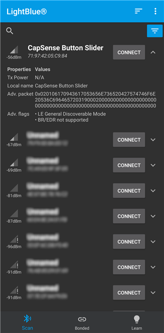

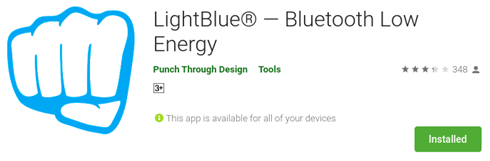

On an Android phone, I installed this app to debug the BLE communication
  • https://play.google.com/store/apps/details?id=com.punchthrough.lightblueexplorer

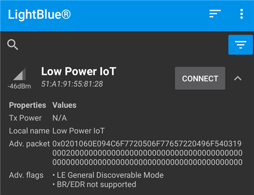

With this, we can connect to the device.
Upon connecting, notice that the ID codes are the same as what we have observed.
To do a simple test, I renamed the device. Go to GAP Settings and change the Device name
Download the code to the board, and I see the new name on my phone!
