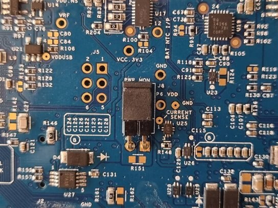

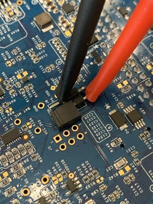

On the back of the PSoC 6 Pioneer Kit, there is a jumper which can be removed to provide current measurement.

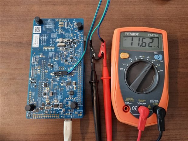

I connected it with some wires to an ammeter. The current is fluctuates between 10mA to 11mA.

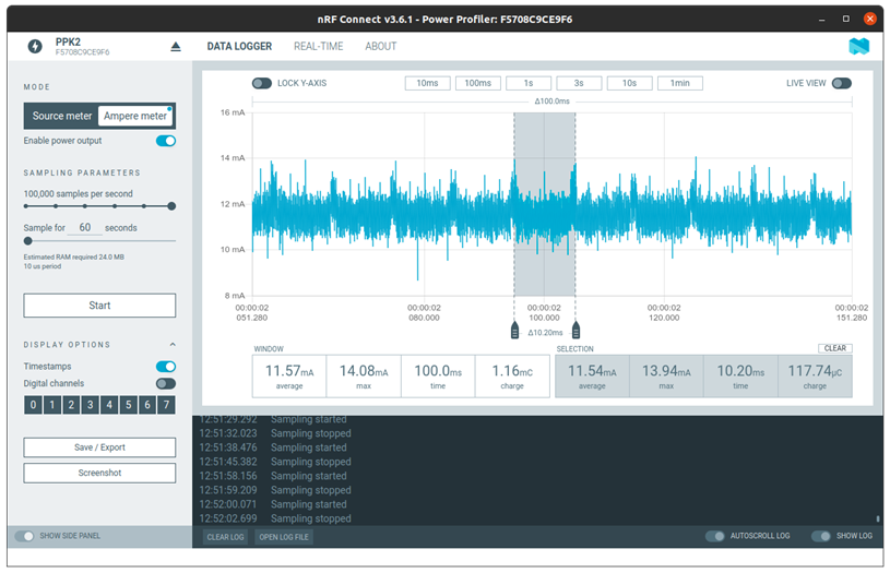

As the current reading is fluctuating, I decided to capture a waveform of the current measurement.

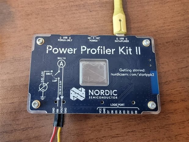

I used the Nordic Power Profiler Kit II (PPK2).

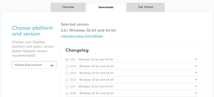

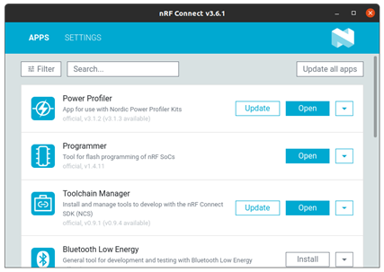

First download and install nRF Connect for Desktop from the official download page.

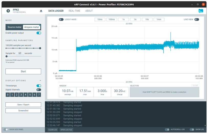

After installing, the program should look like this. Here you can manage the different apps. Open the Power Profiler app to do some measurements.
This is the measurement upon connecting up the board.
As for steady state measurements, after all the initialisation has been done, the device averages at around 11.54mA.
There are distinct spikes every 10ms which corresponds to sampling the accelerometer every 100Hz.

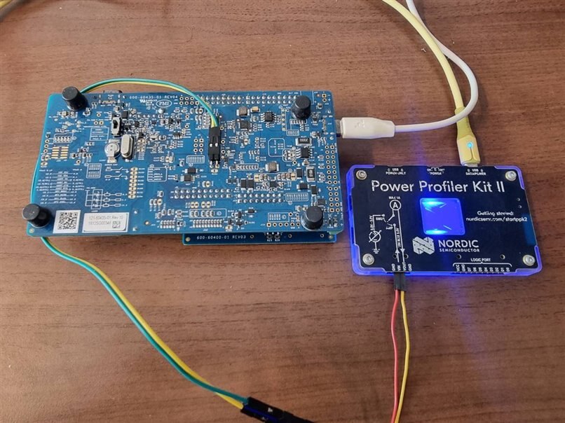

For your reference, this is my connection.
