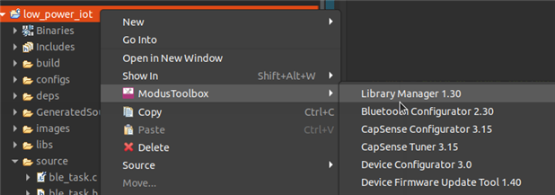

Interfacing with LCD Library

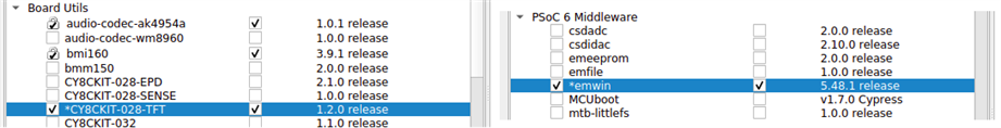

Right click on the project inside Project Explorer > ModusToolbox > Library Manager
Here we will be enabling the low-level library for the display, and a high-level emwin middleware which is a powerful library for creating GUI.
Turn on these libraries:
  • Board Utils > CY8CKIT-028-TFT
  • PSoC 6 Middleware > emwin

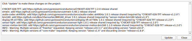

At the bottom, we can also see the changes that are about to be made. In this case, the tool automatically a few extra libraries for us. This is because the shield, in addition to the TFT LCD screen, also incorporates a motion sensor, ambient light sensor and PDM microphone.
Once I'm done with my choices, choose Update at the bottom right. ModusToolbox will process our changes. Click Close once it is successful

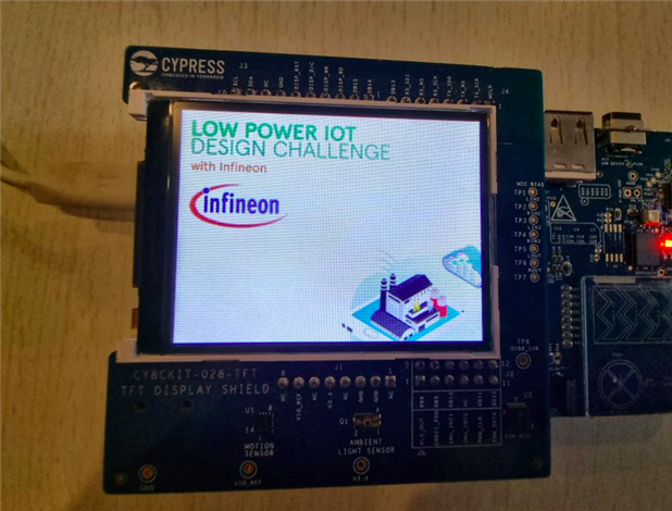

At the top of my main file, I also added a hello world code.
#include "cy_tft.h" // Library for CY8CKIT-028-TFT
#include "GUI.h" // Library for emWin
/* Init the display */
    cy_tft_io_init();
    GUI_Init();
    GUI_SetFont(GUI_FONT_32B_1);
    GUI_DispString("Hello World");
To make it look more professional, I created a bitmap in Paint.
Bitmap
And I generated a bitmap using the emWin generator.
Up until this point, please see my Github diffs. It shows what changes I have made to the code

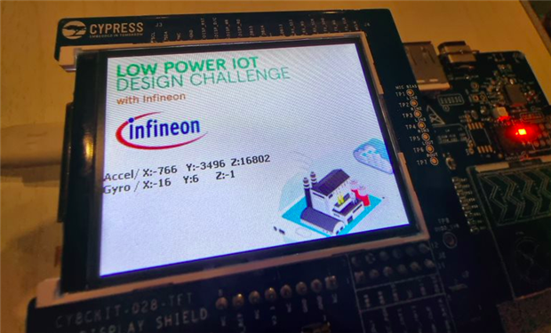

As for the motion sensor, as it is a lot more complicated, I created a new RTOS task to initialise it. Importantly, the BMI160 library depends on some system delays, thus initialising must be done in an RTOS thread after the scheduler has started.
I first initialise the I2C hardware pins, and then initialise the sensor library
    /* Initialize i2c for motion sensor */
    result = cyhal_i2c_init(&i2c, CY8CKIT_028_TFT_PIN_IMU_I2C_SDA, CY8CKIT_028_TFT_PIN_IMU_I2C_SCL, NULL);
    /* Initialize motion sensor */
    mtb_bmi160_t motion_sensor;
    result = mtb_bmi160_init_i2c(&motion_sensor, &i2c, MTB_BMI160_DEFAULT_ADDRESS);
In a continuous loop, I can get the data at a fixed timing. (In this case every 100ms)
        mtb_bmi160_read(&motion_sensor, &data);
        vTaskDelay(100);
        // Get the readings from the `data` struct:
        //   data.accel.x, data.accel.y, data.accel.z,
        //   data.gyro.x, data.gyro.y, data.gyro.z
