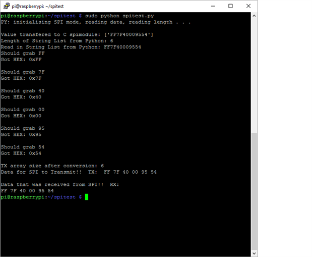

Now let’s run the spitest.py.
NOTE: make sure you have a wire across the MOSI and MISO pins before running the test, as explained in previous post
sudo python spitest.py
You should get a result like this:
As you can see the string has been passed, and separated and then converted to Hex format. Then the data shows you what is going to be sent and what is received. If they are the same, than everything is a success.
