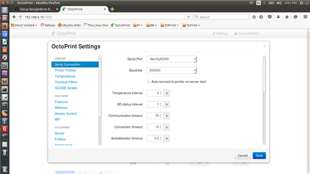

- Now as part of the setting section of OctoPrint, you will have to select your 3D printer serial port and baud-rate as shown in the screen shot below(in my case I am using a Printrbot Simple Metal)

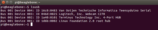

-First check if your webcam is detected by the BeagleBone
   lsusb
   I am using the Logitech HD Webcam (C270)

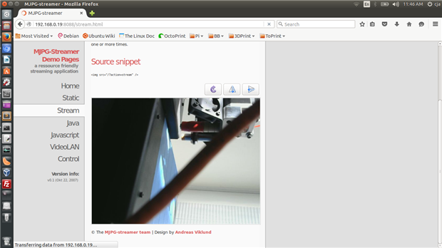

- Now, if you are using the same webcam as I am run the following command
./mjpg_streamer -i "./input_uvc.so -y YUYV" -o "./output_http.so -p 8088 -n -w ./www"
Note: if you are using a different web cam you may have to modify the above command to include the video format of your webcam. To check the video format run
v4l2-ctl --list-formats
If the above command is successful, you should have access to the video feed of you webcam at the url
http://BeagleBoneIPaddress:8088

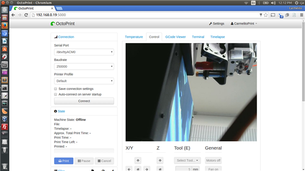

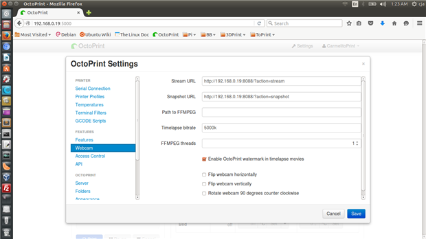

- Now are part of your OctoPrint - webcam setting, setup the Stream URL and Snapshot URL
- Save and reboot the OctoPrint service using the command
sudo service octoprint reboot
Now you should see your webcam stream in the control tab as shown in the screen shot below.

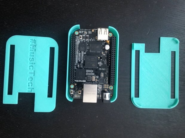

Here are a STL files you can use to 3D print yourself a BeagleBone case
Suggested printer setting
Layer height - 0.2mm
Fill Density - 20 %
