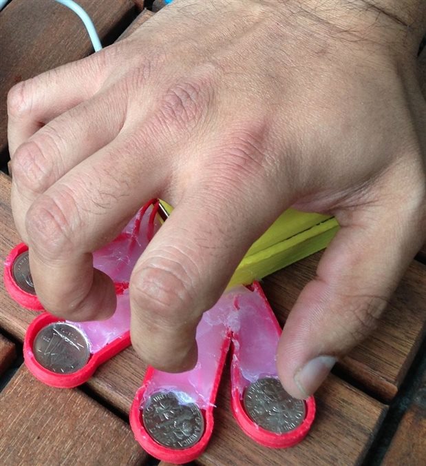

*The picture that you see above is a early version of something I put together using Raspberry Pi model A+ and Adafruit Capacitive Touch HAT for Raspberry Pi - Mini Kit – MPR121, it is called "Raspberry Pi Music Finger" image
Unlike the picture above the DIY drum kit in works , will have a two handed capability which will allow me to have a lot more beats, which means I am going to have to find some interesting ways control the volume and beat changes ..

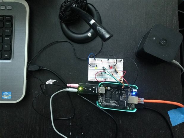

Recording and Uploading music to Soundcloud.com
Check out the blog post for detailed steps to record a wav file using the ALSA arecord and then use the Soundcloud API python wrapper to upload the recorded file to soundcloud
Uploading wav files to Soundcloud.com using the BeagleBone
Here is how the setup looks, you have one button to record sound and another to upload file to soundcloud when pressed

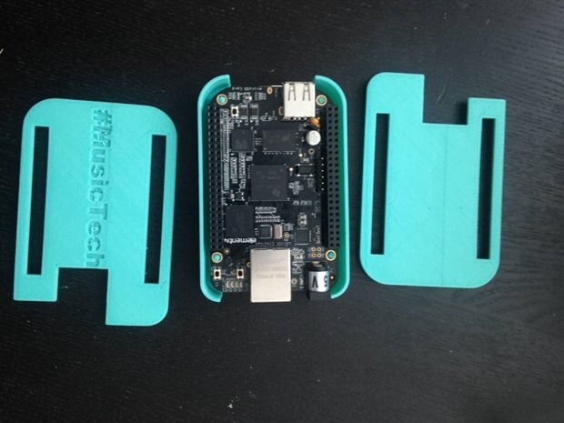

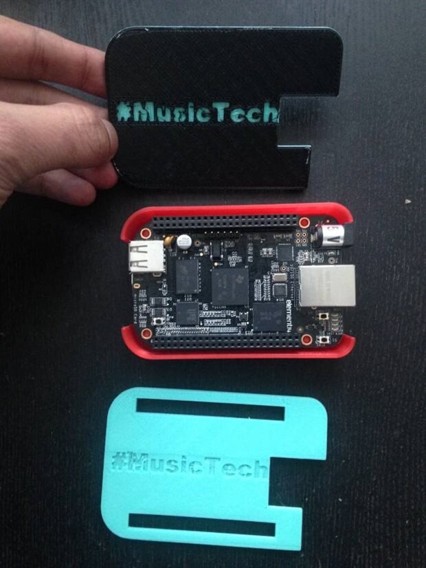

You will also find the STL files for the BeagleBone case, that you can 3D print to protect you BeagleBone at the blog post above.
