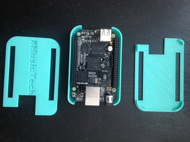

Here are a STL files you can use to 3D print yourself a BeagleBone case
Suggested printer setting
Layer height - 0.2mm
Fill Density - 20 %
