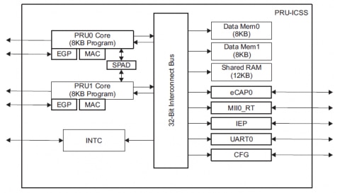

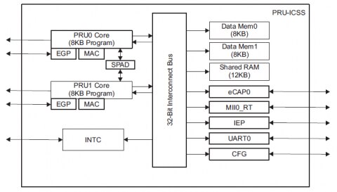

In his first project update post, Elliot laid out the three key components to the project which included Real Time Digital Signal Processing utilizing the two available Programmable Real Time Unit Subsystems on the Beaglebone Black. The next key component to the project was listed as Input Control that featured up to two piezo transducers that would be used to determine the direction of a strum on a guitar string. The third and final key component to the project was listed as a custom PCB that would be used to clean up the input, output, and supporting electronics into a small and tidy package.

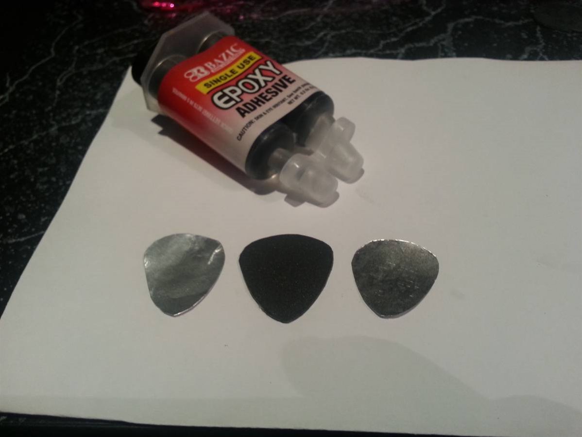

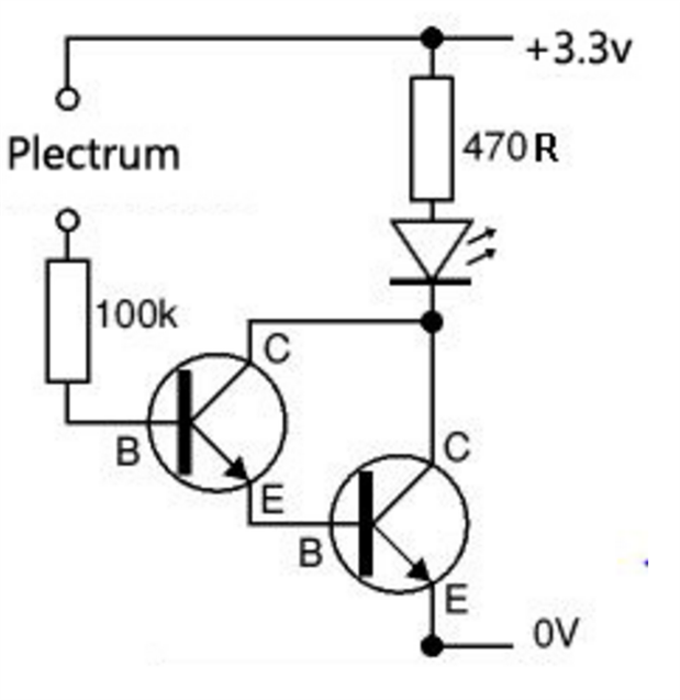

In his second post, Elliot described how he would create a circuit connection using a custom made guitar pick that would feature two conductive sides with an insulator separating them in the middle. This so-called sandwich would have a wire connected to each conductive side, and used to strum guitar strings which were connected to the circuit. When the metal faces make contact with the strings, the circuit is completed, and the signal is fed to an amplification circuit before being converted into MIDI data.
The circuit is fairly simple and contains two resistors, a diode, and a pair of transistors, One leg of the 3.3V side of the circuit is connected to a guitar string, while the other is connected to the custom made guitar pick. A 100k resistor is utilized here to prevent any current spikes from damaging the delicate circuitry of the Beaglebone Black. The two transistors in the circuit serve as an amplifier that raises the signals voltage to a level that can be used to trigger the Beaglebone Black.

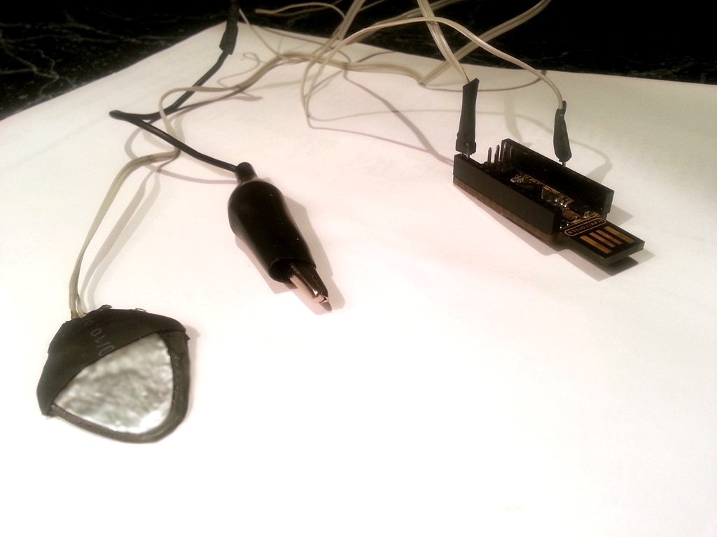

This brings us to today. After his last post, Elliot began the waiting game on the rest of his challenger kit to arrive. Unfortunately the Beaglebone Black has yet to arrive, and we have just two weeks left in the challenge. This has forced Elliot to continue forward with the project, but at a much more limited level. Elliot will be offloading the effect processing to a desktop PC that is running a DAW.
This will allow the LeoStick to act as a controller mechanism that will be used to pass HID compliant MIDI data to the DAW. The hardware for the project has also been greatly simplified, and now consist of the LeoStick, an alligator clip, and a guitar string. Good luck Elliot, and we can’t wait to see the finished project!

After a couple of weeks of absence, Elliot posted the final update to Project PlectralEffects on April 10th. The project was capped off with a final, quite impressive, demonstration of the project in full working order. Elliot mentions that he did have a few hurdles to overcome, with one being a good understanding of how the MIDI Clock works. “The main challenge for me in implementation of the enveloped effects was gaining an understanding of MIDI Clock,” Elliot said. “The effect mode is varied between two states, depending on which side of the plectrum is used. Effects are tempo synced to the DAW and are in time with beats.  MIDI Clock generates a byte 0xF8 at exactly 24 pulses per quarter note.  The envelope effects are sinusoidal calculated at 1/24th of a 1/2 wave, or 0.130899 radians to keep in time with the MIDI Clock.”
Despite the Beaglebone BlackBeaglebone Black from the official challenger kit never arriving, Elliot managed to complete a fully functional musical instrument using the LeoStick, a custom made, double sided, metallic guitar pick, and some clever coding. While he did not make the top 3, I want to give a huge shoutout to Elliot for continuing to push this project forward despite several large obstacles. His drive to compete in this challenge has inspired myself, and I am sure that the same is true for many others. This was simply a wonderful project to follow, and I truly hope to see Elliot in future challenges!
