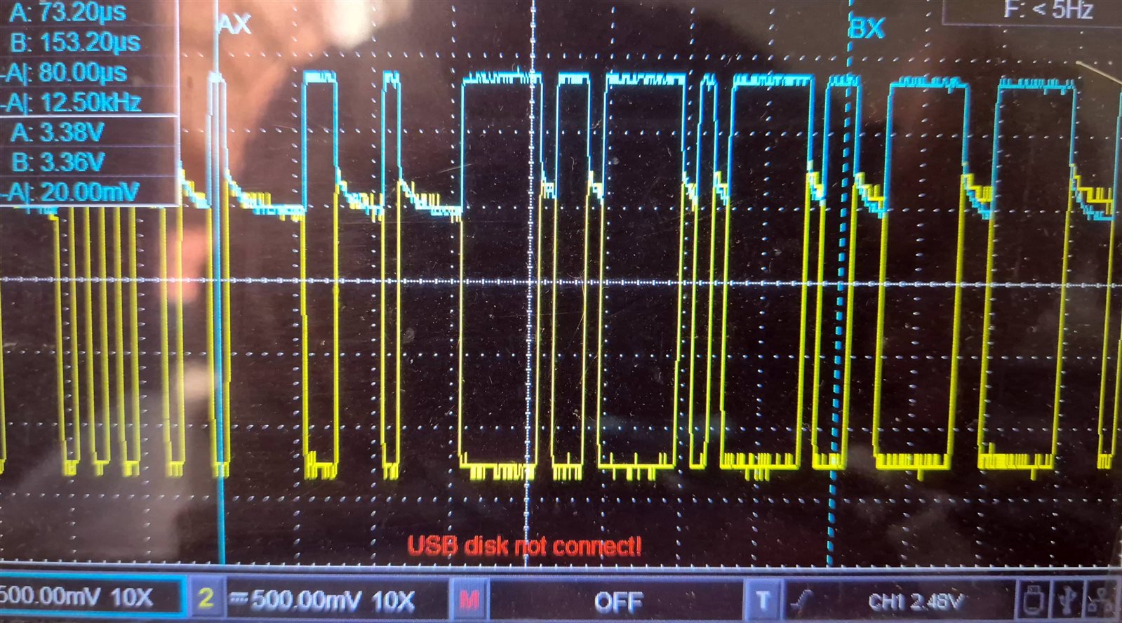

Loopback mode runs a stress test. All 10 frame types are sent as fast as the CAN peripheral can push them - roughly one frame per millisecond - and the firmware waits for each echo before sending the next. If the byte stream matches exactly, the LED stays on. If anything corrupts, it goes dark. Running this for roughly an hour gives me confidence the pack and unpack functions are symmetric. Truth be said, i stress tested because I wanted to see the limits out of pure curiosity.
Normal mode transmits at the actual needed frequency. One second pulse ticks at 1 Hz and sends all four fast frames. Every five seconds the medium frames go out. Every ten seconds come the slow frames. This matches the data collectors which do not need constant reads anyway.

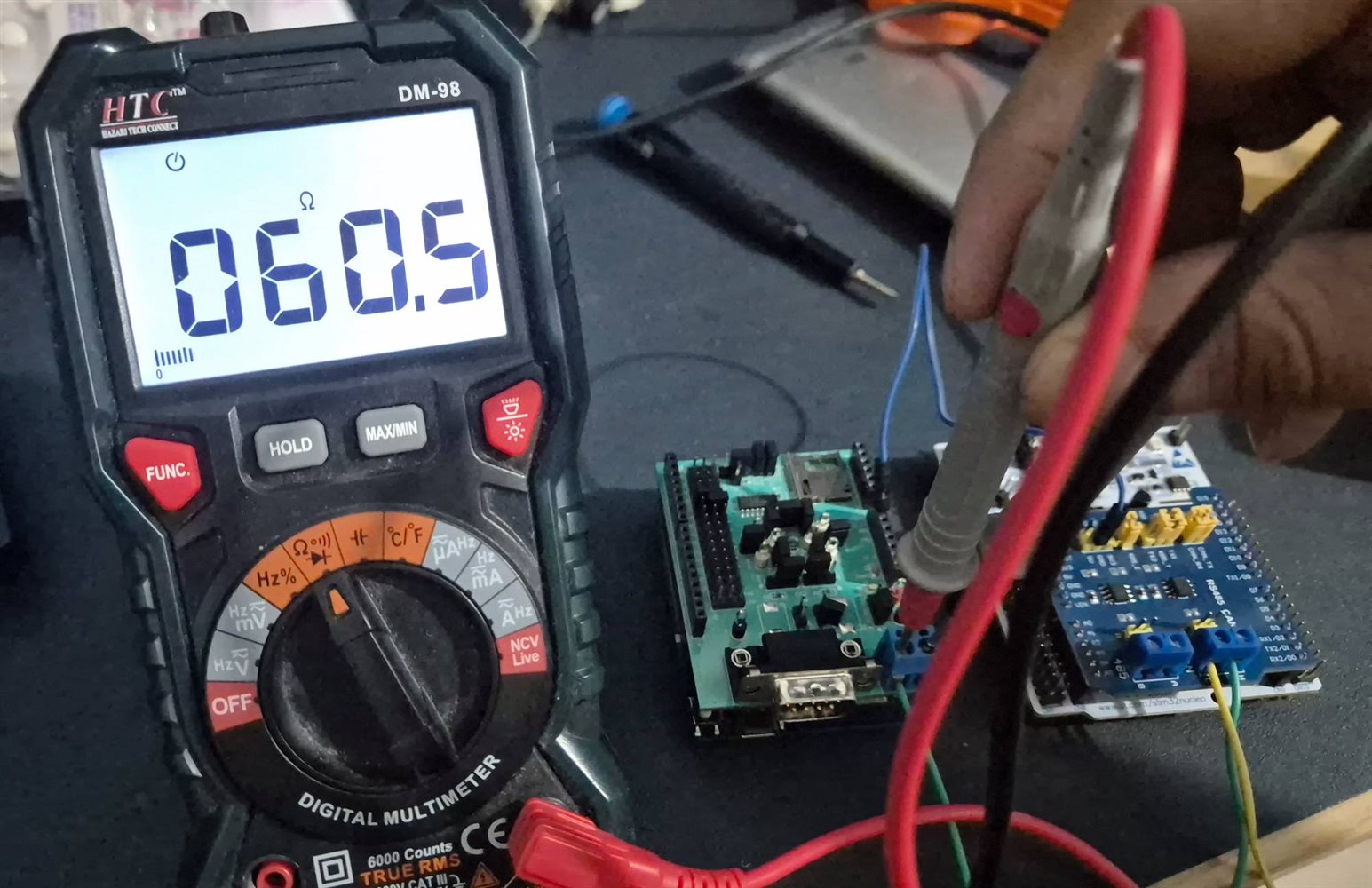

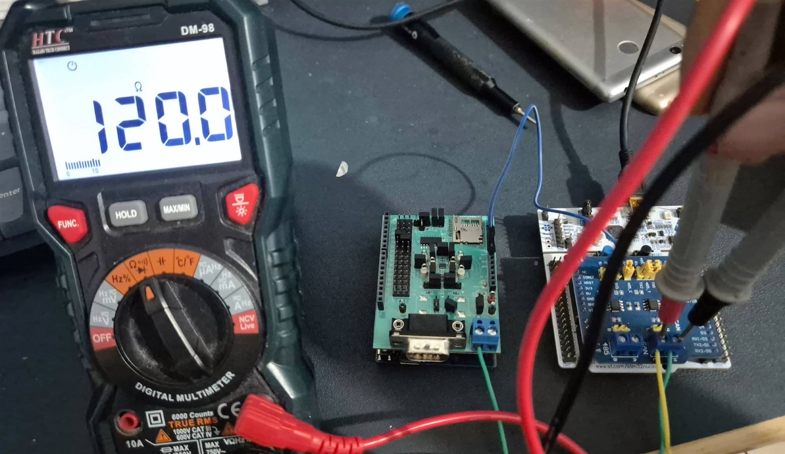

The F103 Nucleo uses the Waveshare RS485/CAN Shield which sits on top and breaks out the CAN TX and RX lines. This shield has an onboard 120 ohm termination resistor already built in.

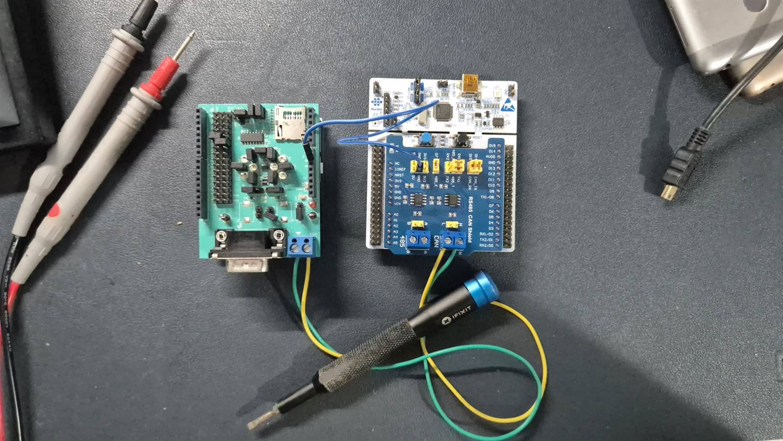

The Arduino Q runs the MAX33041EVAL shield which also has CAN transceiver circuitry. When i first connected the two boards, nothing worked. Frames were not getting through at all.
I added a common ground wire between the two boards since CAN is a differential bus and needs a shared reference. That did not fix the communication, but i kept it  anyway.
The real issue was the termination resistors. I pulled out the multimeter and checked. The Waveshare board measured 120 ohms. The MAX33041EVAL measured 60 ohms.  Google Search AI said "Having different termination values on the same bus creates an impedance mismatch - the signal reflections get mangled and frames corrupt or disappear entirely."
The MAX33041EVAL has jumpers that can change its termination. I adjusted them to disable the 60 ohm termination and enable 120 ohm instead, matching the Waveshare side. Once both sides had 120 ohm, communication became rock solid immediately.
Here are the multimeter readings that showed the problem and the fix:
On the Waveshare CAN Shield
On MAX33401EVAL Board with default Jumpers
On MAX33401EVAL Board with changed Jumpers
Jumper Details as per: https://www.analog.com/media/en/technical-documentation/data-sheets/max33041eshld.pdf
The star mark refers to the default position of jumpers when shipped. So I had to just change the position of the JU7 and JU8

  1. Mount the Waveshare RS485/CAN Shield on the F103 Nucleo
  2. Mount the MAX33041EVAL shield on the Arduino Q
  3. Configure the MAX33041EVAL jumpers to disable termination (check the datasheet for which jumpers)
  4. Wire CAN_H and CAN_L from the Waveshare board to the MAX33041EVAL board via shielded twisted pair
  5. Compile and flash both boards
  6. Open two serial terminals one directly, and the other via SSH terminal of ArduinoQ. Still using the same python script as in my Part 2
The F103 prints what it is sending. The Arduino Q prints what it is receiving. If both match line by line, the protocol is working. If frames are getting dropped or corrupted, check that the jumpers on the MAX33041EVAL are set correctly.
Here is a video captured using another App i am experimenting OBS studio. It did allow me to capture just the windows i am interested in without showing others.
