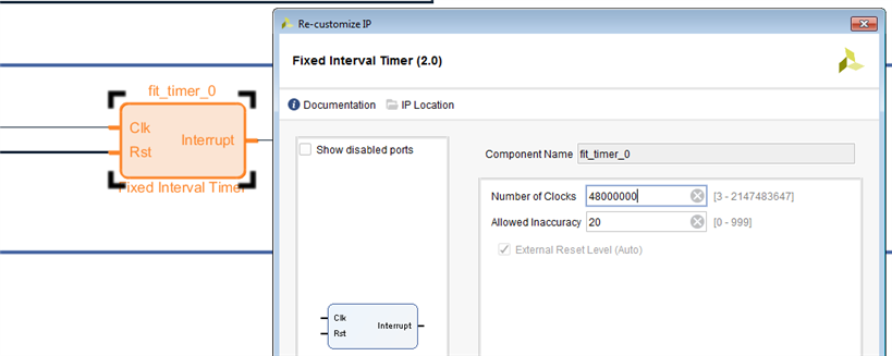

My project was supposed to be a line follower, but I had to limit the scope to just the sensor array as I talked about in the previous blog post. I spent a number of days trying to run with external hardware using an ADC to read the line sensor array; but for the life of me, I couldn't get the I2C bus to work. I continually got compiling errors in SDK relating to an interrupt library:
fatal error: xintc.h: No such file or directory
I wasn't able to find any example code that I could start with as a base.
My project ended up being an Timer Interrupt library based in the FPGA fabric. It generates an interrupt every "N" clock cycles; and I mapped it to the 48 MHz clock. This interrupt then feeds into the interrupt concatenator as interrupt #0. This still is relative to what I had wanted to do, but much much farther away from where I wanted to be.
I used the IP Library to find new IP and import into my hardware design. I then exported the hardware and made a new workspace & BSP in the SDK utility. I started with some base code in the SDK and got it working with my new hardware to run things. So I'm using both the PS + PL. I had to re-map the interrupt which was used in the base program to the one generated from Vivado.
This project uses the PWM LED dimmer as a base code for the PS side of things; but modified. When the FPGA Fixed Interval Timer ("FIT") generates an interrupt, it is captured in the PS running my code. We keep count of the number of interrupts and use that to run the PWM signal back out to the real world.
Here is the functional part of the ISR that does it:

    I found the problem,actually it is not simple to explain because the Example code is based on ML300 board , they used : #include "xintc.h" where as we need to use #include "xscugic.h" for Interrupt Controller
    Similarly we need to modify a number of Macro and Calling Functions such as:
    Given                                                             Needed to be Replaced By
    XPAR_INTC_0_DEVICE_ID                    XPAR_SCUGIC_SINGLE_DEVICE_ID
    XPAR_INTC_0_IIC_0_VEC_ID               XPAR_XIICPS_0_INTR
    XIntc InterruptController                         XScuGic InterruptController
    and soon.....
    then we need to change the functions with the parameters based on the prototype , thats why i said it is bit complex.
