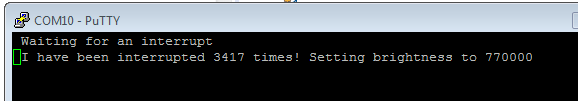

My project ended up being an Timer Interrupt library based in the FPGA fabric. It generates an interrupt every "N" clock cycles; and I mapped it to the 48 MHz clock. This interrupt then feeds into the interrupt concatenator as interrupt #0. This still is relative to what I had wanted to do, but much much farther away from where I wanted to be.
I used the IP Library to find new IP and import into my hardware design. I then exported the hardware and made a new workspace & BSP in the SDK utility. I started with some base code in the SDK and got it working with my new hardware to run things. So I'm using both the PS + PL. I had to re-map the interrupt which was used in the base program to the one generated from Vivado.
This project uses the PWM LED dimmer as a base code for the PS side of things; but modified. When the FPGA Fixed Interval Timer ("FIT") generates an interrupt, it is captured in the PS running my code. We keep count of the number of interrupts and use that to run the PWM signal back out to the real world.
Here is the functional part of the ISR that does it:
void PWMIsr(void *InstancePtr)
count += 1; // add one to the counter
brightness = (count % 10)* 110000; // count modulus 10, multiplied by 110000 to normalize with the clock
xil_printf("\033[2K I have been interrupted %u times! Setting brightness to %u \r", count, brightness);
Xil_Out32(PWM_BASE_ADDRESS, brightness);//write value to PWM controller back in the PL
This code is still related to the project I wanted to do. I spent hours trying to create the part of the line follower which reads a wheel encoder and provides feedback about the speed of the robot before I settled on this as a start. Since this has a consistent time-based interrupt, I could use it to periodically check a counter to calculate the frequency of pulses; which correlate to speed. The output of this would then feed into a PID loop to adjust the PWM signal going out to the wheel motor based on the speed delta.
I can say that this has been very tough challenge as I don't have any background with FPGAs. Although this project is hardly earth shattering in terms of complexity, but it does demonstrate that the training has actually given a total beginner enough knowledge to perform some basic tasks. As stated above, this does make use of both the PS + PL, and both Vivado and the SDK were required to make all of this work. I had to find & import IP on my own, re-wire the block diagram, export a valid bitstream; then import to SDK and write [well, ok, 'modify'] a corresponding program. I have gotten much better at navigating the interfaces now that I'm doing it on my own. I decided that I like the automatic build when you save a file in SDK. One other nice thing as stated in a previous blog was the System Debugger lets you edit code and upload right from the deugger; which made it much faster and easier to develop. I thought at first that this would be annoying; but when running the debugger I can edit code right there, hit save (which generates a new build) then restart the deubgger immediately. I'm really curious what shortcuts are available on this platform to speed up hardware debugging because using the FPGA side to alleviate pressure on the ARM processor would be amazing and key to the line follower that I would like to build with this.
