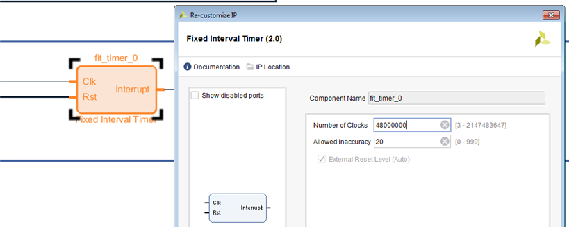

My project ended up being an Timer Interrupt library based in the FPGA fabric. It generates an interrupt every "N" clock cycles; and I mapped it to the 48 MHz clock. This interrupt then feeds into the interrupt concatenator as interrupt #0. This still is relative to what I had wanted to do, but much much farther away from where I wanted to be.
I used the IP Library to find new IP and import into my hardware design. I then exported the hardware and made a new workspace & BSP in the SDK utility. I started with some base code in the SDK and got it working with my new hardware to run things. So I'm using both the PS + PL. I had to re-map the interrupt which was used in the base program to the one generated from Vivado.

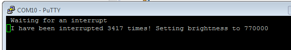

This project uses the PWM LED dimmer as a base code for the PS side of things; but modified. When the FPGA Fixed Interval Timer ("FIT") generates an interrupt, it is captured in the PS running my code. We keep count of the number of interrupts and use that to run the PWM signal back out to the real world.
Here is the functional part of the ISR that does it:
void PWMIsr(void *InstancePtr)
count += 1; // add one to the counter
brightness = (count % 10)* 110000; // count modulus 10, multiplied by 110000 to normalize with the clock
xil_printf("\033[2K I have been interrupted %u times! Setting brightness to %u \r", count, brightness);
Xil_Out32(PWM_BASE_ADDRESS, brightness);//write value to PWM controller back in the PL
