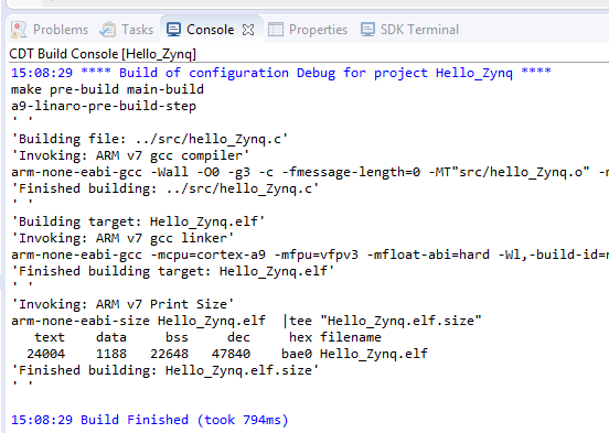

To start with, we will create our own application with File --> New --> Application Project. We are given the opportunity to start with a canned project templates, but will choose "Empty Application" instead. This will create an empty "C" file in our source folder. The next step is to cheat a little bit and pull in the example code for "Hello World." We navigate to our System.mss file; which as described in the previous blog post; contains links to import example code for each (known) included library. These are provided from Xilinx as a jump start for each peripheral.
So the instructions have us find the examples directory via the 'Import Examples' and then copy-paste the source code from HelloWorld C file for the UART. This is pasted into our empty application called "hello_Zynq.c". Once this file is saved, and automatic build is done by the SDK to verify that our code is OK. Thankfully; this can be disabled from the menu bar (Project --> Build Automatically) Auto builds can very often result in heaps of errors when someone is very deep into making lots of changes and starting new code from scratch as not all the code is written yet. Even as the lessons brought me through this section the very first automatic build fails because our empty program contains no "main()" loop.
The console window at the bottom of the screen provides a running output of what is happening in the background as you are working; and here shows the result of a successful build.
