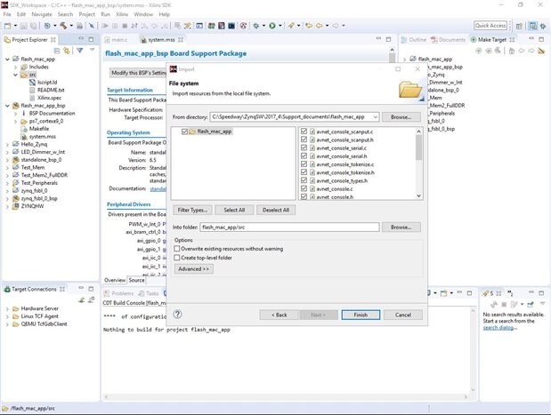

In this lab, an application which reads and writes MAC address (EUI-48 only) configuration data to/from the on-board QSPI Flash device is explored. For more information on what a MAC
address is and why you might want to use one in an end application; More details on Wikipedia: http://en.wikipedia.org/wiki/MAC_address
The code for this lab was already provided in the training as supported documents.

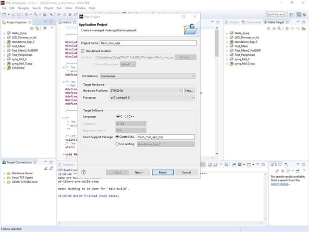

Setting up the new SDK application project to run the code as below

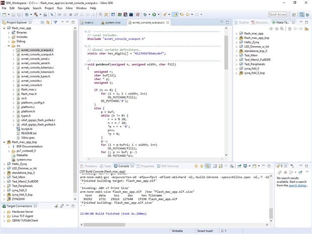

Fig Above: The compiled flash code shown

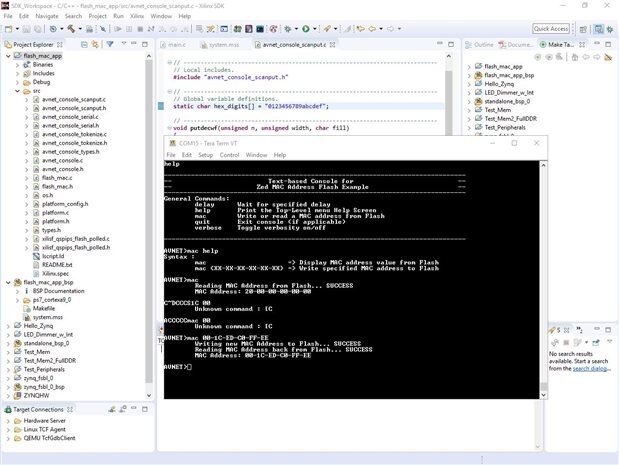

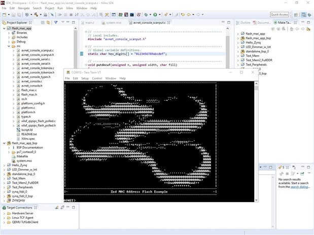

Playing around with the output as below
