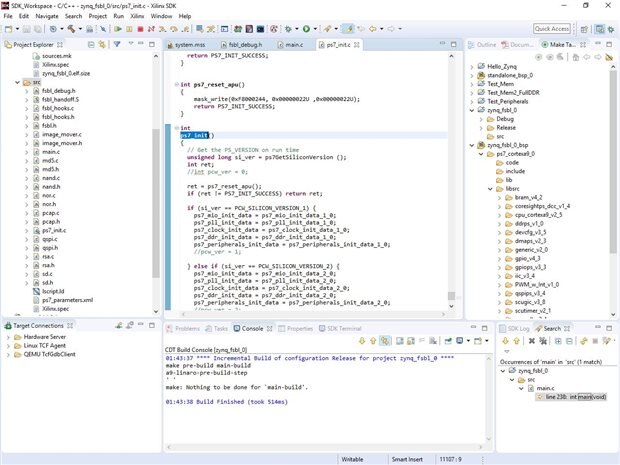

• What the FSBL application includes
• How to recognize some of the initialization sequences

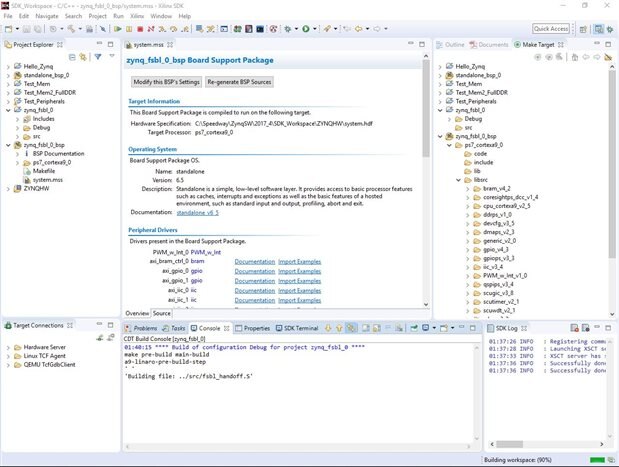

This is my first time working with the xilinx FSBL and using the bootloader for zynq.

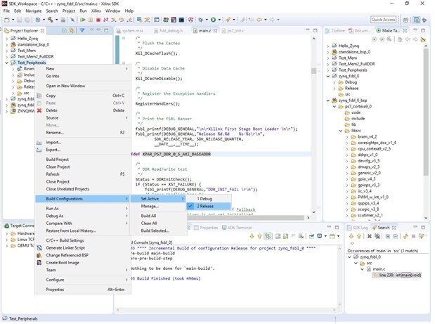

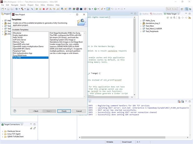

Using the standard template to run the xilinx FSBL

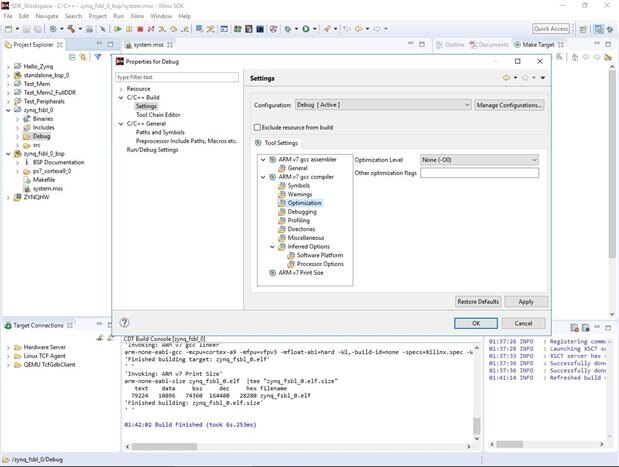

Building the xilinx FSBL
Looking into compiler settings for the Debug configuration

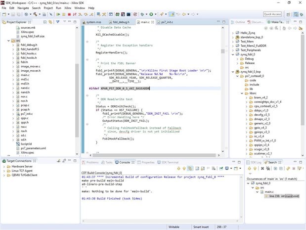

Understanding the main code of the FSBL
Fig: DDR Initialization Check  can be seen here

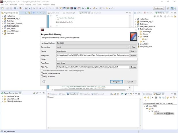

Aim: Developing Zynq Software with Xilinx SDK Lab 7 Boot from Flash
In this lab I created a boot image and boot an application from non-volatile memory. A complete boot-up requires at least three things:
1. FSBL
2. Bitstream (Optional)
3. Application

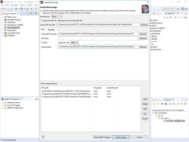

Using the Test_Peripherals application from previous development for booting from Flash memory
Creating a new boot image and set the output format to MCS

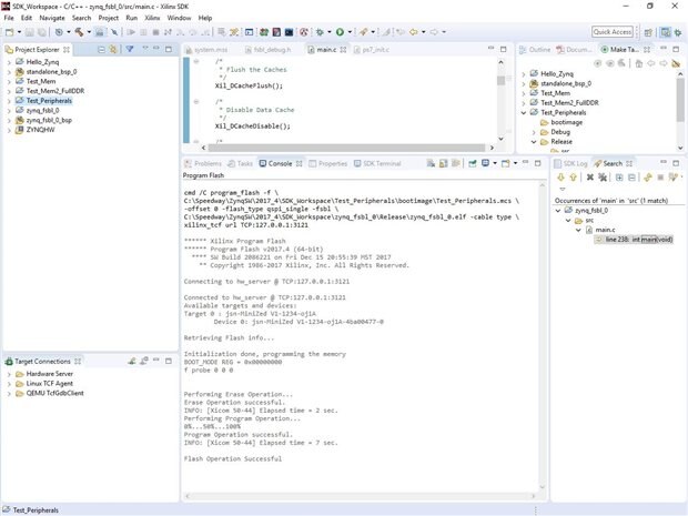

Setting up to program the Flash memory
Successfully programmed the flash memory

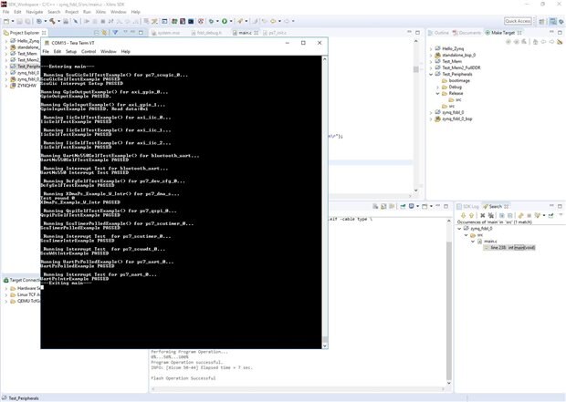

Testing with the serial port the results after booting from Flash memory
