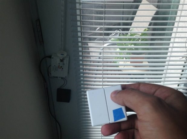

Here is a video demo of the blinds opening and closing in action, using the EnOcean Push button..

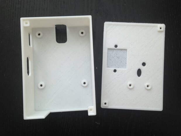

3D print the STL files attached below to hold the Raspberry Pi B+ and the motor driver. And also print a holder for the gear motor and mount for the blind's turning rod.
Here are the slicer setting I used on my Flashforge creator pro
Layer height - 0.3 mm
Infill density - 20%
Temperature - 205 C (i am using Hatchbox White 1.75mm PLA )

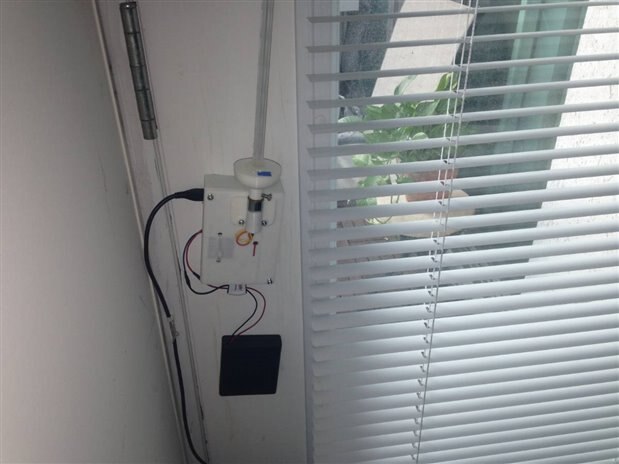

Final setup of the with the 3D printed parts + Raspberry Pi with the EnOcean Transceiver module+ Gear Motor attached to roller rod of the blinds.
3D printed base holder for the Raspberry Pi B+..Parts designed in Autodesk Fusion 360
3D printed base and top, that is the case for the Pi and the EnOcean Transceiver module

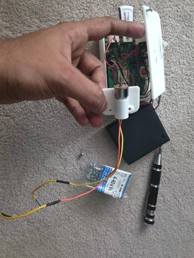

Putting the Circuit together

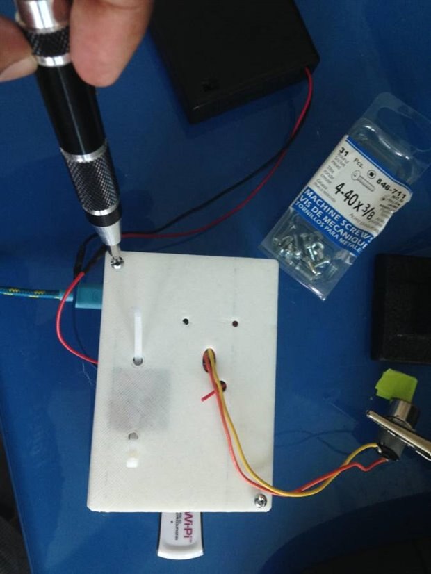

Adding zip tie to hold the motor driver, and adding screws to hold the 3D printed parts together..

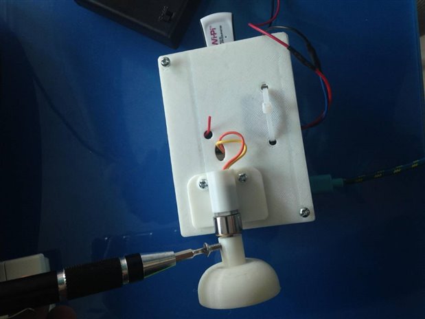

Adding the motor to the 3D printed part
Adding 3D printed motor mount, ensure that the screw lines up with the notch in the gear motor.
Mount your setup on the wall next to the blinds and test it using an EnOcean Push button..
In addition to 3D printing the STL's attached , we will also need a zip tie to hold the motor driver to the 3D printed part as shown in the picture above.
And 4-40x3/8 screws to fit all of the 3D printed parts together
Hot glue to add the blinds rolling rod to the motor mount and screws and a drill to mount the parts to the wall ..

    carmelito over 10 years ago in reply to DAB
    Thanks DAB, I dont see the Pi B+ get too hot, I just have the program+FHEM server running , have it running for a full day now ..Planning to run it for a week, which mean I will post an update back, if i see it warp/melt the 3D printed enclosure image... Hoping and praying  it doesn't !! image
