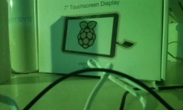

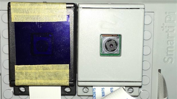

As explained last week I added the infra-blue filter in front of the Pi NoIR Camera, in order to get rid of the red part of the scene.
Then I wrote a small Python program which grabs a color image and converts them to GNDVI and BNDVI:

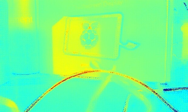

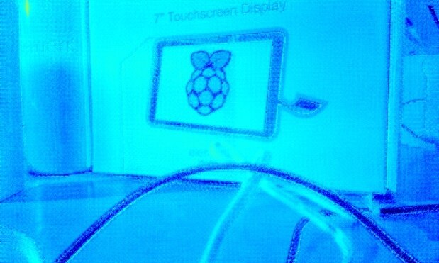

The range of the original NDVI images is -1 to +1. In order to display this properly I converted these values to the range 0-255 and applied a colormap such that NDVI value 0 is green, -1 is blue and +1 is red:

Unfortunately at the time of writing sunset has passes already two hours ago, so I couldn't image the plants in my garden.
The only  agricultural stuff I could image was a raspberry:
Color image: (note how green it is due to filtering out the red)
GNDVI:
BNDVI:
