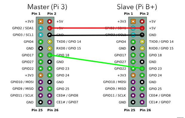

In the previous post I explained how the two cameras are combined, using the master and slave Pi. Here I will show how the two Pi's are connected hardware wise, and how the two images are taken simultaneously from the two systems.
Hardware setup
The power for the Pi B+ comes from the Pi 3's header block, as shown in the image below.
I wrote some python code which will run on the slave system. It will wait for a trigger pulse on GPIO 23 and then take an image and save it on the share as described in the previous post. The master system will output the trigger on GPIO 18.

Below is the python code which runs on the slave system, it is based on an example I found on the internet (camera - Problems triggering via GPIO - Raspberry Pi Stack Exchange).
If not done already rip.gpio needs to be installed:
sudo apt-get install python-dev python-rpi.gpio
slave_camera.py:

In order to start this script on every boot, I added it to /etc/rc.local:
#!/bin/sh -e
# rc.local
# This script is executed at the end of each multiuser runlevel.
# Make sure that the script will "exit 0" on success or any other
# value on error.
# In order to enable or disable this script just change the execution
# bits.
# By default this script does nothing.
# Print the IP address
_IP=$(hostname -I) || true
if [ "$_IP" ]; then
  printf "My IP address is %s\n" "$_IP"
fi
python /home/pi/planthealthcam/slave_camera.py &
exit 0
