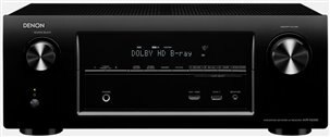

My AV receiver is Denon AVR-X2000. CEC support on this device is limited, but luckily there is an API. Unfortunately, the API is not documented, but by using the web interface I could reverse engineer it. While it's starting up there are some quirks though as it can take quite a while before the Denon is reachable through the API (while it already works by manually pressing the power button). Because of this we'll use a combination of both CEC and the API.image
Firstly lets create the Receiver class itself. It's a implementation of MqttSwitch, so the CEC part is easily taken care of. We do override the on() method to make sure it's only fired when needed as this command toggles the power status for the Denon. To get more detailed information on the status and to change volume and inputs we use the API. The API calls are performed by a DenonCommand.

Due to the time limitations I won't go into the implementation of the API in this post. If you would like to find out more details about this topic, there is a valuable article by Open Remote describing the key possibilities.
