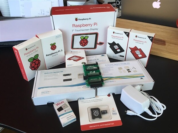

Last week I explained how I'm using Chef to provision my Raspberry Pi's and the recipes in my Thuis cookbook. Back then I didn't have a Raspberry Pi 3 yet, so I tested it on an older model. This week the kit arrived, so I'll bring the bootstrapping in practice on the Raspberry Pi 3! Not everything went as expected, so this is a good subject for this blogpost.
The Kit
Installing the Raspberry Pi 3

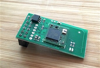

Complication 2: For Z-Way bluetooth needs to be turned off
The RazBerry uses the serial IO pins on the Raspberry Pi, the same are used by the built-in Bluetooth connection as well. To be able to use the RazBerry and run Z-Way, Bluetooth has to be disabled. The original install script takes care of this, but after I converted it to be used in a Chef cookbook this didn't work anymore. That's why I converted these commands to Ruby blocks in my Chef recipe now. This looks as follows:image

Basically this deletes the serial connections from /etc/inittab and /boot/cmdline.txt and adds an option to /boot/config.txt to disable Bluetooth.

  • fvan
    fvan over 10 years ago in reply to georgekav +3
    Using the "enable_uart" property, as I did, the UART0 can again be used for serial communication with any HAT, like EnOceanPi. The BT is then moved to the miniUART, and is still usable. No need to cripple…
  • fvan
    fvan over 10 years ago +1
    Did you try the "enable_uart" property in the "/boot/config.txt" ? It restores the UART, and keeps the BT operational. The UART interface is then "ttyS0" instead of "ttyAMA0" though. It's described in…
  • georgekav
    georgekav over 10 years ago in reply to fvan +1
    I had also to disable bluetooth and remap uart for the enocean pi to work properly using the hardware uart0 like rhe123 . Also basically the recommended by enocean (paper titled: Raspberry Pi talks EnOcean…
  • fvan
    Did you try the "enable_uart" property in the "/boot/config.txt"? It restores the UART, and keeps the BT operational. The UART interface is then "ttyS0" instead of "ttyAMA0" though.
    It's described in my EnOceanPi paragraph: https://www.element14.com/community/community/design-challenges/pi-iot/blog/2016/06/14/pi-iot-alarm-clock-05-enocean-sen…
    Frederick
  • georgekav
    I had also to disable bluetooth and remap uart for the enocean pi to work properly using the hardware uart0 like rhe123.
    Also basically the recommended by enocean (paper titled: Raspberry Pi talks EnOcean dated March 2014 12pages),  "rpi-serial-console disable" command is not any more valid due to /etc/inittab replacement by systemd.
    On the contrary I found the white paper "Raspberry Pi talks EnOcean" dated April 2016 14pages that explicitly recommends to disable the bluetooth because it used the uart. So it's not the problem of kernel console to be interfering (which you correctly disables in the boot config) but also the bluetooth pushing asynchronous messages in UART0. From my understanding the new device tree overlays are not only disabling the bluetooth but also remapping the UART0 MPU pins to the usual I/O header pins.
    Finally take a look here https://github.com/raspberrypi/firmware/commit/845eb064cb52af00f2ea33c0c9c54136f664a3e4  the maintainers state the need of the dto for use of the regular hardware UART0. Maybe without that fvan you are using the UART1 (according to this https://openenergymonitor.org/emon/node/12311 )?
    sorry for the long post image
  • fvan
    No need to cripple the Pi to get both working, as described in the RPi forums: https://www.raspberrypi.org/forums/viewtopic.php?f=28&t=141195
  • fvan
  • georgekav
    They claim mixed results in that link in fact. For some it is not enough.
    I looked here
    https://www.raspberrypi.org/forums/viewtopic.php?f=107&t=138223
