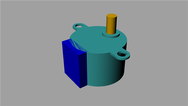

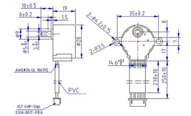

The easiest way to design the base and position the  GearBest stepper motors has been creating them with CAD and inserting in the Art-a-tronic model design.
Based on the motor sizes from the data-sheet a 3D CAD model has been designed as shown in the image below

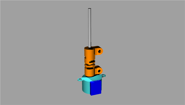

The design has been simplified keeping the correct dimensions as in the real device. The following images show the motor with the 3d printed flexible joint when it is assembled.
According with the other parts sizes and heights the M3 threaded bar generating the vertical movement of the moving components will be 7cm.

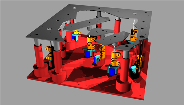

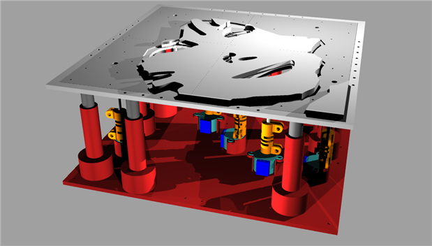

The all-layers structure as they will be when assembled.

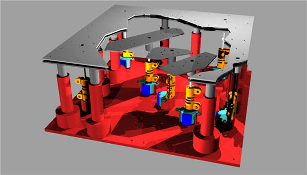

Top support removed. Note the moving supports (upper gray) that will be on top of the support and the fixed supports parts (lower gray) connected to the base columns

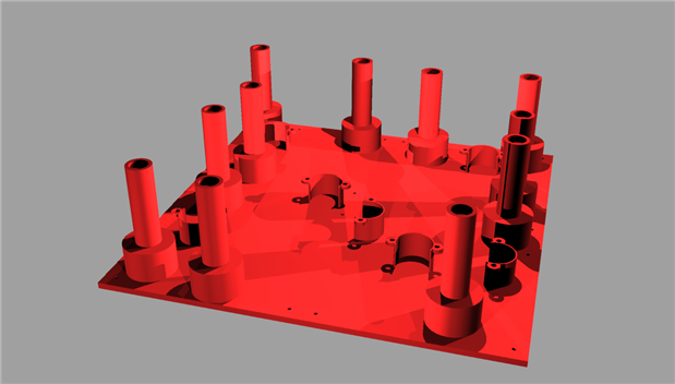

The fixed supports. Note that the base links are also the moving top parts supports for the cylindrical guides

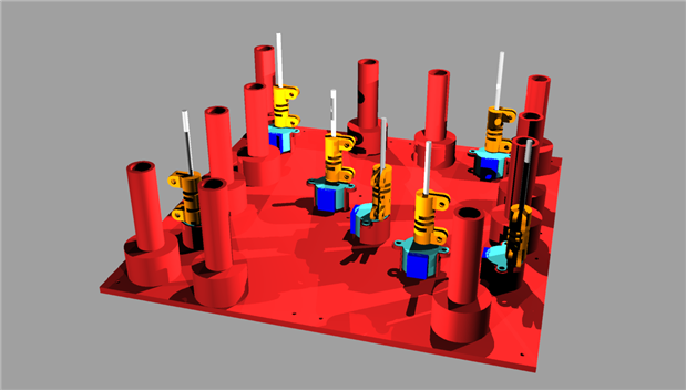

The base with the fully assembled motors in place

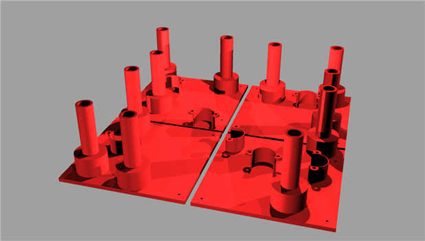

The base support
The base supports. Note that the full base is divided in four sectors as well as the top building.
