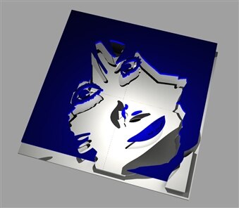

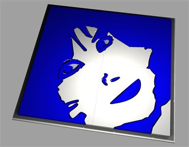

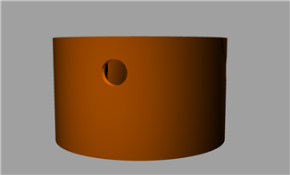

The Art-a-tronic animatronic (see the previous posts PiIoT - The perfect reading place #7 [tech]: Art-a-tronic, mechanic design and PiIoT - The perfect reading place #6 [tech]: Art-a-tronic, performing the new opera for details) is built with seven moving components as shown in the images below:

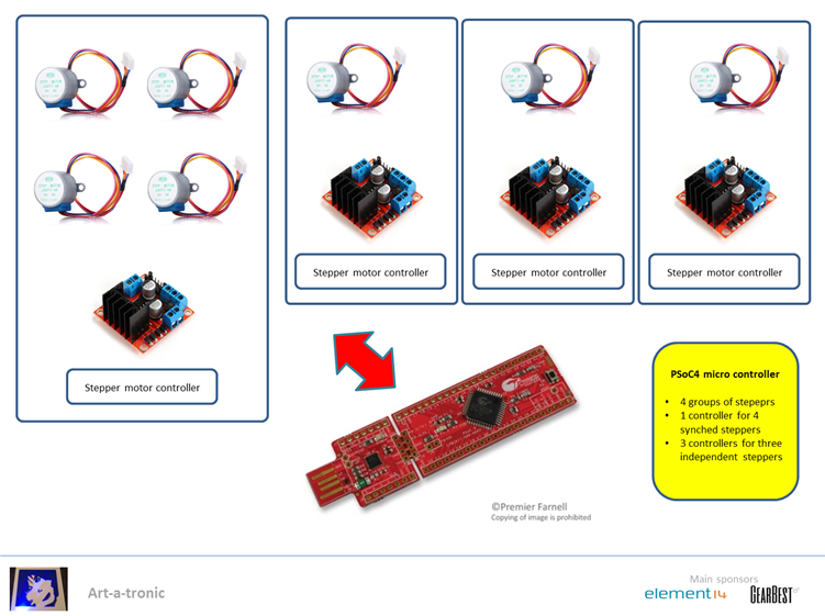

The entire 30x30 cm structure has been designed as a series of four modules to be joined together due to the plan surface limitations of the 3D printer. Thus every moving part will be controlled by a stepper motor, as shown in the scheme below.
Stepper motors as linear transducers
Every blue part of the animatronic will change its height when it is moved, so seven GearBest stepper motors have been used to make as many linear transducers; one for every moving part. The four synched parts uses a single controller to generate the steps. The movement is controlled by a Cypress PSoC4 micro controller acting as the main unit for the sensors (will be discussed further) and the motors.

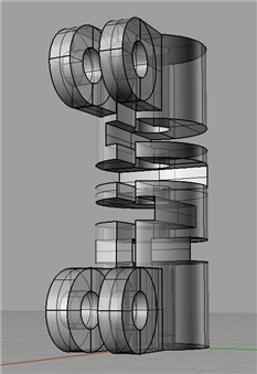

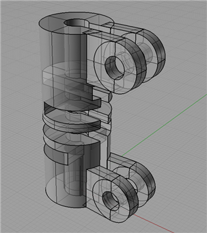

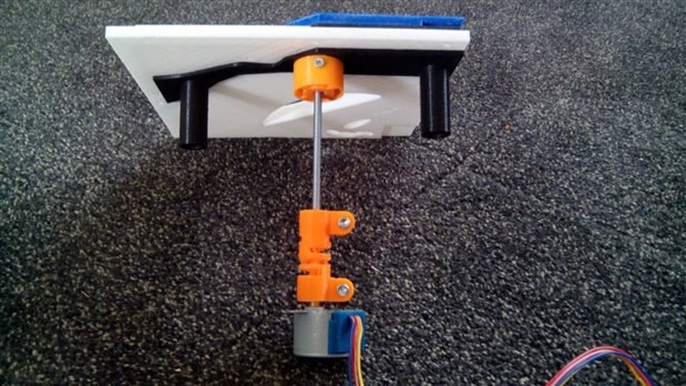

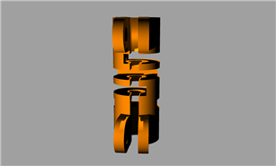

The motor joint design

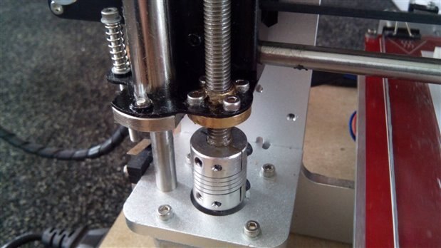

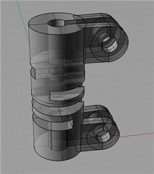

The threaded vertical shaft of the transducer is coaxial to the stepper axis shaft and needs a flexible joint: its role is to fix firmly the two aligned components and give a minimum of flexibility to prevent excessive mechanical stress.
A motor joint used in many 3D printers z-axis movementimage

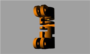

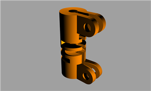

Due to the large number of joints needed for this project - the complete set of moving parts involves about 100 of them - it was worth to design a custom one with some structural changes to make it printable.
The images below show the rendered CAD model
The same principle of the analog Aluminium component has been kept: robust and flexible able to lock the two coaxial components.
The following semitransparent images show how the internal part is designed; the stepper motor shaft has a different diameter than the M3 threaded bar used for the vertical movement.

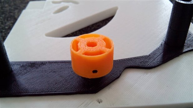

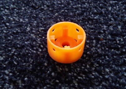

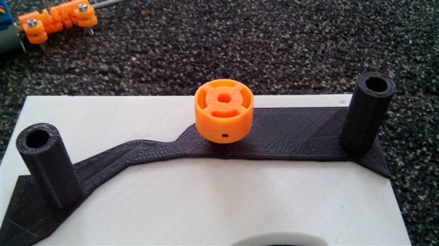

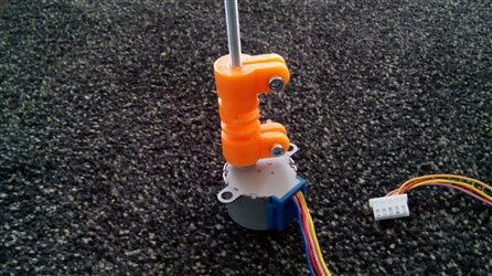

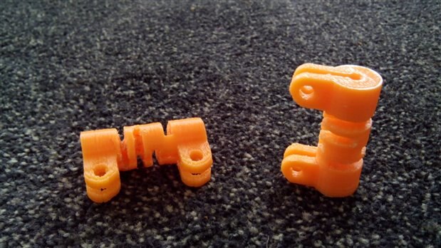

3d printing and assembling the motor joint
Again after some 3D printing tests the joints are printed with PLA, 100% fill and supports. As these parts are small it is needed to use the raft support to keep them in place until the 3D printing finishes. The resulting g-code requires less than 30 minutes printing time.
Stress tests confirmed this part as easy to assemble, robust and flexible.

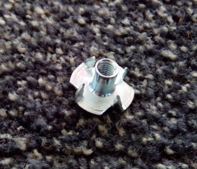

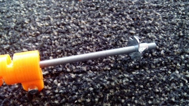

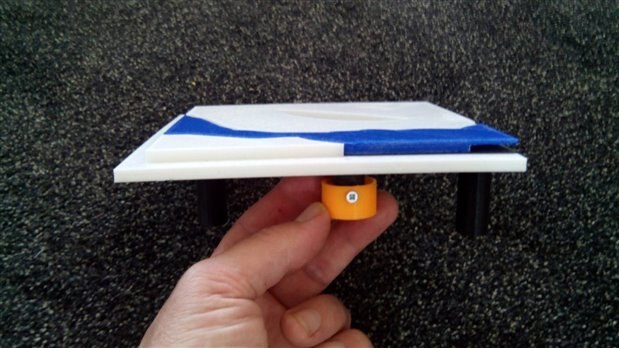

Connecting the threaded bar to the moving parts

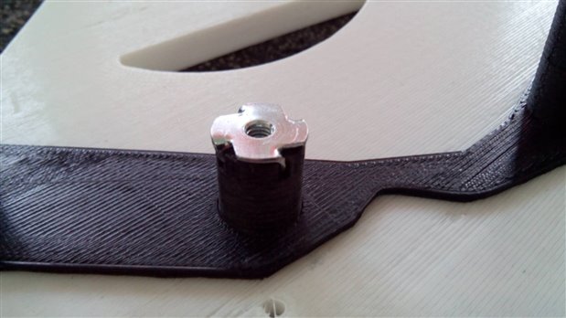

The last step to make any part moving is to connect the M3 threaded bar to the moving part. Also in this case the mechanism is very similar to the 3D printer z-axis movement, as shown in the image below.

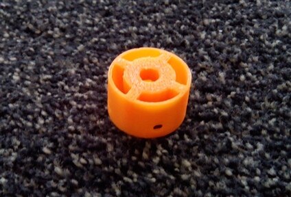

The very first tests have been done with an M3 nut, but it was not sufficient; the threaded pipe of the moving part should be longer than just a couple of mm. The image below shows the adopted component and how it fits in the threaded bar.

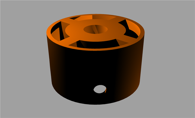

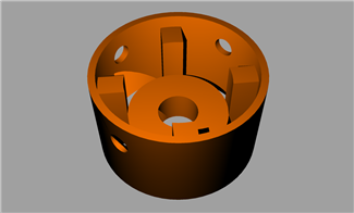

The form factor of this component makes it easy to insert to the end of the moving part axis, but a last problem arises: should be firmly locked, easy to assemble and replace on damage for easy maintenance. So a last 3D printed object has been designed: a lock cap that can be screwed to the moving pipe as shown in the images below.
And this is the resulting 3D printed sample

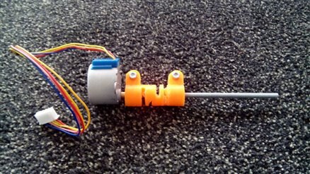

The complete movement assembly
The image gallery below shows the complete movement assembly of the parts.
The threaded pipe set in place
The 3D printed cap in place
The moving part assembled with the threaded pipe to the bottom
The motor connected to the moving part

    I say, IMHO the problem is not the use of the 3D printing technology as well as an alternative choice like the creation of CNC parts. The problem is in the design; when designing mechanical moving parts it is needed to add a sort of extra dimension to the design and missing this moving dimension it is one of the most frequent mistakes I see in the 3D printed projects, also on specialised sites.
    Adopting a technology, the 3D printing in this case, first you should know the issues and the advantages to adapt the design to the  reality. Then moving parts should be designed taking care of the movement as a fourth dimension.
    About just the static aspects of the question please take a look to this link: Cardboard Chair - Danni Design (this is just one of many similar products) To the common user these solution sounds incredible, wonderful wow! A construction engineer instead is not so excited; he knows very well how the structural engineering technologies by years explored the math of these kind of approaches. The "secret" lays in the structure usage: a usually weak material can be spatially organised in a way to build extremely strong objects. The most ancient application of this approach is the egg. Its structure should be extremely robust responding to certain kind of forces and extremely fragile when different forces solicit it. Another great example is just our tibia. This bone can support a vertical load weight of several tons while it breaks with a cross shot of few kilograms. Just because it is not "engineered" for this role.
    In the case of this building I have tried to consider the mechanical aspects and where the forces act on the  system to grant the best reliability with the less use of material. Considering the motor support example - barely copied from the widely diffused Aluminium ones - I have "refactored" the concept trying to adapt to a different material and technology.
    • What is the advantage of the joint ? Supporting few degree of potential misalignment between the motor shaft and the vertical motion transducer threaded bar.
    • Is PLA sufficiently flexible ? Yes but the the horizontal cuts should be deeper and the thickness should be wider (2 mm) due to the difficult removing the support after printing.
    • Where are the most heavy forces applied ? Sounds obvious that are the rotational torsion: with a good balance between the right acceleration curve of the stepper motor when it starts and the material fill percentage torsion is very well supported.
    This and all the other factors that should be considered for a complex structure like this are essential to be considered in the design phase, avoiding a lot of experimental tests that not always grant to reach the best solution.
