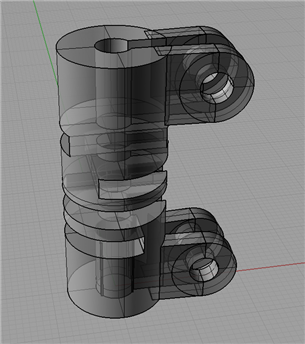

The motor joint design

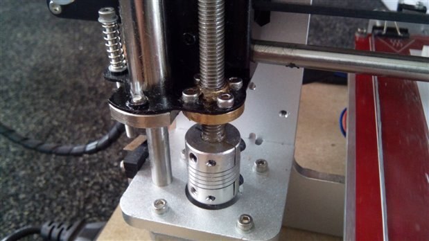

The threaded vertical shaft of the transducer is coaxial to the stepper axis shaft and needs a flexible joint: its role is to fix firmly the two aligned components and give a minimum of flexibility to prevent excessive mechanical stress.
A motor joint used in many 3D printers z-axis movementimage
Due to the large number of joints needed for this project - the complete set of moving parts involves about 100 of them - it was worth to design a custom one with some structural changes to make it printable.
The images below show the rendered CAD model
The same principle of the analog Aluminium component has been kept: robust and flexible able to lock the two coaxial components.
The following semitransparent images show how the internal part is designed; the stepper motor shaft has a different diameter than the M3 threaded bar used for the vertical movement.
3d printing and assembling the motor joint
Again after some 3D printing tests the joints are printed with PLA, 100% fill and supports. As these parts are small it is needed to use the raft support to keep them in place until the 3D printing finishes. The resulting g-code requires less than 30 minutes printing time.
Stress tests confirmed this part as easy to assemble, robust and flexible.

    • What is the advantage of the joint ? Supporting few degree of potential misalignment between the motor shaft and the vertical motion transducer threaded bar.
    • Is PLA sufficiently flexible ? Yes but the the horizontal cuts should be deeper and the thickness should be wider (2 mm) due to the difficult removing the support after printing.
    • Where are the most heavy forces applied ? Sounds obvious that are the rotational torsion: with a good balance between the right acceleration curve of the stepper motor when it starts and the material fill percentage torsion is very well supported.
    This and all the other factors that should be considered for a complex structure like this are essential to be considered in the design phase, avoiding a lot of experimental tests that not always grant to reach the best solution.
