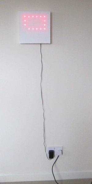

Here it is on the wall of my workroom.
The following video shows it working. The 'space' moves to a new, random position and always takes the long way round - hence the
title.

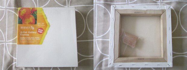

I decided that I wanted to use canvases for at least some of the pieces. Some of the later slices will also involve paint, though for
some reason the first one has ended up being more spare and conceptual. Conveniently, I've got a few spare canvases that I bought
years ago and never used for anything. Here is what the small one that I've chosen looks like back and front in the packaging (the
wooden pieces in the plastic bag are wedges that allow the canvas to be tensioned). This one is 10" x 10" (25cm x 25cm) which is quite
small but felt about right given the small size of the PI and the diameter of the pixels and the somewhat sparse and minimalist
general feel of the thing.

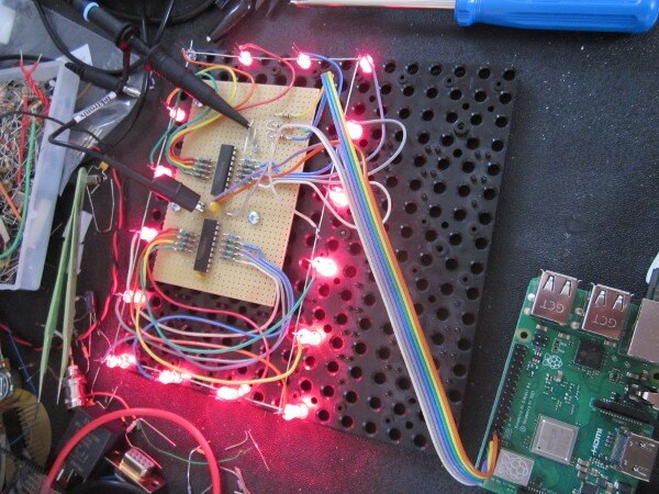

pixel on the surface. The red light is a bit of a cliche with LEDs, but never mind. Here's a picture of the LED support and the driver
electronics in more detail from when I was testing it on the bench.

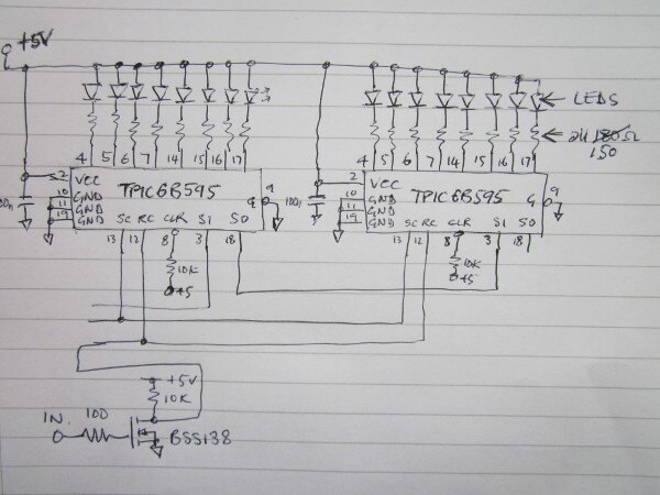

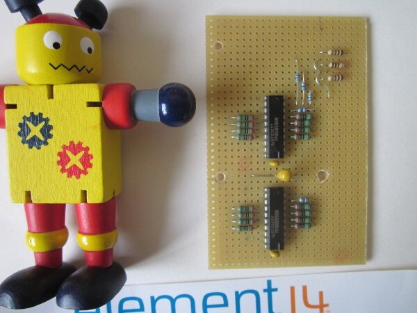

The Pi has enough GPIO lines to drive all 16 LEDs directly but I wasn't very sure about powering them from the 3.3V supply generated
on the board so I used a couple of shift register ICs (TPIC6B595) as drivers running on the 5V supply that comes from the power input.
That meant I needed level conversion from the 3.3V GPIO pins, but it's only three lines - clock, data, and latch - so it wasn't too
difficult to do. I used three BSS138 MOSFETs for that.
Here's the circuit diagram. I've only showed one of the level converters, but the other two are the same. They invert, so the code
driving the pins has the levels swapped. The pull-up was a bit on the high side and so the rising edge is a bit slow but the shift
registers don't seem to mind.

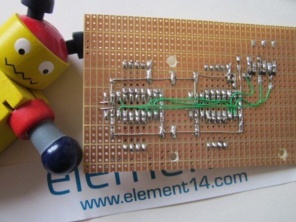

Here's a top and bottom view of the circuit board. The MOSFETs are the SOT23 packages [the black blobs] on the righthand side of the
bottom view. The wiring is done with wire-wrap wire.

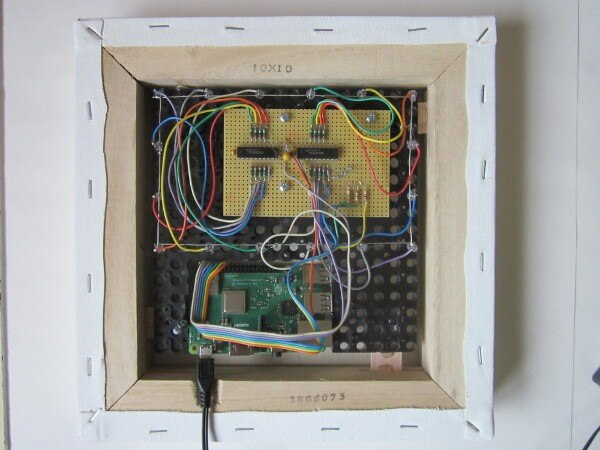

Here it is wired to the LEDs behind the canvas - not very tidy, but that doesn't matter too much for something like this.

The whole thing didn't quite turn out how I imagined it in my head - art rarely seems to - but it will do for the challenge and gets
me off to a reasonably quick start. Originally, I was going to have the Pi on the front, but partway through changed my mind and
tucked it in behind the canvas.
