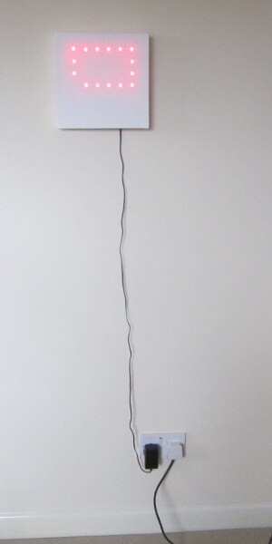

The Work
Here it is on the wall of my workroom.

Now to start work on Slice 2. I have rough ideas for all nine now, the next two are planned in detail and underway, so hopefully I can
catch up a bit with the one-a-week schedule.
    dubbie over 7 years ago +5
    Jon, I really like this first canvas. It is just the type of art I like. Simple and sparse, but with interest. A pity it needs a lead to the power supply. I look forward to seeing the remaining 8 slices…
