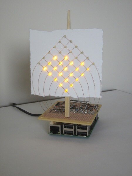

Another piece involving LEDs. This time I chose some small SOT23 amber ones.
The Work
Here it is on a small table in my workroom.
The following video shows it working.
At the start I was going to have it as another canvas on the wall but, as it gradually developed, it went through
a phase where I was going to have the grid of LEDs sitting in a preservative jar, but I didn't entirely like that
either so it finally ended up as this free-standing kind of 'ship' idea. That's art for you!
The rolling flicker, that you see partway through the video, isn't apparent in real life. The matrix is scanned and
is interacting with the electronic shutter of the camera's video sensor. Unfortunately, the video also makes the
LEDs look very much brighter than they appear to the eye.

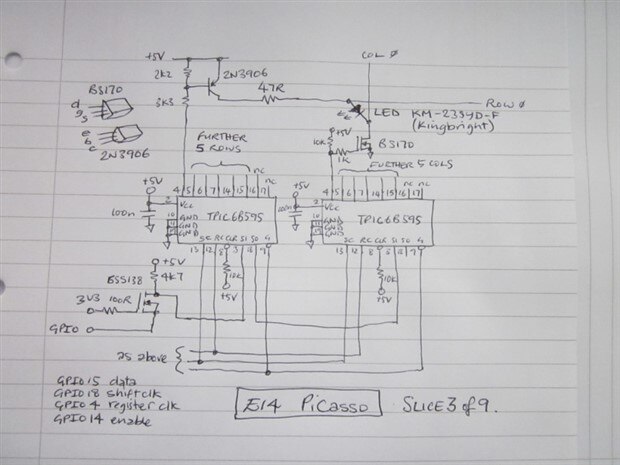

Here's the circuit diagram.
The circuit is a bit messy (too many components) and could be greatly simplified. When I started this challenge
I decided I'd try and recycle old parts I've got lying around, rather than just keep buying new stuff, but it does
mean that some of this design is getting a bit convoluted. The shift registers keep appearing because I have
several tubes of them (they were originally excess parts for products manufactured about 25 years ago that
were kept as spares and which I later rescued from going into an electrical-waste skip. I looked them up on
TI's website and, amazingly, they still make them; probably because they had an automotive use).

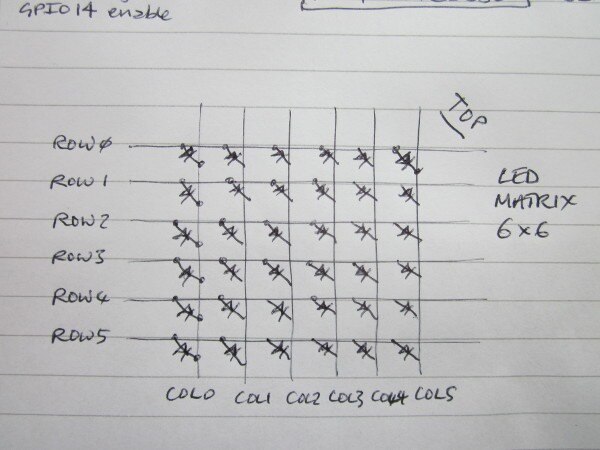

Rather than try and drive 36 LEDs using GPIO lines, the LEDs are arranged in a 6x6 matrix, with 6 columns
and 6 rows. The drivers to those rows and columns are, in turn, controlled by shift register outputs, thus
reducing the GPIO count to four. I'm going to have a 1:6 multiplex on the columns and present the data on
the rows. When I experimented with a single LED I found I needed about 10mA to get the illumination I wanted
for a reasonable 'dot' on the paper. That means the row drive will need to work at something like 60mA
[in order to average 10mA] and the column drive will need to cope with up to 360mA [if all 6 LEDs are on].
Because I didn't have a good option handy for driving the 360mA if I put it on the high side, and the shift
register isn't quite rated for doing it if I did it on the low side, I decided to put BS170 MOSFETs on the low
side for the 360mA and 2N3906 transistors on the high side for the row drive since I have plenty of both.
For the level-conversion up from the Pi's 3.3V GPIO pins to the shift register 5V CMOS inputs, this time
around I experimented with using BSS138 MOSFETs in a common-gate configuration (similar to a
cascode-type arrangement) where the MOSFET shields the Pi from the 5V. The BSS138 parts are in a
surface-mount SOT23 package but they're very easy to work with and there's no problem soldering them
with an ordinary soldering iron. [Although it worked adequately for the piece, the output waveforms aren't
ideal. They stall momentarily around the 3V point.]

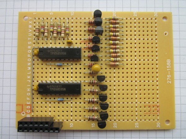

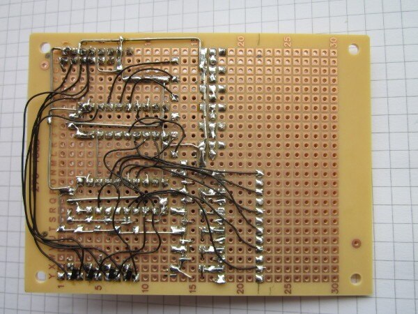

Here's the interface board as I've built it on a small prototyping board with the wiring done with wire-wrap
wire soldered to the pads.

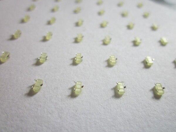

For the display part, I super-glued the LEDs down to a piece of fairly heavy cartridge paper. They actually
face down towards the paper, so the pixel is formed by the light that gets reflected back up through the
body and what spills out the sides. Visually, it was much more comfortable to look at than having the very
bright dot of light from the die directly visible.
Here they are, glued to the paper, before the wiring was done.
The paper was then glued to part of a chop-stick, which acts as the mast, and strands of wire from a stranded
cable were used to wire the matrix to the drive parts on the circuit board.
