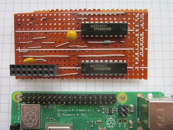

I found an old pair of very cheap shoes that I'd bought a long time ago, worn once, and then decided
that my feet deserved better. Now I'm recycling them into a piece of sculpture. First job was to cut
holes in the soles. It wasn't too difficult - they're just a combination of soft and hard rubbery
material. Not particularly neat but then it doesn't show being underneath.
I then cut pieces of perforated circuit board to fit each shoe and wired up the LEDs.
The drive electronics of this is more or less identical to the first piece (The Long Way Round), again
with shift registers driving LEDs. This time, though, I'm using strings of LEDs to get the individual
bars and that necessitates a much higher LED voltage than the +5V from the Pi board. Having to have
the extra supply doesn't really detract from the look of the work because I can hide the power supply
under the table, or inside the plinth, once I build it.
Here are some pictures of the LED boards, the interface board, and finally the whole thing being
tested on the workbench.
The code is more complicated than it needed to be. I originally intended to feed a new (random) data
value into the shift registers on each step but, unfortunately, I wired the LEDs to the shift
registers in reverse order so, rather than bother to rewire them, I simply simulated the shift
register in the code and read out all 16 values each time.

Randomly driving the shift-register gives something reminiscent of a barcode flowing beneath the
shoes. A mesmerising flow of 'data' disappearing off into the past. The code part of this is so
trivial it could easily be made to work with a 50p microcontroller, which is probably how I'll adapt
the piece once I'm finished.
