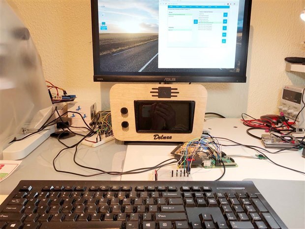

Developing on the project hardware has become difficult since the enclosure was completed since pins, the SD card, and such are now difficult to access.  Accordingly Pi Presents development was done on a separate Raspberry Pi as seen just behind the keyboard and in front of the project enclosure in the photo below.

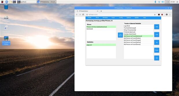

A breadboard and jumpers were used to simulate input from the Pi running the face recognition software and display was done on the large monitor in the background.  The most difficult part of setting up the software was understanding and setting up GPIO pins.  The screenshot below shows the web based editor after opening and selecting the presentation (in this case my PiCasso presentation, already working).

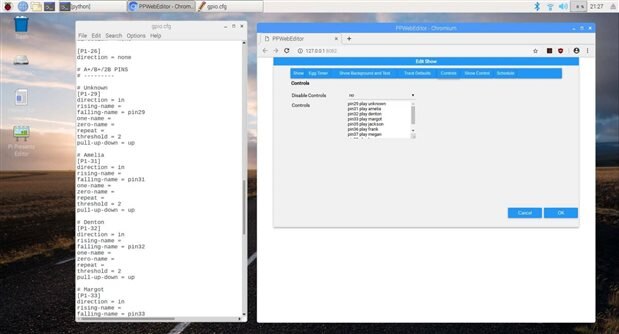

The window on the right side of the editor contains the "tracks" that will be played.  They are stored in a media directory and selected easily using the web based editor.  To enable playing them it is necessary to edit the controls in the "show" which is located in the upper left corner.  The control edit panel when opened is shown below.
Also shown on the left of the screen shot is a file that contains pin configuration which must be done in a text editor and placed in a named folder in the correct location.
Pi Presents is powerful and I recommend it with the proviso that it is not a refined product like for example PowerPoint.  Expect to spend some time reading the manual and studying examples while figuring out the quirks as you learn to use it.
